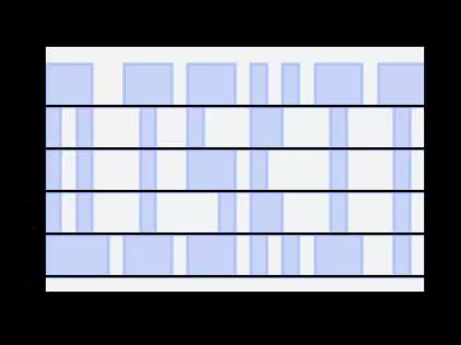

The pulse builder provides an imperative API for writing pulse programs with less difficulty than the Schedule API. It contextually constructs a pulse schedule and then emits the schedule for execution. For example to play a series of pulses on channels is as simple as:
from qiskit import pulse
from qiskit.visualization import SchedStyle
dc = pulse.DriveChannel
d0, d1, d2, d3, d4 = dc(0), dc(1), dc(2), dc(3), dc(4)
with pulse.build(name='pulse_programming_in') as pulse_prog:
    pulse.play([1, 1, 1, 0, 0, 1, 1, 1, 0, 1, 1, 1, 0, 1, 0, 1, 0, 1, 1, 1, 0, 1, 1, 1], d0)
    pulse.play([1, 0, 1, 0, 0, 0, 1, 0, 0, 1, 0, 0, 0, 1, 1, 0, 0, 0, 1, 0, 0, 0, 1, 0], d1)
    pulse.play([1, 0, 1, 0, 0, 0, 1, 0, 0, 1, 1, 1, 0, 1, 0, 0, 0, 0, 1, 0, 0, 0, 1, 0], d2)
    pulse.play([1, 0, 1, 0, 0, 0, 1, 0, 0, 0, 0, 1, 0, 1, 1, 0, 0, 0, 1, 0, 0, 0, 1, 0], d3)
    pulse.play([1, 1, 1, 1, 0, 1, 1, 1, 0, 1, 1, 1, 0, 1, 0, 1, 0, 1, 1, 1, 0, 0, 1, 0], d4)
style = SchedStyle(figsize=(3, 2), title_font_size=10, axis_font_size=8)
pulse_prog.draw(style=style)
../_images/pulse_0_0.png

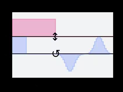

Pulse instructions are available within the builder interface. Here’s an example:
from qiskit.test.mock import FakeArmonk
backend = FakeArmonk()
with pulse.build(backend) as drive_sched:
    d0 = pulse.drive_channel(0)
    a0 = pulse.acquire_channel(0)
    pulse.play(pulse.library.Constant(10, 1.0), d0)
    pulse.delay(20, d0)
    pulse.shift_phase(3.14/2, d0)
    pulse.set_phase(3.14, d0)
    pulse.shift_frequency(1e7, d0)
    pulse.set_frequency(5e9, d0)
    with pulse.build() as temp_sched:
        pulse.play(pulse.library.Gaussian(20, 1.0, 3.0), d0)
        pulse.play(pulse.library.Gaussian(20, -1.0, 3.0), d0)
    pulse.call(temp_sched)
    pulse.acquire(30, a0, pulse.MemorySlot(0))
drive_sched.draw(style=style)
../_images/pulse_2_0.png

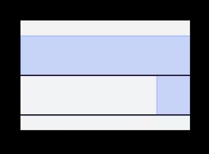

Builder aware contexts that modify the construction of a pulse program. For example an alignment context like align_right() may be used to align all pulses as late as possible in a pulse program.
d0 = pulse.DriveChannel(0)
d1 = pulse.DriveChannel(1)
with pulse.build() as pulse_prog:
    with pulse.align_right():
        # this pulse will start at t=0
        pulse.play(pulse.Constant(100, 1.0), d0)
        # this pulse will start at t=80
        pulse.play(pulse.Constant(20, 1.0), d1)
../_images/pulse_3_0.png
