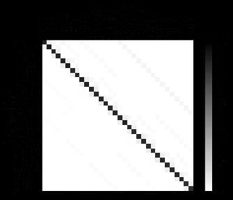

# Plot fitted N-qubit assignment matrix
mitigator.plot_assignment_matrix()
<matplotlib.axes._subplots.AxesSubplot at 0x7f9f1fac6bd0>
../_images/qiskit.ignis.mitigation.expval_meas_mitigator_circuits_0_1.png

Expval (no mitigation): -0.66 ± 0.01
Expval (with mitigation): -1.01 ± 0.01
