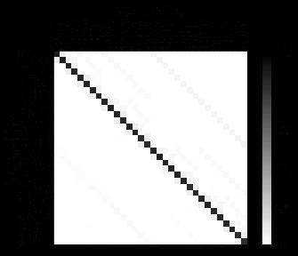

# Plot fitted N-qubit assignment matrix
mitigator.plot_assignment_matrix()
<matplotlib.axes._subplots.AxesSubplot at 0x7ff591253e10>
../_images/qiskit.ignis.mitigation.expval_meas_mitigator_circuits_0_1.png
