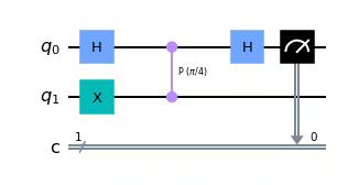

Every quantum circuit run on an IBM Q device must be expressed using only these basis gates. For example, suppose one wants to run a simple phase estimation circuit:
import numpy as np
qc = QuantumCircuit(2, 1)
qc.h(0)
qc.x(1)
qc.cp(np.pi/4, 0, 1)
qc.h(0)
qc.measure([0], [0])
qc.draw(output='mpl')
../_images/transpiler_2_0.png
We have HH, XX, and controlled-PP gates, all of which are not in our devices basis gate set, and must be expanded. This expansion is taken care of for us in the qiskit.execute() function. However, we can decompose the circuit to show what it would look like in the native gate set of the IBM Quantum devices:

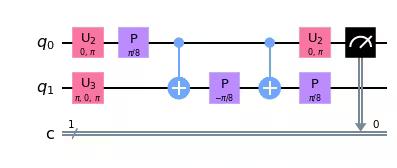

qc_basis = qc.decompose()
qc_basis.draw(output='mpl')
../_images/transpiler_3_0.png
A few things to highlight. First, the circuit has gotten longer with respect to the initial one. This can be verified by checking the depth of the circuits:
print('Original depth:', qc.depth(), 'Decomposed Depth:', qc_basis.depth())
Original depth: 4 Decomposed Depth: 7
Second, although we had a single controlled gate, the fact that it was not in the basis set means that, when expanded, it requires more than a single cx gate to implement. All said, unrolling to the basis set of gates leads to an increase in the depth of a quantum circuit and the number of gates.

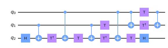

  2. A Toffoli, or controlled-controlled-not gate (ccx), is a three-qubit gate. Given that our basis gate set includes only single- and two-qubit gates, it is obvious that this gate must be decomposed. This decomposition is quite costly:
    ccx_circ = QuantumCircuit(3)
    ccx_circ.ccx(0, 1, 2)
    ccx_circ.decompose().draw(output='mpl')
    ../_images/transpiler_6_0.png
    For every Toffoli gate in a quantum circuit, the IBM Quantum hardware may execute up to six CNOT gates, and a handful of single-qubit gates. From this example, it should be clear that any algorithm that makes use of multiple Toffoli gates will end up as a circuit with large depth and will therefore be appreciably affected by noise and gate errors.

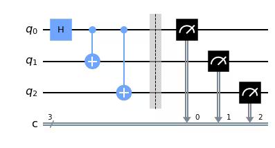

ghz = QuantumCircuit(3, 3)
ghz.h(0)
ghz.cx(0,range(1,3))
ghz.barrier()
ghz.measure(range(3), range(3))
ghz.draw(output='mpl')
../_images/transpiler_7_0.png

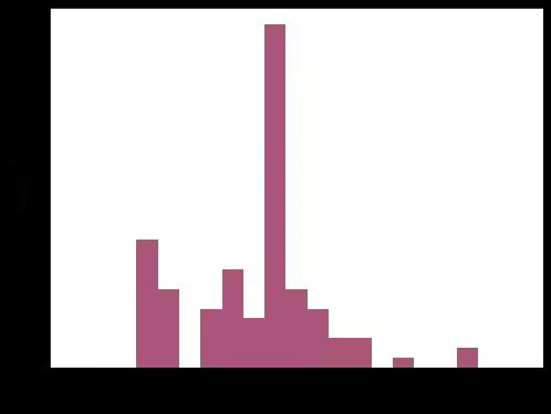

In order to highlight this, we run a GHZ circuit 100 times, using a “bad” (disconnected) initial_layout:

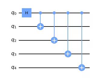

ghz = QuantumCircuit(5)
ghz.h(0)
ghz.cx(0,range(1,5))

depths = []
for _ in range(100):
   depths.append(transpile(ghz,
                           backend,
                           initial_layout=[7, 0, 4, 15, 19],
                          ).depth())
plt.figure(figsize=(8, 6))
plt.hist(depths, bins=list(range(14,36)), align='left', color='#AC557C')
plt.xlabel('Depth', fontsize=14)
plt.ylabel('Counts', fontsize=14);
../_images/transpiler_12_0.png
This distribution is quite wide, signaling the difficultly the SWAP mapper is having in computing the best mapping. Most circuits will have a distribution of depths, perhaps not as wide as this one, due to the stochastic nature of the default SWAP mapper. Of course, we want the best circuit we can get, especially in cases where the depth is critical to success or failure. In cases like this, it is best to transpile() a circuit several times, e.g. 10, and take the one with the lowest depth. The transpile() function will automatically run in parallel mode, making this procedure relatively speedy in most cases.
ghz.h(0)
../_images/transpiler_13_0.png
for kk in range(4):
   circ = transpile(ghz, backend, optimization_level=kk)
   print('Optimization Level {}'.format(kk))
   print('Depth:', circ.depth())
   print('Gate counts:', circ.count_ops())
   print()
Optimization Level 0
Depth: 14
Gate counts: OrderedDict([('cx', 13), ('u2', 1)])
Optimization Level 1
Depth: 12
Gate counts: OrderedDict([('cx', 20), ('u2', 1)])
Optimization Level 2
Depth: 12
Optimization Level 3
Depth: 11
Gate counts: OrderedDict([('cx', 10), ('u2', 1)])
