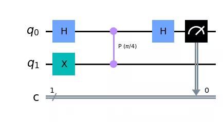

import numpy as np
qc = QuantumCircuit(2, 1)
qc.h(0)
qc.x(1)
qc.cp(np.pi/4, 0, 1)
qc.h(0)
qc.measure([0], [0])
qc.draw(output='mpl')
../_images/transpiler_2_0.png
We have HH, XX, and controlled-PP gates, all of which are not in our devices basis gate set, and must be expanded. This expansion is taken care of for us in the qiskit.execute() function. However, we can decompose the circuit to show what it would look like in the native gate set of the IBM Quantum devices:

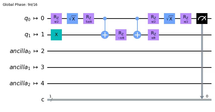

A few things to highlight. First, the circuit has gotten longer with respect to the initial one. This can be verified by checking the depth of the circuits:
print('Original depth:', qc.depth(), 'Decomposed Depth:', qc_basis.depth())
Original depth: 4 Decomposed Depth: 10
Second, although we had a single controlled gate, the fact that it was not in the basis set means that, when expanded, it requires more than a single cx gate to implement. All said, unrolling to the basis set of gates leads to an increase in the depth of a quantum circuit and the number of gates.

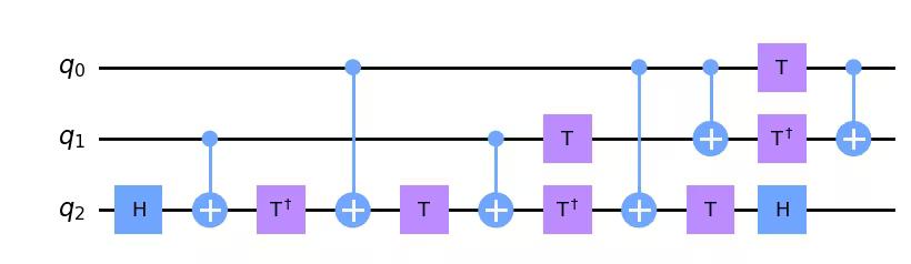

  2. A Toffoli, or controlled-controlled-not gate (ccx), is a three-qubit gate. Given that our basis gate set includes only single- and two-qubit gates, it is obvious that this gate must be decomposed. This decomposition is quite costly:
    ccx_circ = QuantumCircuit(3)
    ccx_circ.ccx(0, 1, 2)
    ccx_circ.decompose().draw(output='mpl')
    ../_images/transpiler_6_0.png
    For every Toffoli gate in a quantum circuit, the IBM Quantum hardware may execute up to six CNOT gates, and a handful of single-qubit gates. From this example, it should be clear that any algorithm that makes use of multiple Toffoli gates will end up as a circuit with large depth and will therefore be appreciably affected by noise and gate errors.

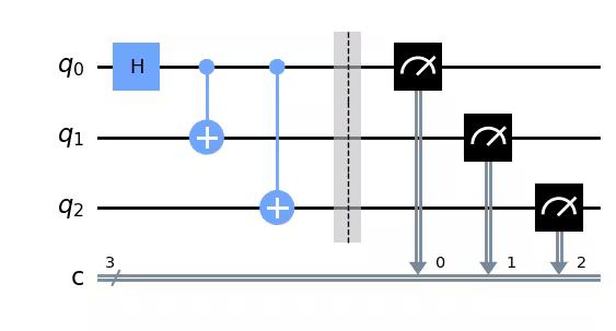

ghz = QuantumCircuit(3, 3)
ghz.h(0)
ghz.cx(0,range(1,3))
ghz.barrier()
ghz.measure(range(3), range(3))
ghz.draw(output='mpl')
../_images/transpiler_7_0.png

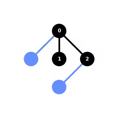

  • Layout Using Optimization Level 0
    new_circ_lv0 = transpile(ghz, backend=backend, optimization_level=0)
    plot_circuit_layout(new_circ_lv0, backend)

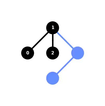

  • Layout Using Optimization Level 3
    new_circ_lv3 = transpile(ghz, backend=backend, optimization_level=3)
    plot_circuit_layout(new_circ_lv3, backend)
    ../_images/transpiler_9_0.png

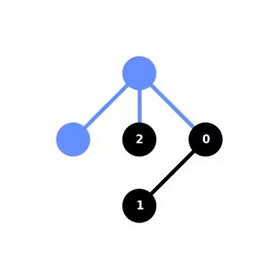

It is completely possible to specify your own initial layout. To do so we can pass a list of integers to qiskit.compiler.transpile() via the initial_layout keyword argument, where the index labels the virtual qubit in the circuit and the corresponding value is the label for the physical qubit to map onto:
# Virtual -> physical
#    0    ->    3
#    1    ->    4
#    2    ->    2
my_ghz = transpile(ghz, backend, initial_layout=[3, 4, 2])
plot_circuit_layout(my_ghz, backend)
../_images/transpiler_10_0.png

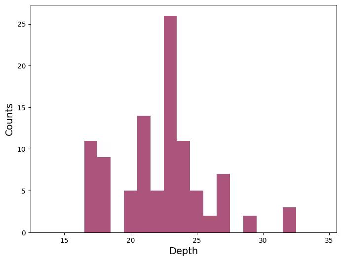

In order to highlight this, we run a GHZ circuit 100 times, using a “bad” (disconnected) initial_layout:

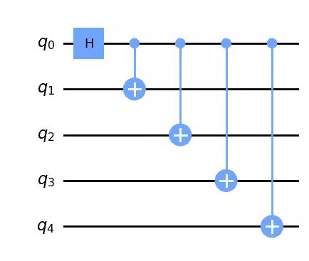

ghz = QuantumCircuit(5)
ghz.h(0)
ghz.cx(0,range(1,5))
../_images/transpiler_11_0.png
depths = []
for _ in range(100):
   depths.append(transpile(ghz,
                           backend,
                           initial_layout=[7, 0, 4, 15, 19],
                          ).depth())
plt.figure(figsize=(8, 6))
plt.hist(depths, bins=list(range(14,36)), align='left', color='#AC557C')
plt.xlabel('Depth', fontsize=14)
plt.ylabel('Counts', fontsize=14);
../_images/transpiler_12_0.png
This distribution is quite wide, signaling the difficultly the SWAP mapper is having in computing the best mapping. Most circuits will have a distribution of depths, perhaps not as wide as this one, due to the stochastic nature of the default SWAP mapper. Of course, we want the best circuit we can get, especially in cases where the depth is critical to success or failure. In cases like this, it is best to transpile() a circuit several times, e.g. 10, and take the one with the lowest depth. The transpile() function will automatically run in parallel mode, making this procedure relatively speedy in most cases.

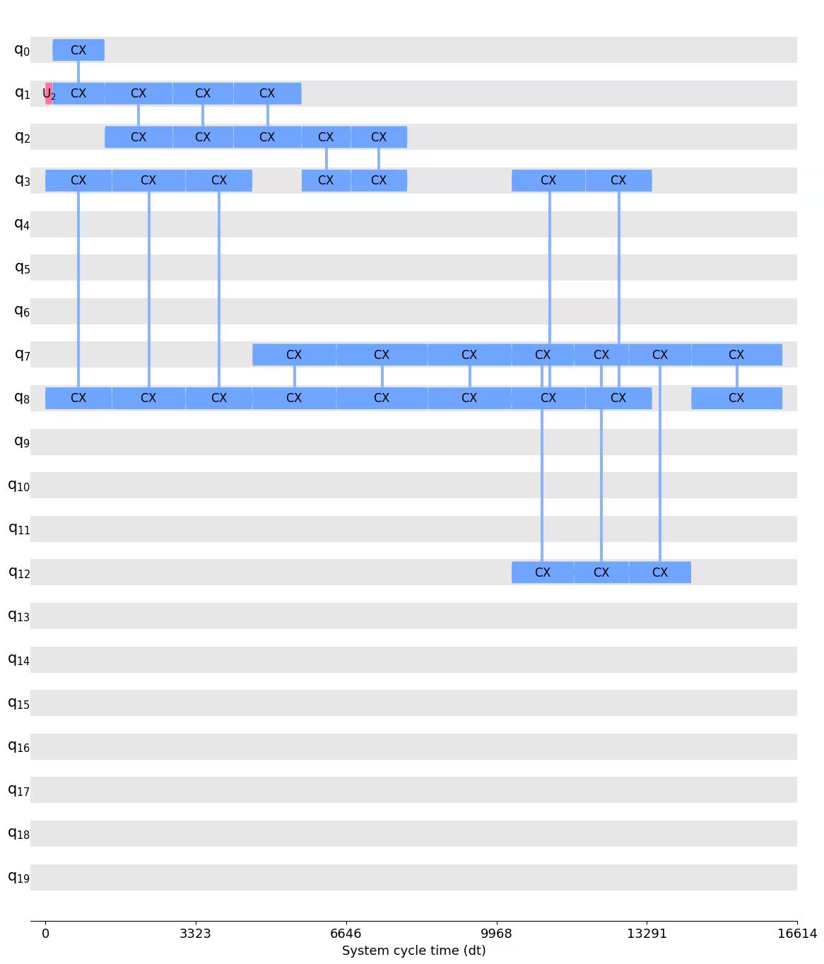

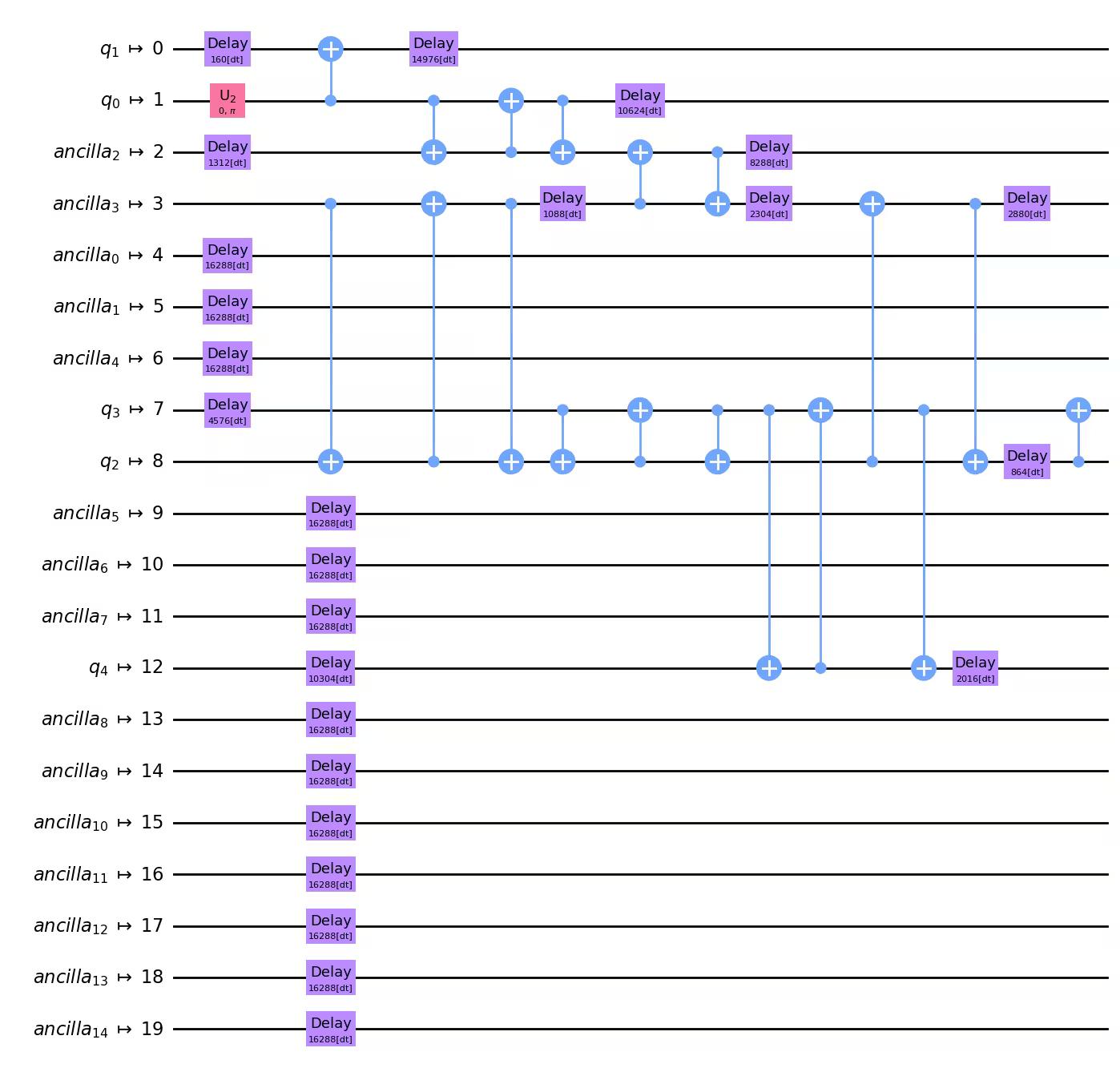

You can see here that the transpiler inserted Delay instructions to account for idle time on each qubit. To get a better idea of the timing of the circuit we can also look at it with the timeline.draw() function:
from qiskit.visualization.timeline import draw as timeline_draw
timeline_draw(circ)
../_images/transpiler_17_0.png

scheduling_pm = PassManager([
    ALAPScheduleAnalysis(backend_durations),
    PadDynamicalDecoupling(backend_durations, dd_sequence),
inverse_gate_list = [
    HGate(),
    (RXGate(np.pi / 4), RXGate(-np.pi / 4)),
    (PhaseGate(np.pi / 4), PhaseGate(-np.pi / 4)),
    (TGate(), TdgGate()),
logical_opt = PassManager([
    CXCancellation(),
    InverseCancellation([HGate(), (RXGate(np.pi / 4), RXGate(-np.pi / 4))
# Add pre-layout stage to run extra logical optimization
pass_manager.pre_layout = logical_opt
# Set scheduling stage to custom pass manager
pass_manager.scheduling = scheduling_pm
