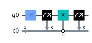

Now, we add an XGate only if the value of the ClassicalRegister is 0. That way, if the state is 0|0\rangle, it will be changed to 1|1\rangle and if the state is 1|1\rangle, it will not be changed at all, so the final state will always be 1|1\rangle.
qc.x(0).c_if(cr, 0)
qc.measure(0, 0)
qc.draw('mpl')
../_images/circuit_3_0.png
tqc = transpile(qc, backend)
counts = backend.run(tqc).result().get_counts()
print(counts)
{'1': 1024}

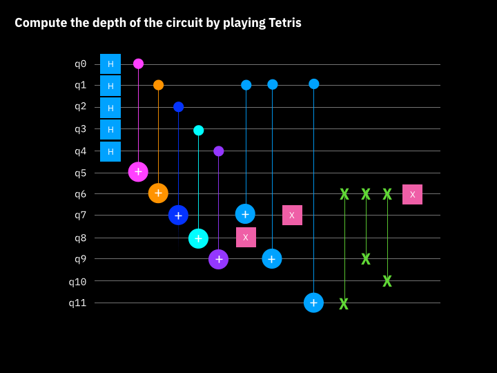

A particularly important circuit property is known as the circuit depth. The depth of a quantum circuit is a measure of how many “layers” of quantum gates, executed in parallel, it takes to complete the computation defined by the circuit. Because quantum gates take time to implement, the depth of a circuit roughly corresponds to the amount of time it takes the quantum computer to execute the circuit. Thus, the depth of a circuit is one important quantity used to measure if a quantum circuit can be run on a device.
The depth of a quantum circuit has a mathematical definition as the longest path in a directed acyclic graph (DAG). However, such a definition is a bit hard to grasp, even for experts. Fortunately, the depth of a circuit can be easily understood by anyone familiar with playing Tetris. Lets see how to compute this graphically:
../_images/depth.gif
We can verify our graphical result using QuantumCircuit.depth():
qc.depth()
9
