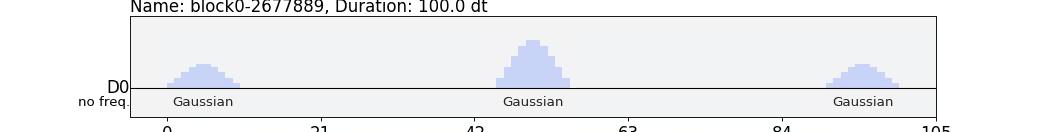

This context is convenient to write a schedule for periodical dynamic decoupling or the Hahn echo sequence.
Examples:
from qiskit import pulse
d0 = pulse.DriveChannel(0)
x90 = pulse.Gaussian(10, 0.1, 3)
x180 = pulse.Gaussian(10, 0.2, 3)
with pulse.build() as hahn_echo:
with pulse.align_equispaced(duration=100):
pulse.play(x90, d0)
pulse.play(x180, d0)
pulse.play(x90, d0)
hahn_echo.draw()
