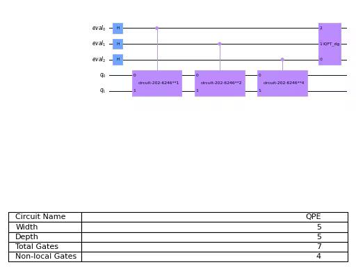

Reference Circuit:
../_images/qiskit-circuit-library-PhaseEstimation-1.png
