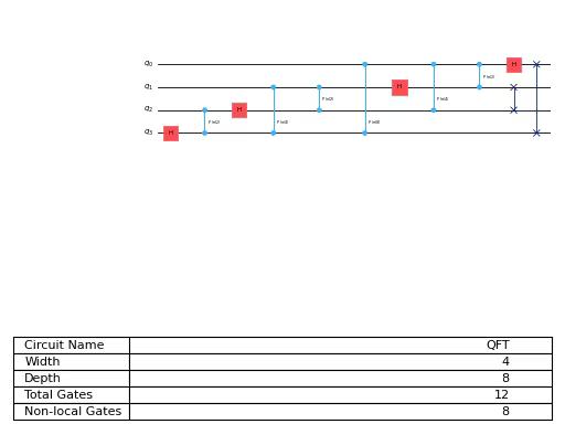

The circuit that implements this transformation can be implemented using Hadamard gates on each qubit, a series of controlled-U1 (or Z, depending on the phase) gates and a layer of Swap gates. The layer of Swap gates can in principle be dropped if the QFT appears at the end of the circuit, since then the re-ordering can be done classically. They can be turned off using the do_swaps attribute.
For 4 qubits, the circuit that implements this transformation is:
Diagram illustrating the previously described circuit.

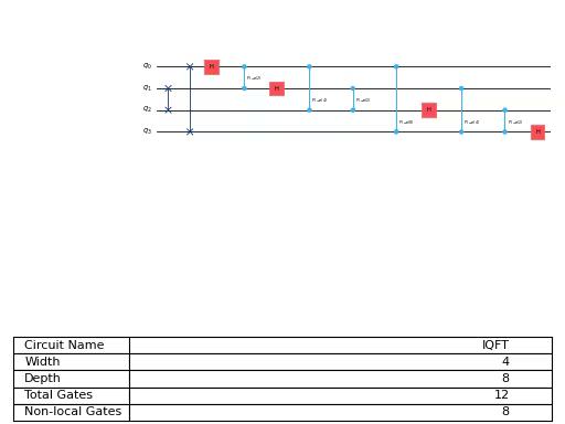

The inverse QFT can be obtained by calling the inverse method on this class. The respective circuit diagram is:

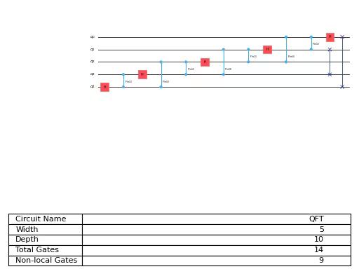

Here, this can be adjusted using the approximation_degree attribute: the smallest approximation_degree rotation angles are dropped from the QFT. For instance, a QFT on 5 qubits with approximation degree 2 yields (the barriers are dropped in this example):
