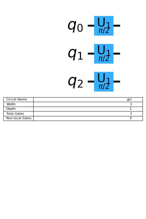

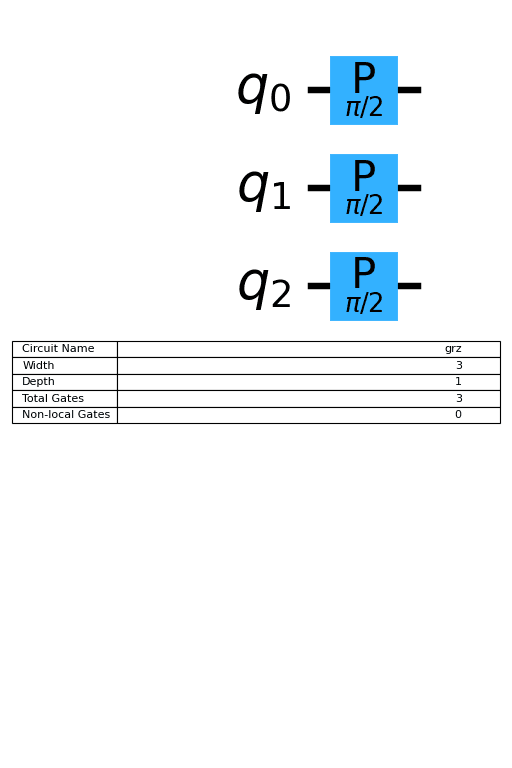

Circuit symbol:
q_0: ┤0 ├
q_1: ┤1 GRZ(φ) ├
q_2: ┤2 ├
The global RZ gate is native to atomic systems (ion traps, cold neutrals). The global RZ can be applied to multiple qubits simultaneously.
In the one-qubit case, this is equivalent to an RZ(phi) operation, and is thus reduced to the RZGate. The global RZ gate is a direct sum of RZ operations on all individual qubits.
Expanded Circuit:
Create a new Global RZ (GRZ) gate.
