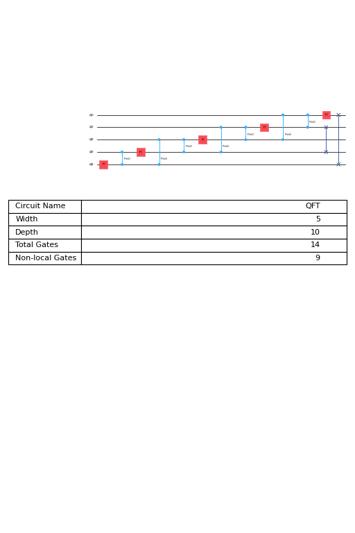

Quantum Fourier Transform Circuit.
The Quantum Fourier Transform (QFT) on nn qubits is the operation
j12n/2k=02n1e2πijk/2nk|j\rangle \mapsto \frac{1}{2^{n/2}} \sum_{k=0}^{2^n - 1} e^{2\pi ijk / 2^n} |k\rangle
The circuit that implements this transformation can be implemented using Hadamard gates on each qubit, a series of controlled-U1 (or Z, depending on the phase) gates and a layer of Swap gates. The layer of Swap gates can in principle be dropped if the QFT appears at the end of the circuit, since then the re-ordering can be done classically. They can be turned off using the do_swaps attribute.
For 4 qubits, the circuit that implements this transformation is:

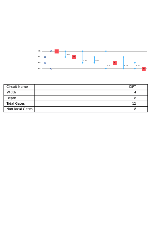

The inverse QFT can be obtained by calling the inverse method on this class. The respective circuit diagram is:
Diagram illustrating the previously described circuit.
