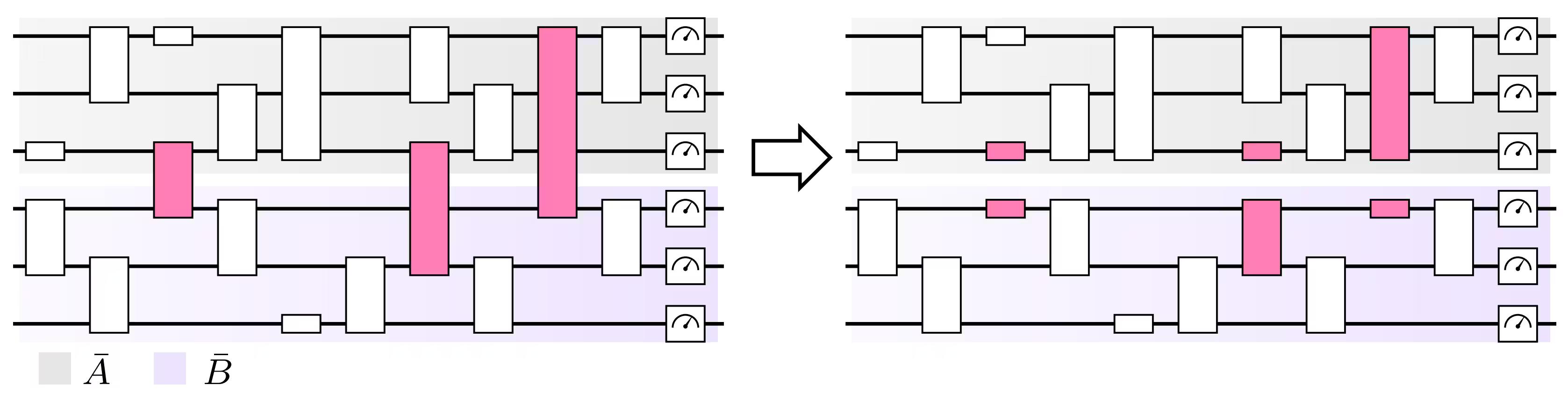

In the circuit cutting process, there are two types of cuts: a gate or "space-like" cut, where a cut goes through a gate operating on two (or more) qubits, and a wire or "time-like" cut, which cuts directly through a qubit wire (essentially a single-qubit identity gate that has been cut into two pieces).
The diagram below depicts an example of cutting gates so that the circuit can be split into two smaller pieces with fewer qubits.
Diagram of gate cutting by taking one larger circuit and cutting it into two smaller ones labeled "A" and "B"
There are three scenarios to consider when preparing a circuit cutting workflow, which center around the availability of classical communication between the circuit executions. The first is where only local operations (LO) are available, while the other two introduce classical communication between executions known as local operations and classical communication (LOCC). The LOCC scenarios are then grouped into either near-time, one-directional communication between circuit executions, or real-time, bi-directional communication (which you might see in a multi-QPU environment).
