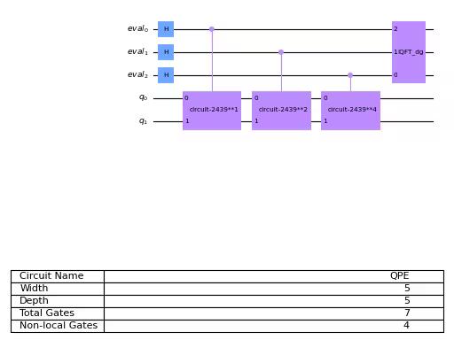

Phase Estimation circuit.
In the Quantum Phase Estimation (QPE) algorithm [1, 2, 3], the Phase Estimation circuit is used to estimate the phase ϕ\phi of an eigenvalue e2πiϕe^{2\pi i\phi} of a unitary operator UU, provided with the corresponding eigenstate psi|psi\rangle. That is
Uψ=e2πiϕψU|\psi\rangle = e^{2\pi i\phi} |\psi\rangle
This estimation (and thereby this circuit) is a central routine to several well-known algorithms, such as Shor’s algorithm or Quantum Amplitude Estimation.

Reference Circuit:
../_images/qiskit-circuit-library-PhaseEstimation-1.png
