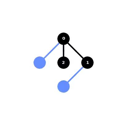

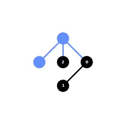

There are also specific data structures to represent a specific subset of information from the Target. For example, the CouplingMap class is used to solely represent the connectivity constraints of a backend as a directed graph. A coupling map can be generated from a Target using the Target.build_coupling_map() method. These data structures typically pre-date the Target class but are still used by some transpiler passes that do not work natively with a Target instance yet or when dealing with backends that aren’t using the latest BackendV2 interface.
For example, if we wanted to visualize the CouplingMap for the example 3 qubit Target above:
from qiskit.circuit import Parameter, Measure
from qiskit.transpiler import Target, InstructionProperties
from qiskit.circuit.library import UGate, RZGate, RXGate, RYGate, CXGate, CZGate
target = Target(num_qubits=3)
target.add_instruction(CXGate(), {(0, 1): InstructionProperties(error=.0001, duration=5e-7)})
    UGate(Parameter('theta'), Parameter('phi'), Parameter('lam')),
        (0,): InstructionProperties(error=.00001, duration=5e-8),
        (1,): InstructionProperties(error=.00002, duration=6e-8)
    RZGate(Parameter('theta')),
        (1,): InstructionProperties(error=.00001, duration=5e-8),
        (2,): InstructionProperties(error=.00002, duration=6e-8)
    RYGate(Parameter('theta')),
    RXGate(Parameter('theta')),
    CZGate(),
        (1, 2): InstructionProperties(error=.0001, duration=5e-7),
        (2, 0): InstructionProperties(error=.0001, duration=5e-7)
    Measure(),
        (0,): InstructionProperties(error=.001, duration=5e-5),
        (1,): InstructionProperties(error=.002, duration=6e-5),
        (2,): InstructionProperties(error=.2, duration=5e-7)
target.build_coupling_map().draw()

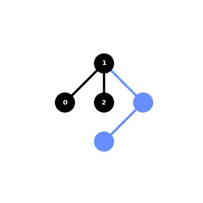

This shows the global connectivity of the Target which is the combination of the supported qubits for CXGate and CZGate. To see the individual connectivity, you can pass the operation name to CouplingMap.build_coupling_map():

target.build_coupling_map('cx').draw()

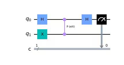

import numpy as np
from qiskit.providers.fake_provider import FakeVigoV2
backend = FakeVigoV2()
qc = QuantumCircuit(2, 1)
qc.h(0)
qc.x(1)
qc.cp(np.pi/4, 0, 1)
qc.h(0)
qc.measure([0], [0])
qc.draw(output='mpl')
../_images/transpiler-4.png

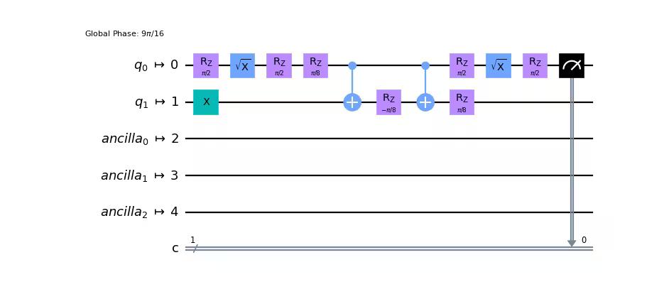

We have HH, XX, and controlled-PP gates, none of which are in our device’s basis gate set, and thus must be translated. This translation is taken care of for us in the qiskit.execute() function. However, we can transpile the circuit to show what it will look like in the native gate set of the target IBM Quantum device (the FakeVigoV2 backend is a fake backend that models the historical IBM Vigo 5 qubit device for test purposes):
from qiskit import transpile
qc.h(0)
qc.x(1)
qc.h(0)
qc_basis = transpile(qc, backend)
qc_basis.draw(output='mpl')
../_images/transpiler-5.png
A few things to highlight. First, the circuit has gotten longer with respect to the original. This can be verified by checking the depth of both circuits:
print('Original depth:', qc.depth(), 'Decomposed Depth:', qc_basis.depth())
Original depth: 4 Decomposed Depth: 10
Second, although we had a single controlled gate, the fact that it was not in the basis set means that, when expanded, it requires more than a single CXGate to implement. All said, unrolling to the basis set of gates leads to an increase in the depth of a quantum circuit and the number of gates.

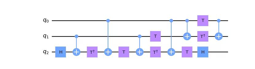

  2. A Toffoli, or controlled-controlled-not gate (ccx), is a three-qubit gate. Given that our basis gate set includes only single- and two-qubit gates, it is obvious that this gate must be decomposed. This decomposition is quite costly:
    ccx_circ = QuantumCircuit(3)
    ccx_circ.ccx(0, 1, 2)
    ccx_circ.decompose().draw(output='mpl')
    ../_images/transpiler-6.png
    For every Toffoli gate in a quantum circuit, the hardware may execute up to six CNOT gates, and a handful of single-qubit gates. From this example, it should be clear that any algorithm that makes use of multiple Toffoli gates will end up as a circuit with large depth and will therefore be appreciably affected by noise and gate errors.

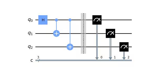

Let’s see what layouts are automatically picked at various optimization levels. The circuits returned by qiskit.compiler.transpile() are annotated with this initial layout information, and we can view this layout selection graphically using qiskit.visualization.plot_circuit_layout():
from qiskit import QuantumCircuit, transpile
from qiskit.visualization import plot_circuit_layout
backend = FakeVigo()
ghz = QuantumCircuit(3, 3)
ghz.h(0)
ghz.cx(0,range(1,3))
ghz.barrier()
ghz.measure(range(3), range(3))
ghz.draw(output='mpl')
../_images/transpiler-7.png
  • Layout Using Optimization Level 0
    ghz.h(0)
    ghz.barrier()
    new_circ_lv0 = transpile(ghz, backend=backend, optimization_level=0)
    plot_circuit_layout(new_circ_lv0, backend)
    ../_images/transpiler-8.png
  • Layout Using Optimization Level 3
    ghz.h(0)
    ghz.barrier()
    new_circ_lv3 = transpile(ghz, backend=backend, optimization_level=3)
    plot_circuit_layout(new_circ_lv3, backend)
    ../_images/transpiler-9.png

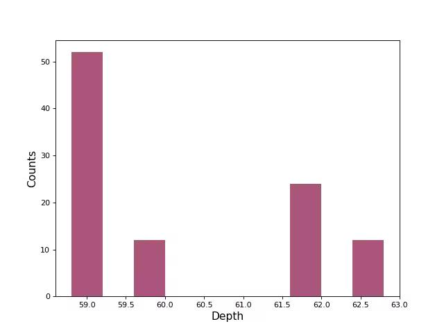

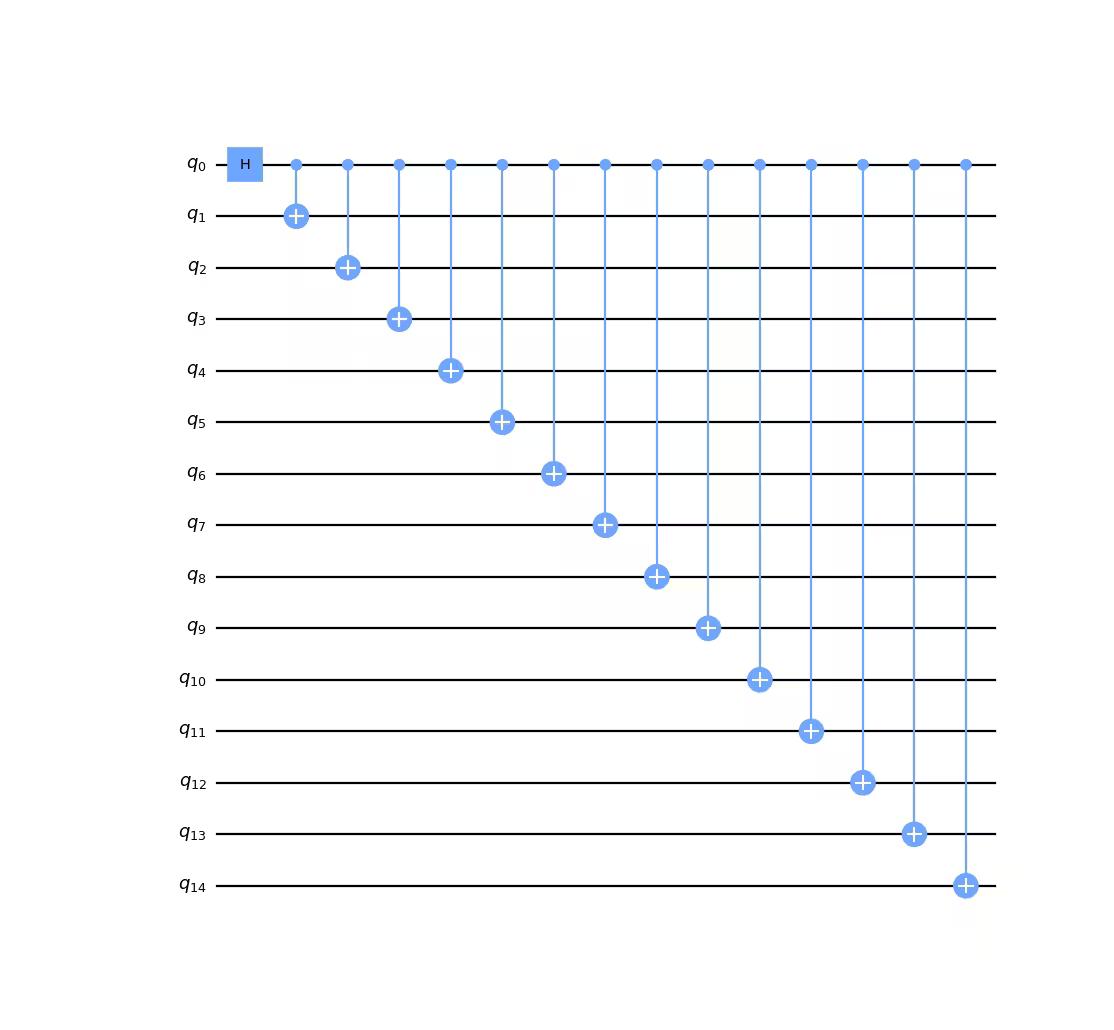

However, as with many important things in life, finding the optimal swap mapping is hard. In fact it is in a class of problems called NP-hard, and is thus prohibitively expensive to compute for all but the smallest quantum devices and input circuits. To get around this, by default Qiskit uses a stochastic heuristic algorithm called SabreSwap to compute a good, but not necessarily optimal swap mapping. The use of a stochastic method means the circuits generated by transpile() (or execute() that calls transpile() internally) are not guaranteed to be the same over repeated runs. Indeed, running the same circuit repeatedly will in general result in a distribution of circuit depths and gate counts at the output.
In order to highlight this, we run a GHZ circuit 100 times, using a “bad” (disconnected) initial_layout:
../_images/transpiler-11.png
from qiskit.providers.fake_provider import FakeAuckland
backend = FakeAuckland()
ghz = QuantumCircuit(15)
ghz.h(0)
ghz.cx(0, range(1, 15))
depths = []
for _ in range(100):
    depths.append(
        transpile(
            ghz,
            backend,
            layout_method='trivial'  # Fixed layout mapped in circuit order
        ).depth()
plt.figure(figsize=(8, 6))
plt.hist(depths, align='left', color='#AC557C')
plt.xlabel('Depth', fontsize=14)
plt.ylabel('Counts', fontsize=14);
../_images/transpiler-12.png
This distribution is quite wide, signaling the difficulty the swap mapper is having in computing the best mapping. Most circuits will have a distribution of depths, perhaps not as wide as this one, due to the stochastic nature of the default swap mapper. Of course, we want the best circuit we can get, especially in cases where the depth is critical to success or failure. The SabreSwap pass will by default by run its algorithm in parallel with multiple seed values and select the output which uses the fewest swaps. If you would like to increase the number of trials SabreSwap runs you can refer to Working with Preset Pass Managers and modify the routing stage with a custom instance of SabreSwap with a larger value for the trials argument.

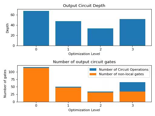

Optimization Stage
Decomposing quantum circuits into the basis gate set of the target device, and the addition of swap gates needed to match hardware topology, conspire to increase the depth and gate count of quantum circuits. Fortunately many routines for optimizing circuits by combining or eliminating gates exist. In some cases these methods are so effective the output circuits have lower depth than the inputs. In other cases, not much can be done, and the computation may be difficult to perform on noisy devices. Different gate optimizations are turned on with different optimization_level values. Below we show the benefits gained from setting the optimization level higher:
Important
The output from transpile() varies due to the stochastic swap mapper. So the numbers below will likely change each time you run the code.
../_images/transpiler-13.png
ghz.h(0)
depths = []
gate_counts = []
non_local_gate_counts = []
levels = [str(x) for x in range(4)]
for level in range(4):
     circ = transpile(ghz, backend, optimization_level=level)
     depths.append(circ.depth())
     gate_counts.append(sum(circ.count_ops().values()))
     non_local_gate_counts.append(circ.num_nonlocal_gates())
fig, (ax1, ax2) = plt.subplots(2, 1)
ax1.bar(levels, depths, label='Depth')
ax1.set_xlabel("Optimization Level")
ax1.set_ylabel("Depth")
ax1.set_title("Output Circuit Depth")
ax2.bar(levels, gate_counts, label='Number of Circuit Operations')
ax2.bar(levels, non_local_gate_counts, label='Number of non-local gates')
ax2.set_xlabel("Optimization Level")
ax2.set_ylabel("Number of gates")
ax2.legend()
ax2.set_title("Number of output circuit gates")
fig.tight_layout()
plt.show()
../_images/transpiler-14.png

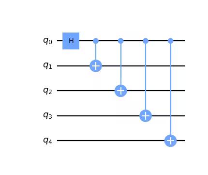

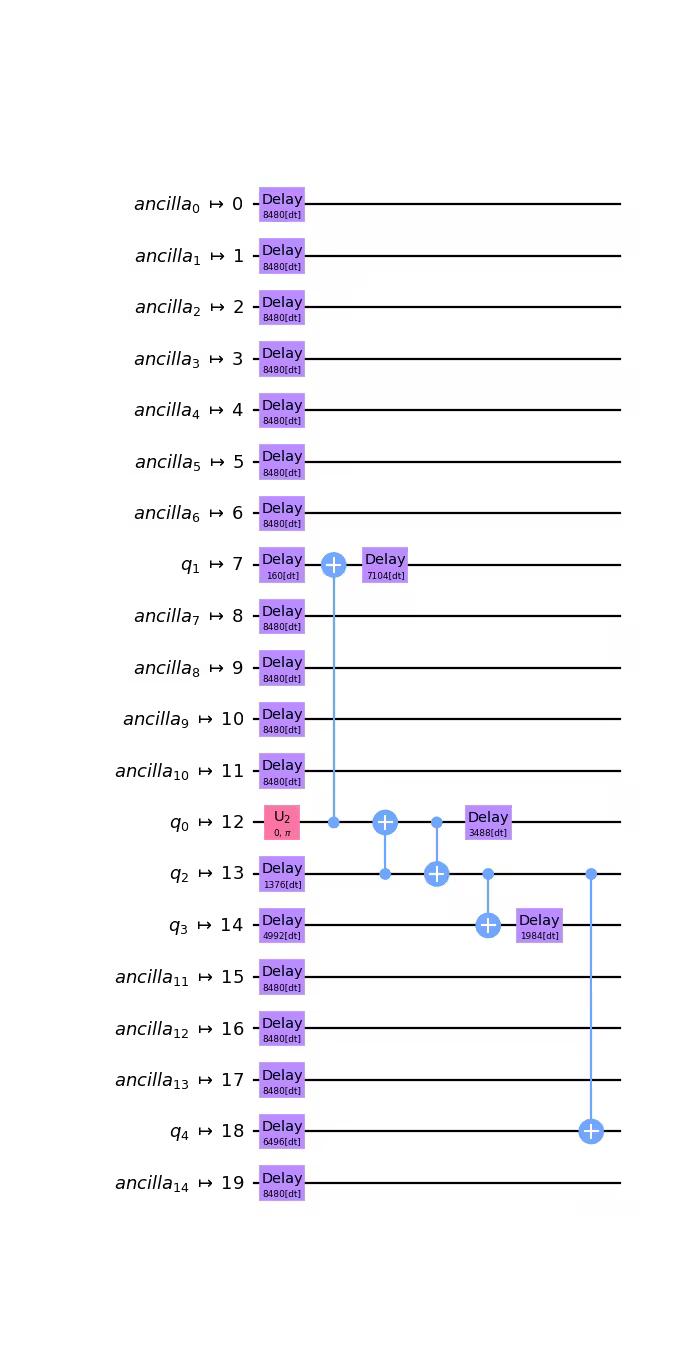

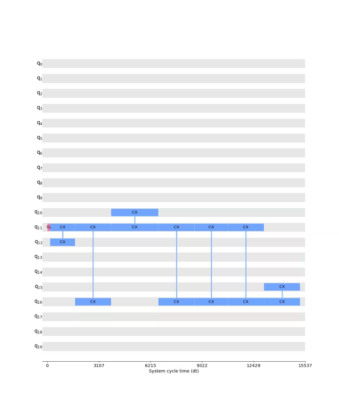

Scheduling Stage
After the circuit has been translated to the target basis, mapped to the device, and optimized, a scheduling phase can be applied to optionally account for all the idle time in the circuit. At a high level the scheduling can be thought of as inserting delays into the circuit to account for idle time on the qubits between the execution of instructions. For example, if we start with a circuit such as:
../_images/transpiler-15.png
we can then call transpile() on it with scheduling_method set:
from qiskit.providers.fake_provider import FakeBoeblingen
backend = FakeBoeblingen()
ghz = QuantumCircuit(5)
ghz.h(0)
ghz.cx(0,range(1,5))
circ = transpile(ghz, backend, scheduling_method="asap")
circ.draw(output='mpl')
../_images/transpiler-16.png
You can see here that the transpiler inserted Delay instructions to account for idle time on each qubit. To get a better idea of the timing of the circuit we can also look at it with the timeline.draw() function:
../_images/transpiler-17.png
The scheduling of a circuit involves two parts, analysis and constraint mapping followed by a padding pass. The first part requires running a scheduling analysis pass such as ALAPSchedulingAnalysis or ASAPSchedulingAnalysis which analyzes the circuit and records the start time of each instruction in the circuit using a scheduling algorithm (“as late as possible” for ALAPSchedulingAnalysis and “as soon as possible” for ASAPSchedulingAnalysis) in the property set. Once the circuit has an initial scheduling additional passes can be run to account for any timing constraints on the target backend, such as alignment constraints. This is typically done with the ConstrainedReschedule pass which will adjust the scheduling set in the property set to the constraints of the target backend. Once all the scheduling and adjustments/rescheduling are finished a padding pass, such as PadDelay or PadDynamicalDecoupling is run to insert the instructions into the circuit, which completes the scheduling.
