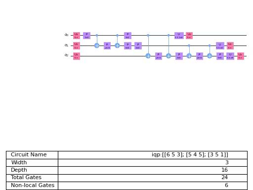

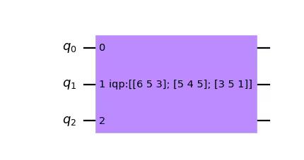

Reference Circuit:
../_images/qiskit-circuit-library-IQP-1.png
Expanded Circuit:
../_images/qiskit-circuit-library-IQP-2.png
