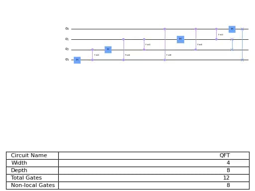

For 4 qubits, the circuit that implements this transformation is:
../_images/qiskit-circuit-library-QFT-1.png

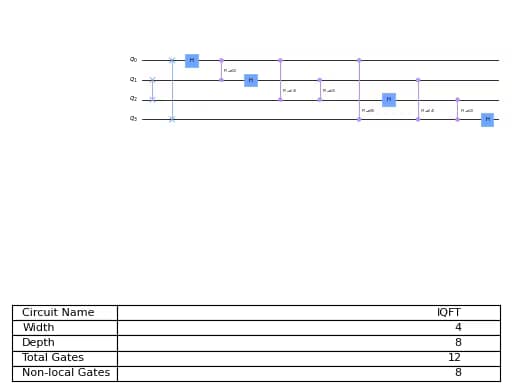

The inverse QFT can be obtained by calling the inverse method on this class. The respective circuit diagram is:
../_images/qiskit-circuit-library-QFT-2.png

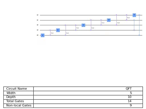

One method to reduce circuit depth is to implement the QFT approximately by ignoring controlled-phase rotations where the angle is beneath a threshold. This is discussed in more detail in https://arxiv.org/abs/quant-ph/9601018 or https://arxiv.org/abs/quant-ph/0403071.
Here, this can be adjusted using the approximation_degree attribute: the smallest approximation_degree rotation angles are dropped from the QFT. For instance, a QFT on 5 qubits with approximation degree 2 yields (the barriers are dropped in this example):
../_images/qiskit-circuit-library-QFT-3.png
