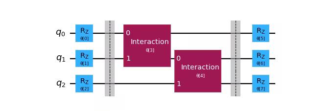

With linear entanglement, this circuit is given by:
from qiskit.circuit.library import excitation_preserving
ansatz = excitation_preserving(3, reps=1, insert_barriers=True, entanglement="linear")
ansatz.draw("mpl")
Circuit diagram output by the previous code.

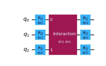

The entanglement structure can be explicitly specified with the entanglement argument. The "fsim" mode includes an additional parameterized CPhaseGate in each block:
ansatz = excitation_preserving(3, reps=1, mode="fsim", entanglement=[[0, 2]])
ansatz.draw("mpl")
Circuit diagram output by the previous code.Circuit diagram output by the previous code.
