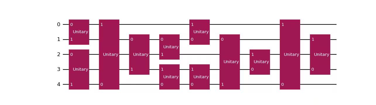

qiskit.circuit.library.quantum_volume(num_qubits, depth=None, seed=None)
A quantum volume model circuit.
The model circuits are random instances of circuits used to measure the Quantum Volume metric, as introduced in [1].
The model circuits consist of layers of Haar random elements of SU(4) applied between corresponding pairs of qubits in a random bipartition.

Reference Circuit:
