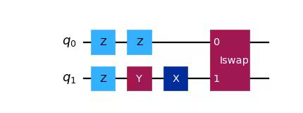

  • Added a new function random_clifford_circuit() to qiskit.circuit, that allows to generate a pseudo-random Clifford circuit with gates from the standard library. Example usage:
    from qiskit.circuit.random import random_clifford_circuit
    circ = random_clifford_circuit(num_qubits=2, num_gates=6)
    circ.draw(output='mpl')
    _images/release_notes-1.png

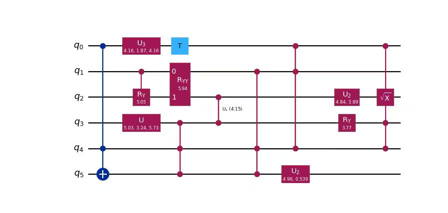

  • The random_circuit() function has a new feature where users can specify a distribution num_operand_distribution (a dict) that specifies the ratio of 1-qubit, 2-qubit, 3-qubit, and 4-qubit gates in the random circuit. For example, if num_operand_distribution = {1: 0.25, 2: 0.25, 3: 0.25, 4: 0.25} is passed to the function then the generated circuit will have approximately 25% of 1-qubit, 2-qubit, 3-qubit, and 4-qubit gates. Also it should be noted that the if num_operand_distribution is not specified then max_operands will default to 4 and a random circuit with a random gate distribution will be generated. If both num_operand_distribution and max_operands are specified at the same time then num_operand_distribution will be used to generate the random circuit.
    Example usage:
    from qiskit.circuit.random import random_circuit
    circ = random_circuit(
      num_qubits=6, depth=5, num_operand_distribution={1: 0.25, 2: 0.25, 3: 0.25, 4: 0.25}
    circ.draw(output="mpl")
    _images/release_notes-2.png

  • Fixed an issue where circuit_drawer() or the QuantumCircuit.draw() method would not raise a warning when an invalid value was passed to the justify argument, before changing it to the default. Now, it will raise a warning if an invalid value is passed. Valid justify values are "left", "right" or "none". Refer to #12089 for more details.
