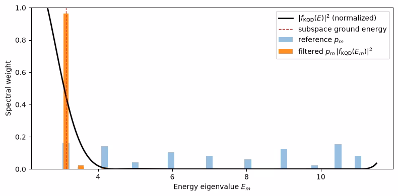

We observe how the energy converges as we increase the dimension of the Krylov subspace.
exact_evals = diagonalize_single_1_subspace(hamiltonian)
exact_ground = min(exact_evals)
print("exact ground state energy:  ", exact_ground)
threshold = 1e-12
energy_convergence = []
for r in range(1, krylov_dim + 1):
    energy_est_kqd, coeffs_est, retained_est = solve_thresholded_gevp(
        h_matrix_est[:r, :r],
        s_matrix_est[:r, :r],
        threshold=threshold,
    energy_convergence.append(energy_est_kqd)
    print(
        f"Krylov ground state energy (dim={r}, retained={retained_est}): ",
        energy_est_kqd,
Output:
exact ground state energy:   3.136296694843727
Krylov ground state energy (dim=1, retained=1):  7.0
Krylov ground state energy (dim=2, retained=2):  4.184510657551266
Krylov ground state energy (dim=3, retained=3):  3.5539074630394136
Krylov ground state energy (dim=4, retained=4):  3.3366270761341044

Appendix: The Hamiltonian-function (spectral-filter) viewpoint
The main workflow presented KQD operationally: build a Krylov basis from real-time-evolved states, estimate the projected matrices H\mathcal{H} and S\mathcal{S}, and solve the GEVP. This appendix revisits the same computation from a complementary angle that explains why KQD works: the Hamiltonian-function, or spectral-filter, viewpoint [3], [5]. It reuses the 12-qubit model, time step Δt\Delta t, and the Krylov solution already obtained above; no new circuit execution is required.
The reference state as an energy distribution
Let the Hamiltonian have the eigendecomposition
H=∑mEm ∣Em⟩ ⁣⟨Em∣,E0≤E1≤⋯ ,\begin{equation*} H=\sum_{m} E_m\,|E_m\rangle\!\langle E_m|, \qquad E_0\le E_1\le\cdots, \end{equation*}
with energy eigenstates ∣Em⟩|E_m\rangle. Any reference state can be expanded in this eigenbasis,
∣ψ0⟩=∑mam ∣Em⟩,am=⟨Em∣ψ0⟩,\begin{equation*} |\psi_{0}\rangle=\sum_m a_m\,|E_m\rangle, \qquad a_m=\langle E_m|\psi_{0}\rangle, \end{equation*}
so it carries a spectral weight pm=∣am∣2p_m=|a_m|^2 at each energy EmE_m. The reference energy is the mean of this distribution, ⟨H⟩0=∑mpmEm\langle H\rangle_{0}=\sum_m p_m E_m.
The eigendecomposition of a general nn-qubit Hamiltonian is exponentially costly, so this picture is only a diagnostic, which is not part of the algorithm. Here, however, we can compute it cheaply for the same n=12n=12 problem: the Heisenberg Hamiltonian conserves the total excitation number, and the reference ∣000001000000⟩|000001000000\rangle carries a single excitation, so its entire spectral content lives in the single-excitation subspace whose dimension grows only linearly with nn. We therefore reuse the exact single-excitation block (already used above as a benchmark) and read off the reference distribution {(Em,pm)}\{(E_m, p_m)\} inside that subspace.
# Exact single-excitation-subspace decomposition of the reference state.
# This reuses make_heisenberg_hamiltonian / _basis_state_transition_amplitude_sparse
# and the n=12 `hamiltonian` and `ref_bitstring` defined in the small-scale example.
single_excitation_states = [1 << k for k in range(num_qubits)]
h_single = np.array(
            _basis_state_transition_amplitude_sparse(hamiltonian, bra, ket)
            for ket in single_excitation_states
        for bra in single_excitation_states
h_single = 0.5 * (h_single + h_single.conj().T)
subspace_evals, subspace_evecs = la.eigh(h_single)
subspace_evals = np.real(subspace_evals)
# Reference-state coordinates inside the single-excitation subspace.
ref_position = single_excitation_states.index(int(ref_bitstring, 2))
ref_in_subspace = np.zeros(num_qubits, dtype=complex)
ref_in_subspace[ref_position] = 1.0
# Amplitudes and spectral weights of the reference in the energy eigenbasis.
ref_eigen_amplitudes = subspace_evecs.conj().T @ ref_in_subspace
ref_spectral_weights = np.abs(ref_eigen_amplitudes) ** 2
print(f"Single-excitation subspace dimension: {num_qubits}")
print(f"Subspace ground-state energy:         {subspace_evals[0]:.6f}")
print(
    f"Reference energy (sum p_m E_m):       {np.sum(ref_spectral_weights * subspace_evals):.6f}"
print(f"Reference weight on subspace ground:  {ref_spectral_weights[0]:.6f}")
Output:
Single-excitation subspace dimension: 12
Subspace ground-state energy:         3.136297
Reference energy (sum p_m E_m):       7.000000
Reference weight on subspace ground:  0.163827
KQD learns a filter that reshapes this distribution
A Hamiltonian function f(H)f(H) is defined through spectral calculus,
f(H)=∑mf(Em) ∣Em⟩ ⁣⟨Em∣,\begin{equation*} f(H)=\sum_m f(E_m)\,|E_m\rangle\!\langle E_m|, \end{equation*}
or in other words, a weighted sum of eigenprojectors. Applying it to the reference reshapes each spectral amplitude, am→amf(Em)a_m \to a_m f(E_m):
f(H) ∣ψ0⟩=∑mam f(Em) ∣Em⟩.\begin{equation*} f(H)\,|\psi_{0}\rangle=\sum_m a_m\,f(E_m)\,|E_m\rangle . \end{equation*}
If ff were sharply peaked at the lowest energy (f(E0)=1f(E_0)=1 and f(Em)≈0f(E_m)\approx 0 otherwise) then f(H)f(H) would act as a ground-state projector, and the normalized output would be (close to) the ground state. Therefore, a good low-pass spectral filter in energy is exactly what we want.
KQD does not prescribe ff in advance. Instead it expands the filter in the real-time-evolution basis,

Visualize the filter and its flexibility
We first show the learned filter at the full Krylov dimension used above, then track how it sharpens as the dimension rr grows.
The bars show the reference spectral weights pmp_m (before) and the filtered weights pm∣fKQD(Em)∣2p_m|f_{\rm KQD}(E_m)|^2 (after), together with the learned filter intensity ∣fKQD(E)∣2|f_{\rm KQD}(E)|^2 on a continuous energy axis. The filter concentrates the weight onto the lowest energy of the single-excitation subspace — the same energy that the KQD estimate converged to in the small-scale example. Note that this is the ground state within the single-excitation sector, which is the relevant target for this excitation-conserving reference state, not the global ground state.
fig, ax = plt.subplots(figsize=(8, 4))
visible = (ref_spectral_weights > 1e-4) | (filtered_weights > 1e-4)
ax.bar(
    subspace_evals[visible],
    ref_spectral_weights[visible],
    width=0.18,
    alpha=0.45,
    label="reference $p_m$",
ax.bar(
    filtered_weights[visible],
    width=0.14,
    alpha=0.9,
    label=r"filtered $p_m\,|f_{\rm KQD}(E_m)|^2$",
energy_grid = np.linspace(
    subspace_evals.min() - 0.5, subspace_evals.max() + 0.5, 800
filter_intensity = (
    np.abs(trigonometric_krylov_filter(kqd_coeffs, energy_grid, dt)) ** 2
filter_intensity /= filter_intensity.max()
ax.plot(
    energy_grid,
    filter_intensity,
    color="k",
    linewidth=2,
    label=r"$|f_{\rm KQD}(E)|^2$ (normalized)",
ax.axvline(
    subspace_evals[0],
    color="C3",
    linestyle="--",
    linewidth=1,
    label="subspace ground energy",
ax.set_xlabel("Energy eigenvalue $E_m$")
ax.set_ylabel("Spectral weight")
ax.set_ylim(0, 1)
ax.legend(loc="upper right")
plt.tight_layout()
plt.show()
Output:
Output of the previous code cell
