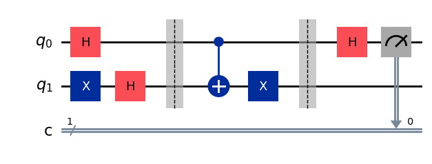

Again we can see what the circuit looks like using the draw method.
display(compile_circuit(deutsch_function(3)).draw(output="mpl"))
Output:

Finally, we'll create a function that runs the circuit previously defined one time and outputs the appropriate result: "constant" or "balanced."
def deutsch_algorithm(function: QuantumCircuit):
    # Determine if a one-bit function is constant or balanced.
    qc = compile_circuit(function)
    result = AerSimulator().run(qc, shots=1, memory=True).result()
    measurements = result.get_memory()
    if measurements[0] == "0":
        return "constant"
    return "balanced"
We can now run Deutsch's algorithm on any one of the four functions defined above.
f = deutsch_function(3)
display(deutsch_algorithm(f))
Output:
'balanced'
