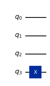

We can show the quantum circuit implementation of the query gate using the draw method as usual.
display(dj_query(3).draw(output="mpl"))
Output:
Output of the previous code cell

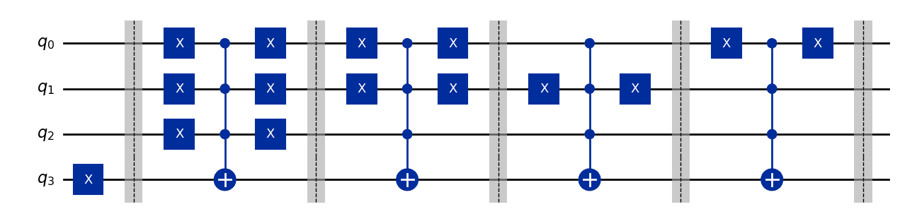

We can test our implementation by choosing a function randomly, displaying the quantum circuit implementation of a query gate for this function, and then running the Deutsch-Jozsa algorithm on that function.
f = dj_query(3)
display(f.draw("mpl"))
display(dj_algorithm(f))
Output:
'balanced'

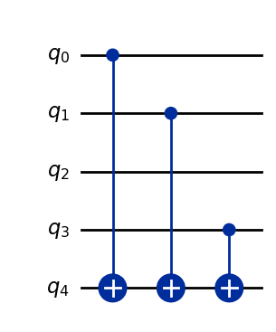

display(bv_query("1011").draw(output="mpl"))
Output:
