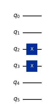

2.3 Prepare the quantum circuit 1 (Initial state)
Create an initial state. Here we will start with a spin configuration of ↑↑↓↓↑↑\uparrow\uparrow\downarrow\downarrow\uparrow\uparrow .
initial_circuit = QuantumCircuit(n_qubits)
initial_circuit.prepare_state("001100")
# Change reps and see the difference when you decompose the circuit
initial_circuit.decompose(reps=1).draw("mpl")

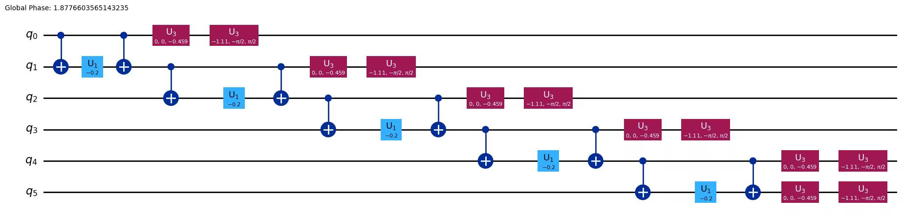

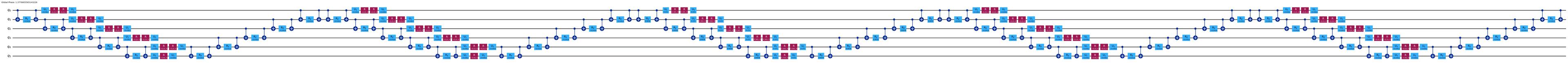

2.4 Prepare the quantum circuit 2 (Single circuit for time evolution)
We here construct a circuit for a single time step using Lie–Trotter.
The Lie product formula (first-order) is implemented in the LieTrotter class. A first-order formula consists of the approximation stated in the introduction, where the matrix exponential of a sum is approximated by a product of matrix exponentials:
eH1+H2≈eH1eH2e^{H_1+H_2} \approx e^{H_1} e^{H_2}
As previously mentioned, very deep circuits lead to the accumulation of errors, and cause problems for modern quantum computers. Because two-qubit gates have higher error rates than single-qubit gates, a quantity of particular interest is the two-qubit circuit depth. What really matters is the two-qubit circuit depth after transpilation (since that is the circuit the quantum computer actually executes). But let us get in the habit of counting the operations for this circuit, even now using the simulator.
single_step_evolution_gates_lt = PauliEvolutionGate(
    hamiltonian, dt, synthesis=product_formula_lt
single_step_evolution_lt = QuantumCircuit(n_qubits)
single_step_evolution_lt.append(
    single_step_evolution_gates_lt, single_step_evolution_lt.qubits
print(
    f"""
Trotter step with Lie-Trotter
Depth: {single_step_evolution_lt.decompose(reps=3).depth()}
Gate count: {len(single_step_evolution_lt.decompose(reps=3))}
Nonlocal gate count: {single_step_evolution_lt.decompose(reps=3).num_nonlocal_gates()}
Gate breakdown: {", ".join([f"{k.upper()}: {v}" for k, v in single_step_evolution_lt.decompose(reps=3).count_ops().items()])}
single_step_evolution_lt.decompose(reps=3).draw("mpl", fold=-1)
Output:
Depth: 17
Gate count: 27
Nonlocal gate count: 10
Gate breakdown: U3: 12, CX: 10, U1: 5
Output of the previous code cell

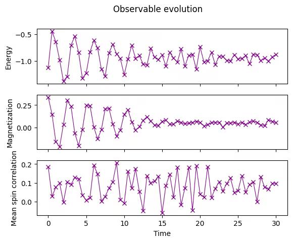

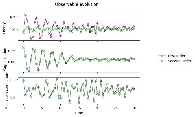

2.7 Plot the time evolution of the observables
We plot the expectation values we measured against time.
fig, axes = plt.subplots(3, sharex=True)
times = np.linspace(0, evolution_time, num_timesteps + 1)  # includes initial state
axes[0].plot(
    times,
    energy_array,
    label="First order",
    marker="x",
    c="darkmagenta",
    ls="-",
    lw=0.8,
axes[1].plot(
    times, mag_array, label="First order", marker="x", c="darkmagenta", ls="-", lw=0.8
axes[2].plot(
    times, corr_array, label="First order", marker="x", c="darkmagenta", ls="-", lw=0.8
axes[0].set_ylabel("Energy")
axes[1].set_ylabel("Magnetization")
axes[2].set_ylabel("Mean spin correlation")
axes[2].set_xlabel("Time")
fig.suptitle("Observable evolution")
Output:
Text(0.5, 0.98, 'Observable evolution')

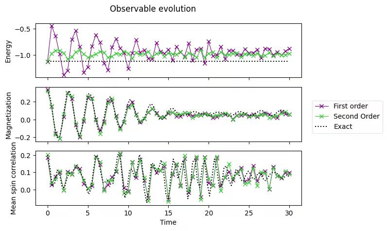

3. Exercise 1. Perform simulation using second-order Suzuki–Trotter
Now let's try performing simulation with second-order Suzuki–Trotter following the example of Lie–Trotter shown above.
The second-order Suzuki-Trotter can be used in Qiskit by means of the SuzukiTrotter class. Using this formula, a second order decomposition is:
eH1+H2≈eH1/2eH2eH1/2e^{H_1+H_2} \approx e^{H_1/2}e^{H_2}e^{H_1/2}
3.1 Construct a circuit for a single time step

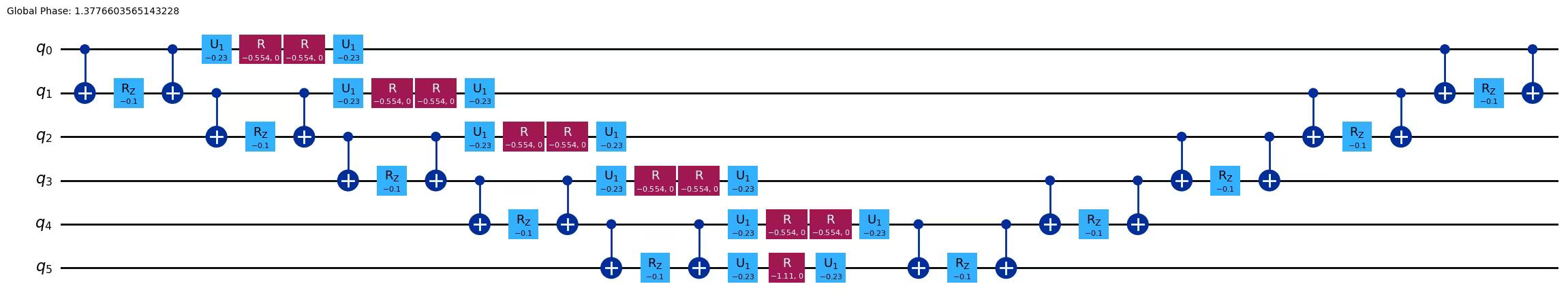

Use product_formula_st2 (SuzukiTrotter(order=2)) and construct a circuit for a single time step using second-order Suzuki–Trotter. Also, count the number of gates and depth of the circuit and compare with Lie–Trotter.
# Modify the line below (Use PauliEvolutionGate)
single_step_evolution_gates_st2 = PauliEvolutionGate(
    hamiltonian, dt, synthesis=product_formula_st2
single_step_evolution_st2 = QuantumCircuit(n_qubits)
single_step_evolution_st2.append(
    single_step_evolution_gates_st2, single_step_evolution_st2.qubits
# Let us print some stats
print(
    f"""
Trotter step with second-order Suzuki-Trotter
Depth: {single_step_evolution_st2.decompose(reps=3).depth()}
Gate count: {len(single_step_evolution_st2.decompose(reps=3))}
Nonlocal gate count: {single_step_evolution_st2.decompose(reps=3).num_nonlocal_gates()}
Gate breakdown: {", ".join([f"{k.upper()}: {v}" for k, v in single_step_evolution_st2.decompose(reps=3).count_ops().items()])}
single_step_evolution_st2.decompose(reps=2).draw("mpl", fold=-1)
Output:
Depth: 34
Gate count: 53
Nonlocal gate count: 20
Gate breakdown: U3: 23, CX: 20, U1: 10
3.2 Perform time-evolution simulation
Perform time evolution using second-order Suzuki–Trotter.
# Initiate the circuit
evolved_state = QuantumCircuit(initial_circuit.num_qubits)
# Start from the initial spin configuration
evolved_state.append(initial_circuit, evolved_state.qubits)
# Initiate Estimator (V2)
estimator = StatevectorEstimator()
# Set number of shots
shots = 10000
# Translate the precision required from the number of shots
precision = np.sqrt(1 / shots)
energy_list_st2 = []
mag_list_st2 = []
corr_list_st2 = []
# Estimate expectation values for t=0.0
job = estimator.run(
    [(evolved_state, [hamiltonian, magnetization, correlation])], precision=precision
# Get estimated expectation values
evs = job.result()[0].data.evs
energy_list_st2.append(evs[0])
mag_list_st2.append(evs[1])
corr_list_st2.append(evs[2])
# Start time evolution
for n in range(num_timesteps):
    # Expand the circuit to describe delta-t
    evolved_state.append(single_step_evolution_gates_st2, evolved_state.qubits)
    # Estimate expectation values at delta-t
        precision=precision,
    # Retrieve results (expectation values)
# Transform the list of expectation values (at each time step) to arrays
energy_array_st2 = np.array(energy_list_st2)
mag_array_st2 = np.array(mag_list_st2)
corr_array_st2 = np.array(corr_list_st2)
3.3 Plot the second-order Suzuki–Trotter results
axes[0].plot(
    times,
    energy_array_st2,
    label="Second Order",
    marker="x",
    c="limegreen",
    ls="-",
    lw=0.8,
axes[1].plot(
    times,
    mag_array_st2,
    marker="x",
    c="limegreen",
    ls="-",
    lw=0.8,
axes[2].plot(
    times,
    corr_array_st2,
    marker="x",
    c="limegreen",
    ls="-",
    lw=0.8,
# Replace the legend
# legend.remove()
legend = fig.legend(
    *axes[0].get_legend_handles_labels(),
    bbox_to_anchor=(1.0, 0.5),
    loc="center left",
    framealpha=0.5,
fig
Output:
3.4 Compare with exact results
The data below is the precomputed exact results from the classical computer.
exact_times = np.array(
        0.0,
        0.3,
        0.6,
        0.8999999999999999,
        1.2,
        1.5,
        1.7999999999999998,
        2.1,

exact_energy = np.array(

exact_magnetization = np.array(

exact_correlation = np.array(

axes[0].plot(exact_times, exact_energy, c="k", ls=":", label="Exact")
axes[1].plot(exact_times, exact_magnetization, c="k", ls=":", label="Exact")
axes[2].plot(exact_times, exact_correlation, c="k", ls=":", label="Exact")
legend.remove()
# Select the labels of only the first axis
    loc="center left",
    framealpha=0.5,
fig.tight_layout()
fig
Output:

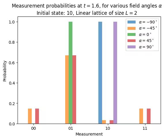

bar_width = 0.1
# initial_state = Statevector.from_label("10")
final_time = 1.6
eps = 1e-5
# We create the list of angles in radians, with a small epsilon
# the exactly longitudinal field, which would present no dynamics at all
alphas = np.linspace(-np.pi / 2 + eps, np.pi / 2 - eps, 5)
for i, alpha in enumerate(alphas):
    evolved_state_2 = QuantumCircuit(initial_circuit_2.num_qubits)
    evolved_state_2.append(initial_circuit_2, evolved_state_2.qubits)
    hamiltonian_2 = get_hamiltonian(nqubits=2, J=0.2, h=1.0, alpha=alpha)
    single_step_evolution_gates_2 = PauliEvolutionGate(
        hamiltonian_2, dt_2, synthesis=product_formula
    evolved_state_2.append(single_step_evolution_gates_2, evolved_state_2.qubits)
    evolved_state_2 = Statevector(evolved_state_2)
    # Dictionary of probabilities
    amplitudes_dict = evolved_state_2.probabilities_dict()
    labels = list(amplitudes_dict.keys())
    values = list(amplitudes_dict.values())
    # Convert angle to degrees
    alpha_str = f"$\\alpha={int(np.round(alpha * 180 / np.pi))}^\\circ$"
    plt.bar(np.arange(4) + i * bar_width, values, bar_width, label=alpha_str, alpha=0.7)
plt.xticks(np.arange(4) + 2 * bar_width, labels)
plt.xlabel("Measurement")
plt.ylabel("Probability")
plt.suptitle(
    f"Measurement probabilities at $t={final_time}$, for various field angles $\\alpha$\n"
    f"Initial state: 10, Linear lattice of size $L=2$"
plt.legend()
Output:
<matplotlib.legend.Legend at 0x11c816590>
We have prepared a system initially with a sequence of spins ↓↑\downarrow\uparrow, which corresponds to ∣ψ(0)⟩=∣10⟩\vert\psi(0)\rangle = \vert10\rangle. After letting it evolve for t=1.6t=1.6 under a transversal field (α=0∘\alpha=0^\circ), we are almost guaranteed to measure ↑↓\uparrow\downarrow, that is, have a spin swap. (Note that the labels are interpreted from right to left). If the field is longitudinal (α=±90∘\alpha=\pm90^\circ), we will have no evolution, therefore we will measure the system as it was initially prepared, ↓↑\downarrow\uparrow. With intermediate angles, at α=±45∘\alpha=\pm45^\circ, we will be able to measure all combinations will different probabilities, being a spin swap the most likely with a probability of 67%.

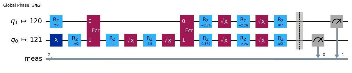

4.2 Step 2. Optimize for target hardware
We specify a backend.
service = QiskitRuntimeService()
backend = service.least_busy(operational=True, simulator=False)
backend.name
Output:
'ibm_strasbourg'
Then we transpile the circuit for the selected backend.
pm = generate_preset_pass_manager(backend=backend, optimization_level=3)
circuit_isa = pm.run(circuit_list)
Check out the circuit.
circuit_isa[1].draw("mpl", idle_wires=False)
Output:

We here show an example for constructing a circuit using higher-order (fourth-order) Suzuki–Trotter. Now let's try constructing a circuit simulation with fourth-order Suzuki–Trotter following the examples shown above.
The fourth-order Suzuki–Trotter can be used in Qiskit by means of the SuzukiTrotter class. The fourth-order can be evaluated using the following recursion relation. Note that the order of Suzuki–Trotter is denoted as "2k" in the following equations.
U^ST(2k)(t)=[U^ST(2k−2)(pkt)]2U^ST(2k−2)((1−4pk)t)[U^ST(2k−2)(pkt)]2\hat{U}_{ST(2k)}\left(t\right) = \left[ \hat{U}_{ST(2k-2)}\left(p_k t\right) \right]^2 \hat{U}_{ST(2k-2)}\left( (1- 4 p_k) t\right)\left[ \hat{U}_{ST(2k-2)}\left(p_k t\right) \right]^2 pk=1/(4−412k−1)p_k = 1 / \left(4-4^{\frac{1}{2k-1}}\right)
Use product_formula_st4 (SuzukiTrotter(order=4)) and construct a circuit for a single time step using fourth-order Suzuki–Trotter. Also, count the number of gates and depth of the circuit and compare with Lie–Trotter and second-order Suzuki–Trotter.
single_step_evolution_gates_st4 = PauliEvolutionGate(
    hamiltonian, dt, synthesis=product_formula_st4
single_step_evolution_st4 = QuantumCircuit(n_qubits)
single_step_evolution_st4.append(
    single_step_evolution_gates_st4, single_step_evolution_st4.qubits
print(
    f"""
Depth: {single_step_evolution_st4.decompose(reps=3).depth()}
Gate count: {len(single_step_evolution_st4.decompose(reps=3))}
Nonlocal gate count: {single_step_evolution_st4.decompose(reps=3).num_nonlocal_gates()}
Gate breakdown: {", ".join([f"{k.upper()}: {v}" for k, v in single_step_evolution_st4.decompose(reps=3).count_ops().items()])}
single_step_evolution_st4.decompose(reps=2).draw("mpl", fold=-1)
Output:
Depth: 170
Gate count: 265
Nonlocal gate count: 100
Gate breakdown: U3: 115, CX: 100, U1: 50
