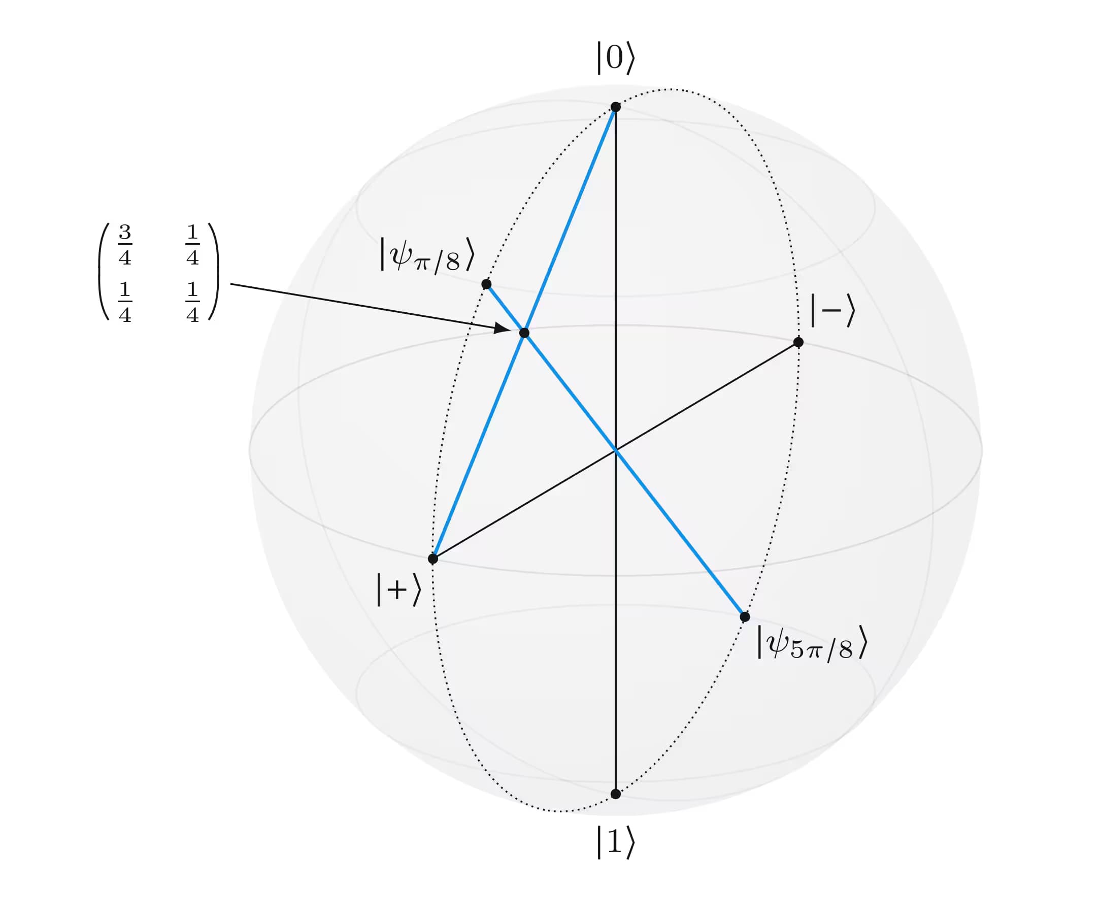

A different example concerning convex combinations of Bloch sphere points is the one discussed in the previous subsection.
1200+12++=(34141414)=cos2(π/8)ψπ/8ψπ/8+sin2(π/8)ψ5π/8ψ5π/8\frac{1}{2} \vert 0\rangle\langle 0 \vert + \frac{1}{2} \vert +\rangle\langle + \vert = \begin{pmatrix} \frac{3}{4} & \frac{1}{4}\\[2mm] \frac{1}{4} & \frac{1}{4} \end{pmatrix} = \cos^2(\pi/8) \vert \psi_{\pi/8} \rangle \langle \psi_{\pi/8}\vert + \sin^2(\pi/8) \vert \psi_{5\pi/8} \rangle \langle \psi_{5\pi/8}\vert
The following figure illustrates these two different ways of obtaining this density matrix as a convex combination of pure states.
Illustration of the average of the zero state and the plus state on the Bloch sphere
