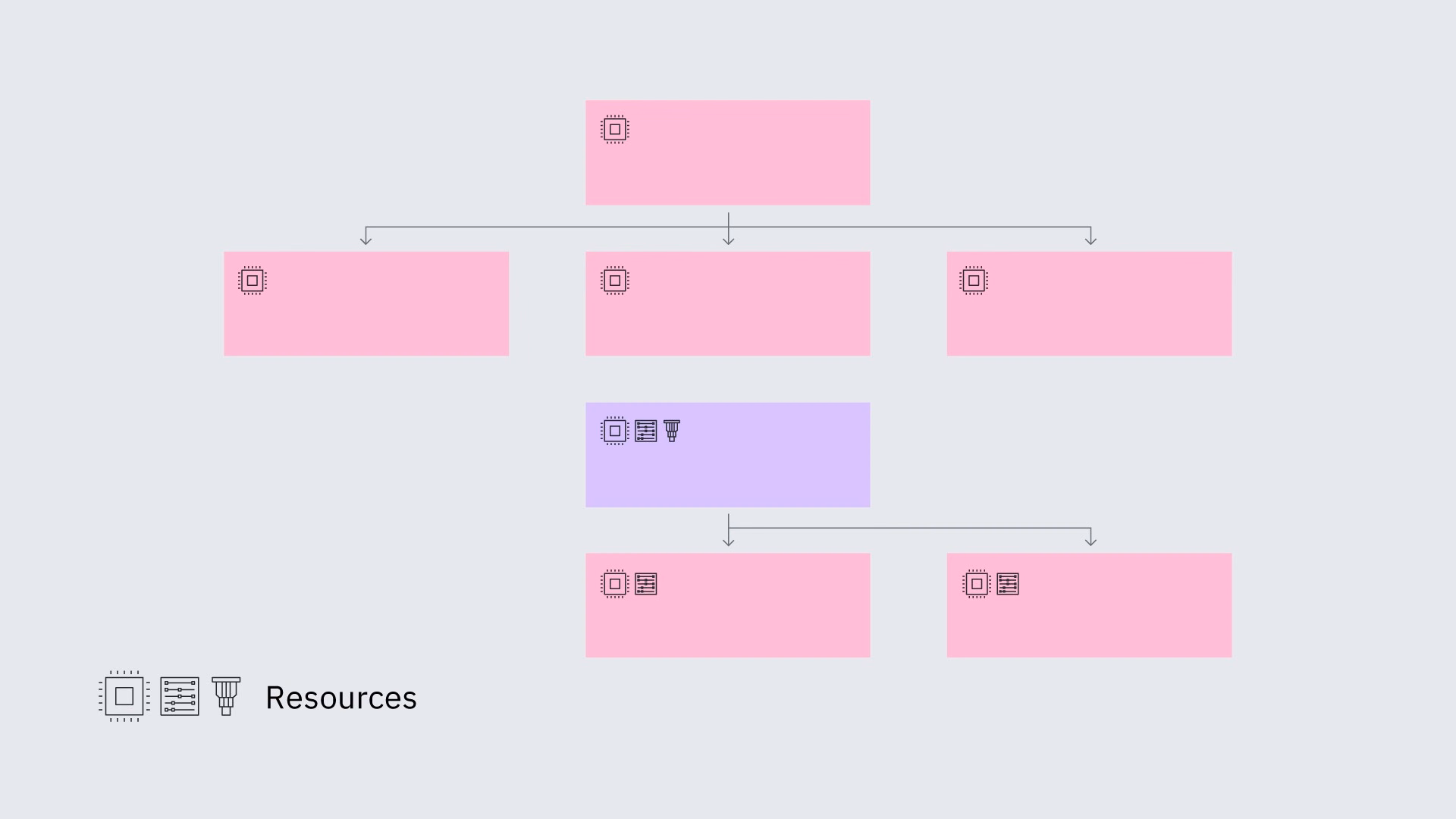

Task workflows
Now let's talk about the Task workflow programming model. A task workflow abstracts computation into a directed acyclic graph (DAG). In this graph, each node represents a particular task or job, and the edges (the arrows connecting the nodes) represent the dependencies (data and ordering) between them. A scheduler is the component that maps tasks to resources and orchestrates execution.
A concrete example of a task workflow model applied to quantum computing is the Qiskit patterns framework. A Qiskit pattern is a general framework designed to break down domain-specific problems into a sequence of stages, especially for quantum tasks. This allows for the seamless composability of new capabilities developed by IBM Quantum® researchers (and others) and enables a future in which quantum computing tasks are performed by powerful heterogeneous (CPU/GPU/QPU) computing infrastructure. The four steps of a Qiskit pattern are mapping, optimization, execution, and post-processing, where all tasks are executed one after another in a pipeline. But with task workflows we are not bound to a linear execution order and can execute tasks in parallel. Each task of a workflow can be an entire parallel job of its own. So, you can mix and match these models to describe arbitrarily complex algorithms, and a workload manager like Slurm will handle these.
A diagram of computing tasks organized into a workflow in which some processes are executed in parallel and others in sequence.
The image above illustrates the Qiskit pattern in action. The workflow has a graph structure with four stages. This branch-like structure is orchestrated and executed by the scheduler. The problem is mapped into quantum-executable form (quantum circuit) at the initial stage. In the next stage, this quantum circuit is optimized for the specific quantum hardware. The image shows this as a parallel process, which demonstrates how multiple optimization strategies could be applied at the same time. The optimized quantum circuit is then executed on the actual quantum hardware. This is the third stage of the image where the scheduler works with one purple quantum processing unit. Finally, the results are post-processed by classical resources.
