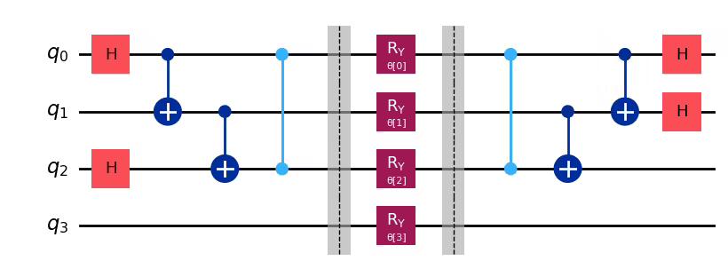

Generally, selecting the best ansatz is an art; the best ansatz is whatever ansatz helps you reach your target in the fewest optimization steps. It is easier to identify ansaetze that are likely to be bad. For example, greater circuit depth tends to result in accumulation of errors. Error mitigation can help with this, but it is a good practice to keep the circuit depth as low as is reasonable. But don't skip entanglement that is necessary. You might have a target state that requires a full entanglement scheme. Two examples are shown below that are likely to be poor choices for fairly obvious reasons. Choosing a good ansatz will be revisited in later sections in the context of convergence tests.
This first circuit is likely to be a poor choice because the last qubit is not entangled with the others at all. Indeed there is no computationally meaningful action on the last qubit. In all likelihood, the last qubit should either be entangled with the others or removed from the calculation.
n = 4
theta = ParameterVector("θ", length=n)
qc = QuantumCircuit(n)
qc.h(0)
qc.h(2)
for i in range(n - 2):
qc.cx(i, i + 1)
qc.cz(0, n - 2)
qc.barrier()
for i in range(n):
qc.ry(theta[i], i)
qc.barrier()
qc.cz(0, n - 2)
for i in reversed(range(n - 2)):
qc.cx(i, i + 1)
qc.h(0)
qc.h(1)
own_ansatz2 = qc
print(own_ansatz2.depth())
qc.draw("mpl")Output:
9

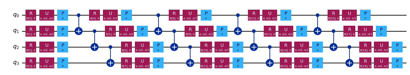

This last circuit is likely a poor choice, because the gate depth is very high, and repeating the entanglement layer four times is not likely to yield a substantially better match to the target state than two or three repetitions.
su2_ansatz_long = efficient_su2(
4, su2_gates=["rx", "y", "z"], entanglement="linear", reps=4
print(su2_ansatz_long.decompose().depth())
su2_ansatz_long.decompose().draw(output="mpl")Output:
24
These circuits are not "complete" in the sense that there are still unknown and variable parameters to be inserted into many of the gates. Those parameters are chosen by making successive guesses, and updating parameters to lower the expectation value of the cost function (in the chemistry context, typically the ground state energy). In one, or even a few dimensions, this is trivial. But the circuit above has 20 variational parameters, meaning that finding the target state with the minimal energy means searching a 20-dimensional state (another reason not to include unnecessary circuit gates). This is where classical optimizing algorithms come into play, and that is the subject of the next lesson.
