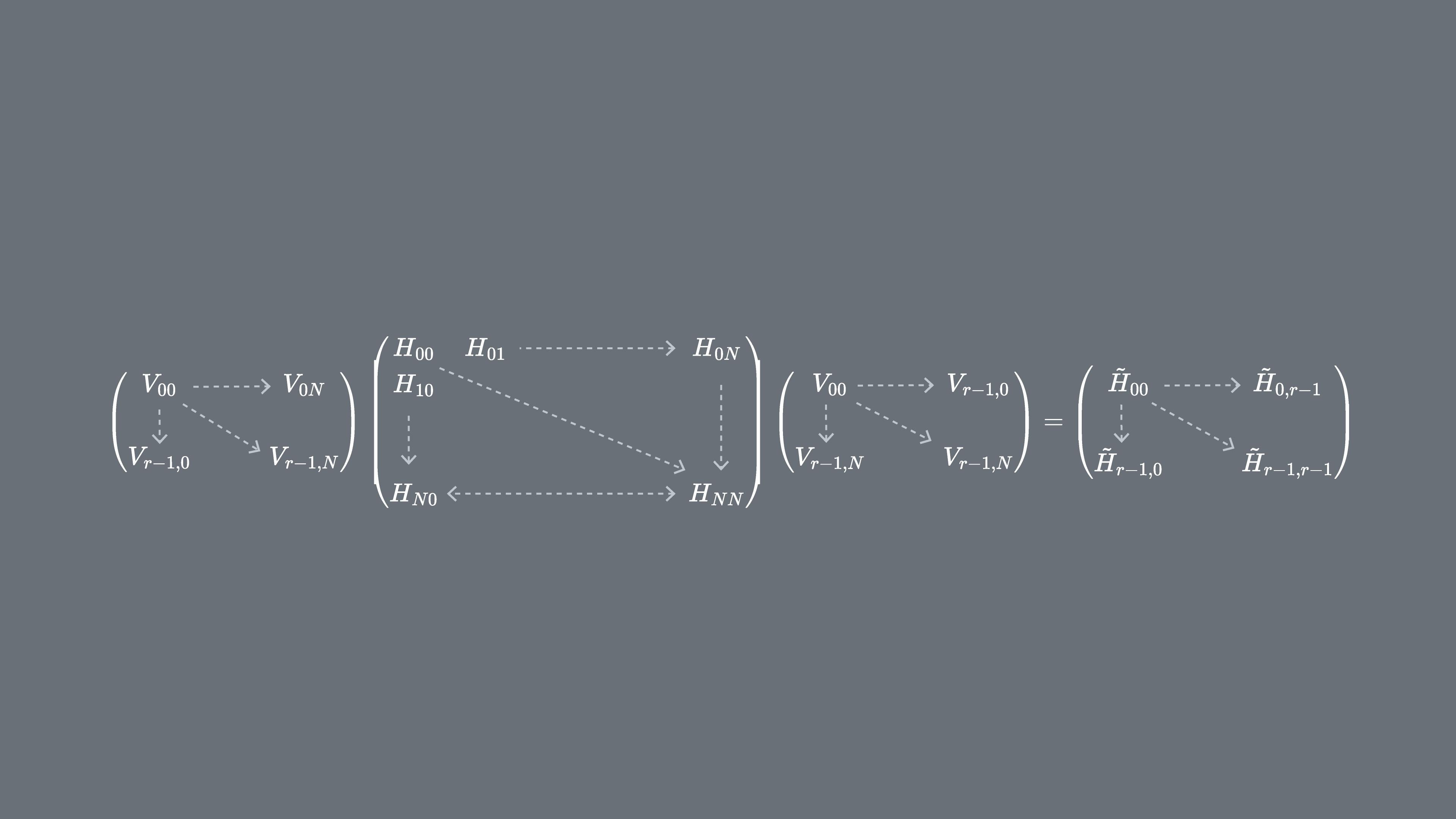

An image showing a very large matrix being projected onto a Krylov subspace, that is, rows of Krylov vectors making a matrix on the left, a Hamiltonian, then columns of Krylov vectors on the right.

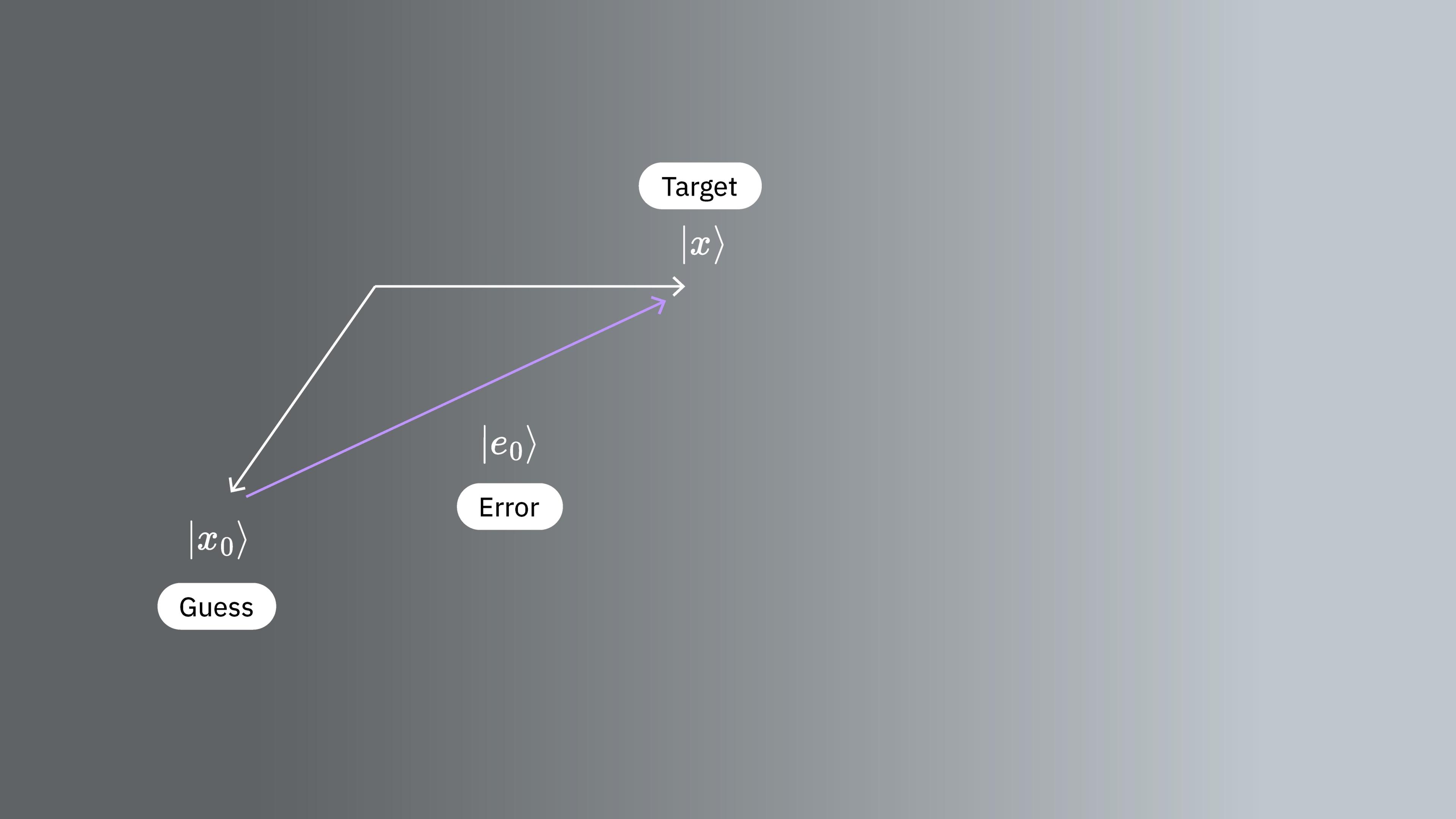

We typically wish to solve a problem of the form
A∣x⟩=∣b⟩.A|x\rangle=|b\rangle.
One might imagine that ∣b⟩=c∣x⟩|b\rangle=c|x\rangle where cc is some constant, as in an eigenvalue problem. But our problem statement remains more general for now.
We start with a vector ∣x0⟩|x_0\rangle that is an approximate solution. Although there are parallels between this guess ∣x0⟩|x_0\rangle and ∣v0⟩|v_0\rangle in Section 1.1, we are not leveraging these here. Our guess ∣x0⟩|x_0\rangle has error, which we call ∣e0⟩|e_0\rangle:
∣e0⟩:=∣x⟩−∣x0⟩.|e_0\rangle:=|x\rangle−|x_0\rangle.
We also define the residual R0R_0:
∣R0⟩=∣b⟩−A∣x0⟩.|R_0\rangle=|b\rangle−A|x_0\rangle.
Here we use capital RR to distinguish the residual from the dimension of our Krylov subspace rr.

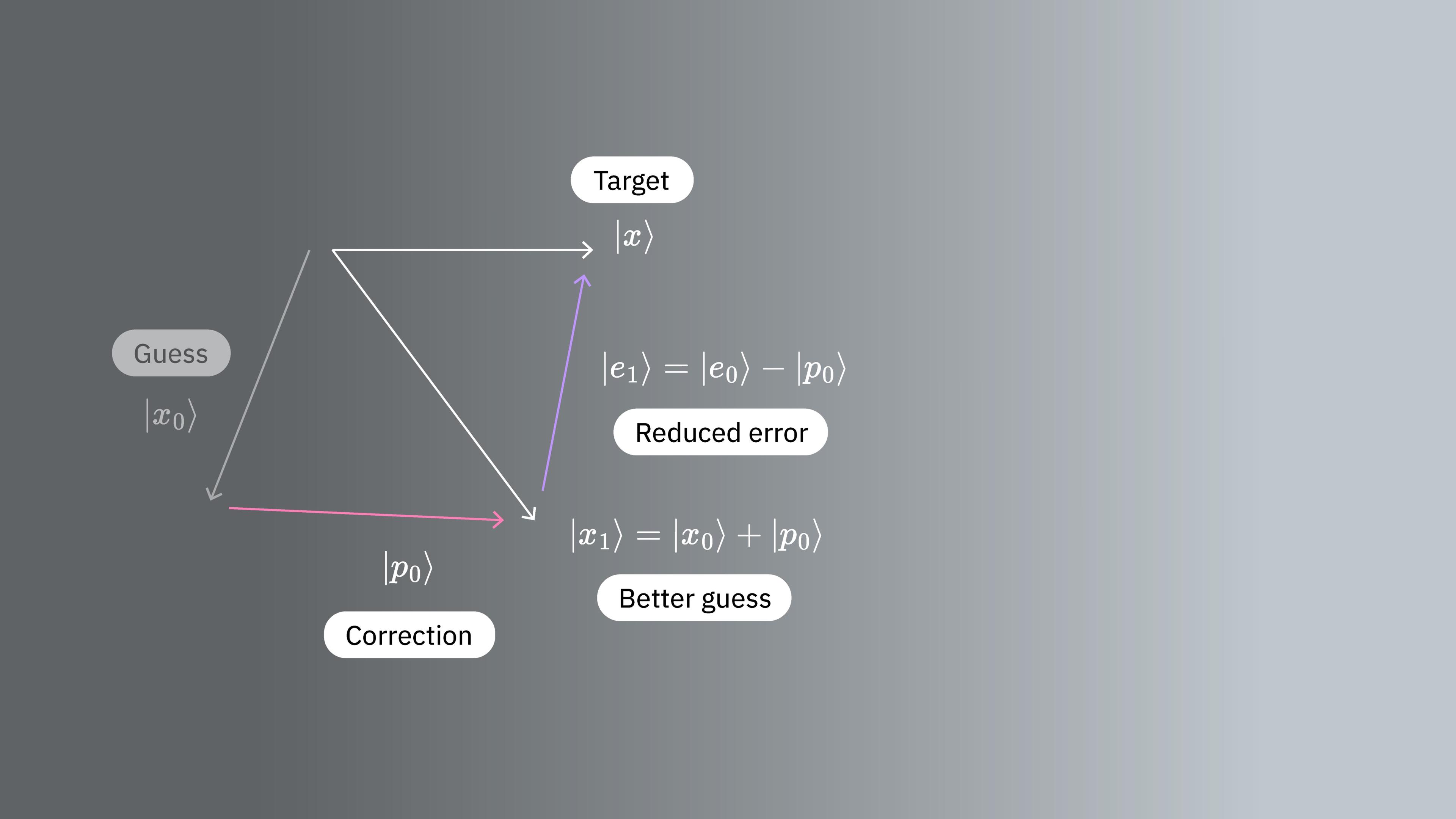

A true eigenvector labeled x, a guess labeled x 0 and a graphical representation of hte error between those two.
We now want to make a correction step of the form
∣x1⟩=∣x0⟩+∣p0⟩,|x_1\rangle=|x_0\rangle+|p_0\rangle,
which we hope improves our approximation. Here ∣p0⟩|p_0\rangle is some vector yet to be determined. Let ∣e1⟩|e_1\rangle be the error after the correction is made. Then
∣e1⟩=∣x⟩−∣x1⟩=∣x⟩−(∣x0⟩+∣p0⟩)=∣e0⟩−∣p0⟩.|e_1\rangle=|x\rangle−|x_1\rangle=|x\rangle−(|x_0\rangle+|p_0\rangle)=|e_0\rangle−|p_0\rangle. A true eigenvector and an update to the initial guess. The updated guess is closer to the true eigenvector.

Now, using the relation that
∣Rk+1⟩=∣b⟩−A∣xk+1⟩=∣b⟩−A(∣xk⟩+αk∣Rk⟩)=∣Rk⟩−αkA∣Rk⟩,|R_{k+1}\rangle=|b\rangle−A |x_{k+1}\rangle=|b\rangle−A(|x_k\rangle+\alpha_k |R_k\rangle)=|R_k\rangle−\alpha_k A |R_k\rangle,
we see that
span{∣R0⟩,∣R1⟩,…,∣Rk⟩}=span{∣R0⟩,A∣R0⟩,…,Ak∣R0⟩}.\text{span} \{|R_0\rangle,|R_1\rangle,…,|R_k\rangle \}=\text{span} \{|R_0\rangle,A|R_0\rangle,…,A^{k}|R_0\rangle \}.
That is, the space we build up that most efficiently approximates the correct solution ∣x⟩|x\rangle is exactly the space built up by successive operation of the matrix AA on ∣R0⟩|R_0\rangle. A Krylov subspace is the space spanned by the vectors of successive directions of steepest descent.
Finally we reiterate that we have made no numerical claims about the scaling of this approach, nor have we discussed the comparative benefit for sparse matrices. This is only meant to motivate the use of Krylov subspace methods, and add some intuitive sense for them. We will now explore the behavior of these methods numerically.

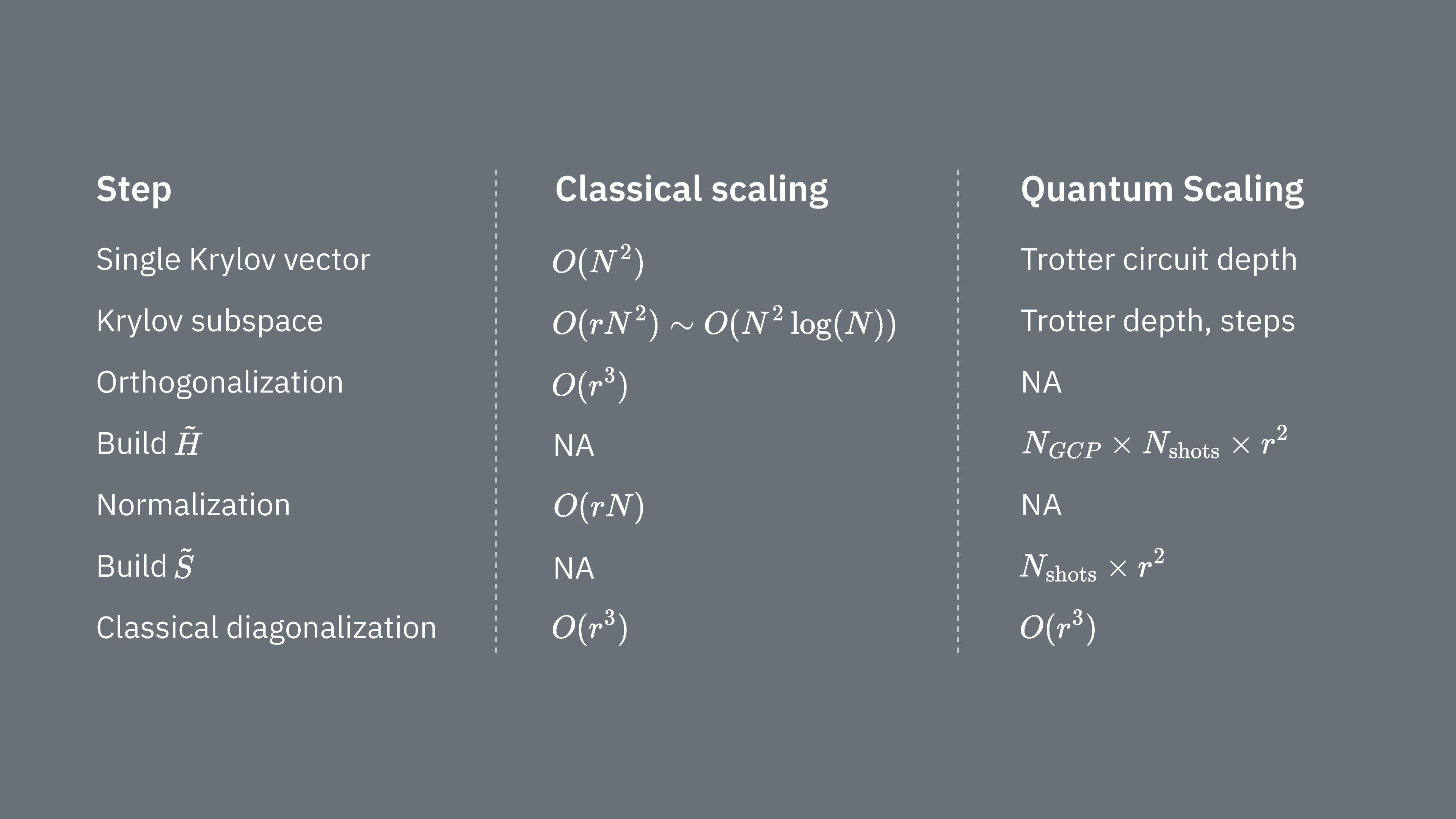

Let us review our progress so far:
  • For very large matrices, the Krylov subspace method may yield approximate eigenvalues within required tolerances faster than traditional diagonalization algorithms.
  • For such very large matrices, the generation of a Krylov subspace is the most time-consuming part of the Krylov subspace method.
  • Thus an efficient way of generating a Krylov subspace would be highly valuable. This is finally where quantum computer comes into the picture.

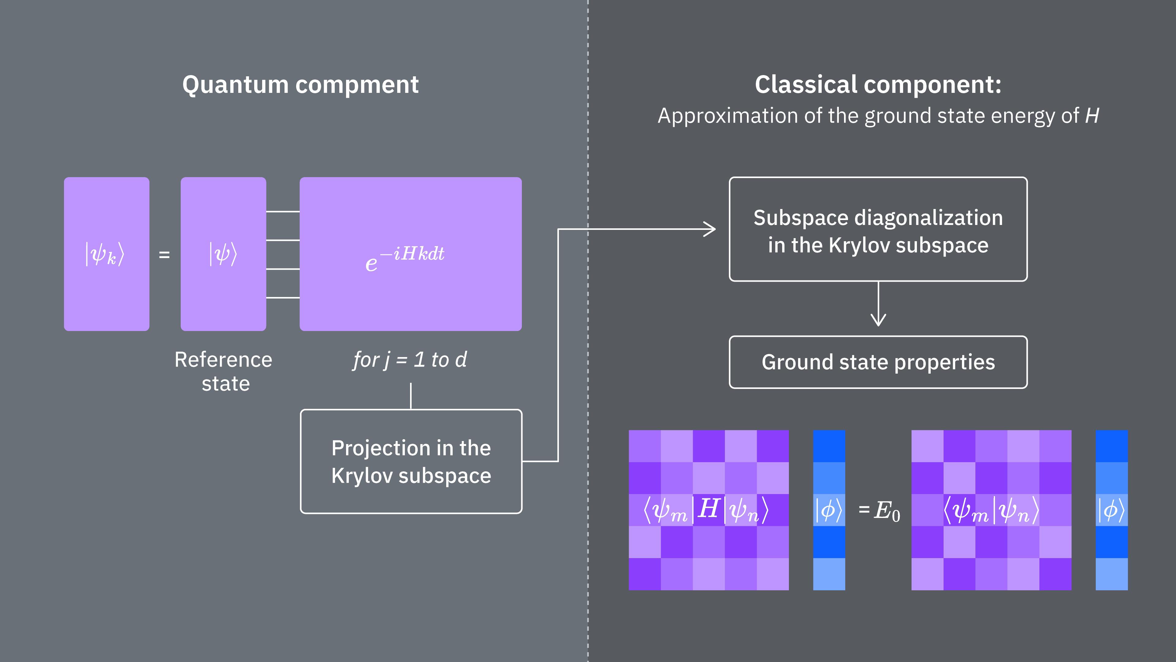

We can project our Hamiltonian H on to the unitary Krylov subspace, KUr\mathcal{K}_U^r. In other words, we calculate each matrix element of HH in the KUr\mathcal{K}_U^r basis. We'll refer to this projected matrix as H~\tilde{H}.
3.2 How to implement on a quantum computer
The matrix elements of H~\tilde{H} are given by the expectation values ⟨ψm∣H∣ψn⟩\langle \psi_m |H| \psi_n\rangle, which can be estimated using the quantum computer. Keep in mind that HH can be written as a sum of Pauli operators on different qubits, and that not all the Pauli operators can be measured simultaneously. We can sort the Pauli terms into groups of commuting terms, and measure all those at once. But we may need many such groups to cover all the terms. So the number of distinct commuting groups into which the terms can be partitioned, NGCPN_\text{GCP} becomes important.
H=∑α=1NGCPcαPαH=\sum_{\alpha=1}^{N_\text{GCP}} c_\alpha P_\alpha
Here PαP_\alpha is a Pauli string of the form Pα∼IZIXII...YZXIXP_\alpha \sim IZIXII...YZXIX or a set of such Pauli strings that commute with one another. Given that we can write HH as such a sum of measureable operators, the following expressions for matrix elements of H~\tilde{H} can be realized using the IBM Quantum® primitive Estimator.
H~mn=⟨ψm∣H∣ψn⟩=⟨ψeiHtm∣H∣ψe−iHtn⟩=⟨ψeiHmdt∣H∣ψe−iHndt⟩\begin{aligned} \tilde{H}_{mn}&=\langle \psi_m |H| \psi_n\rangle\\ &=\langle \psi e^{iHt_m} |H| \psi e^{-iHt_n}\rangle\\ &=\langle \psi e^{iHmdt} |H|\psi e^{-iHndt}\rangle \end{aligned}
Where ∣ψn⟩=e−iHtn∣ψ⟩\vert \psi_n \rangle = e^{-i H t_n} \vert \psi \rangle are the vectors of the unitary Krylov space and tn=ndtt_n = n dt are the multiples of the time step dtdt chosen. On a quantum computer, the calculation of each matrix elements can be done with any algorithm which allows us to obtain overlap between quantum states. In this lesson we'll focus on the Hadamard test. Given that the KU\mathcal{K}_U has dimension rr, the Hamiltonian projected into the subspace will have dimensions r×rr \times r. With rr small enough (generally r<<100r<<100 is sufficient to obtain convergence of estimates of eigenvalues) we can then easily diagonalize the projected Hamiltonian H~\tilde{H}, classically. However, we cannot directly diagonalize H~\tilde{H} because of the non-orthogonality of the Krylov space vectors. We'll have to measure their overlaps and construct a matrix S~\tilde{S}
S~mn=⟨ψm∣ψn⟩\tilde{S}_{mn} = \langle \psi_m \vert \psi_n \rangle
This allows us to solve the eigenvalue problem in a non-orthogonal space (also called generalized eigenvalue problem)
H~ c⃗=E S~ c⃗\tilde{H} \ \vec{c} = E \ \tilde{S} \ \vec{c}
One can then obtain estimates of the eigenvalues and eigenstates of HH by looking at the solutions of this generalized eigenvalue problem. For example, the estimate of the ground state energy is obtained by taking the smallest eigenvalue EE and the ground state from the corresponding eigenvector c⃗\vec{c}. The coefficients in c⃗\vec{c} determines the contribution of the different vectors that span KU\mathcal{K}_U.

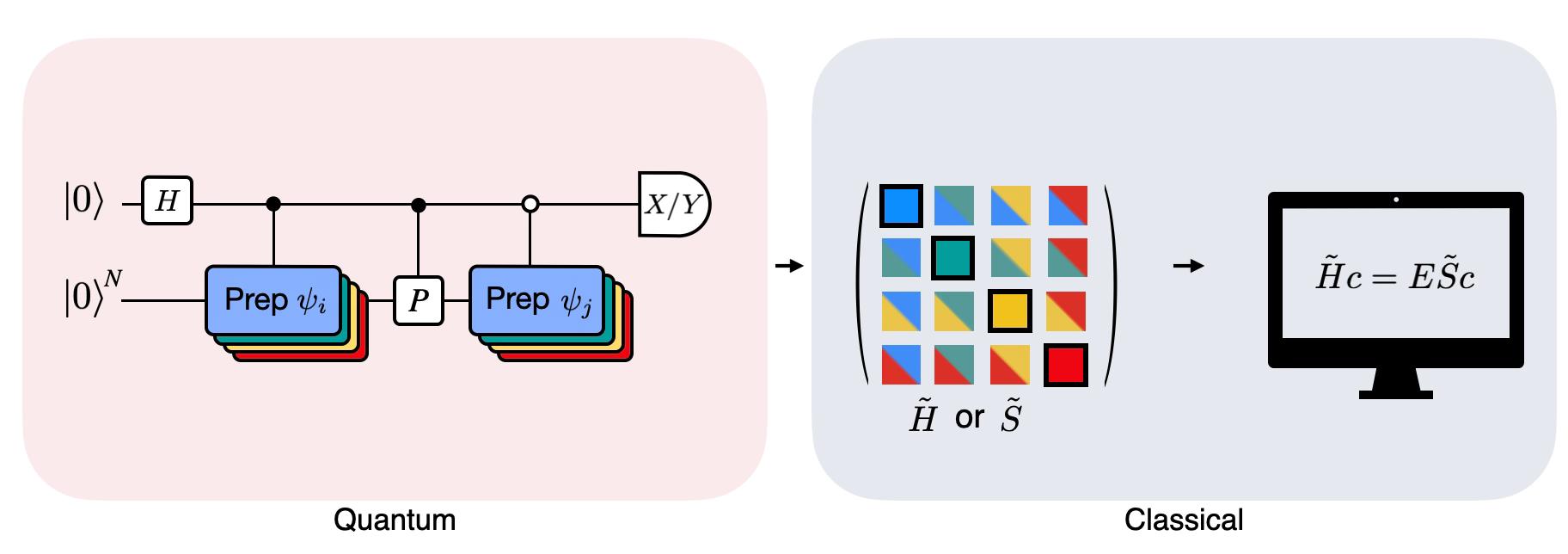

Generalized eigenvalue problem

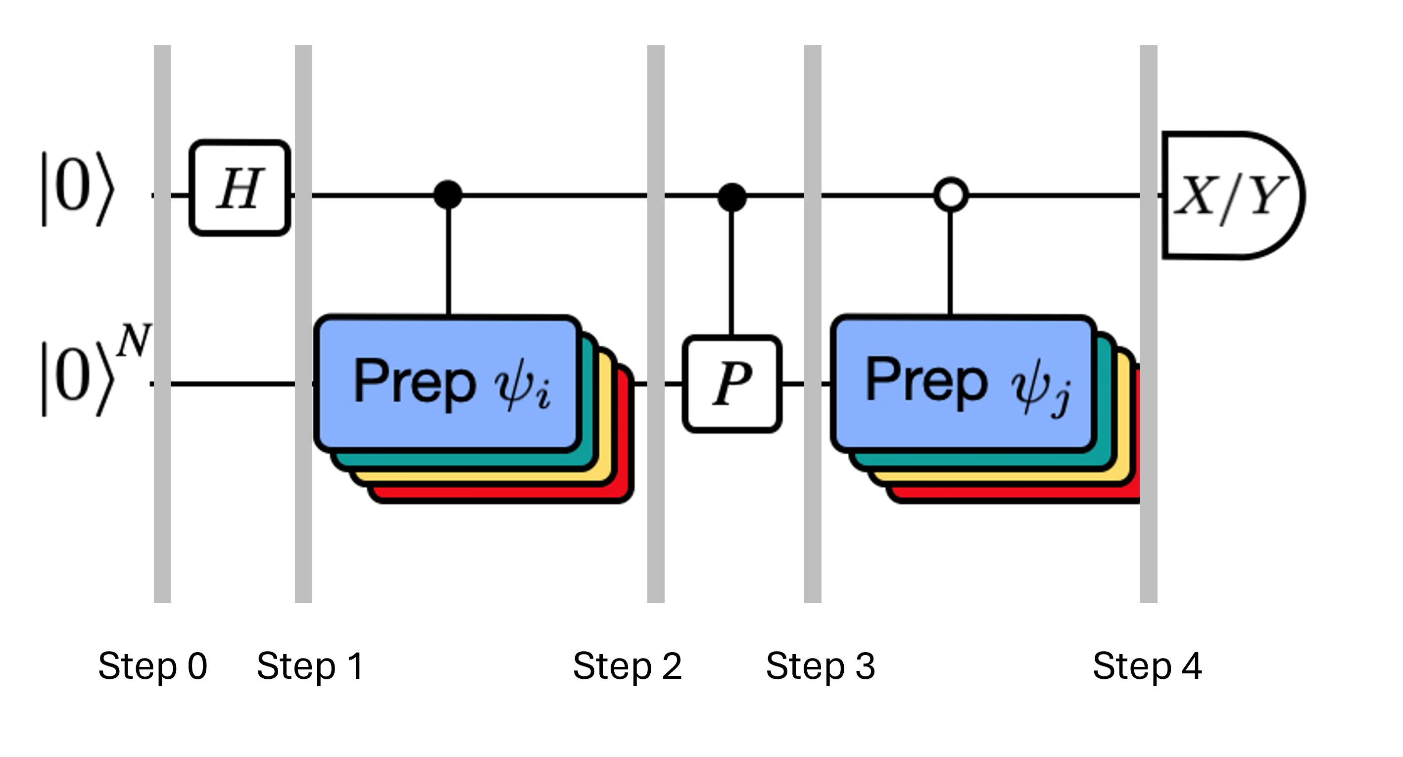

Why can we not simply diagonalize H~\tilde{H}? Since S~\tilde{S} contains the information about the geometry of the Krylov basis (which is nonorthogonal in all but very special cases), H~\tilde{H} on its own does not describe a projection of the full Hamiltonian, so its eigenvalues have no particular relation to those of the full Hamiltonian -- they could be any random values. Solving the generalized eigenvalue problem is required to obtain the approximate eigenvalues and eigenvectors corresponding to the projection of the full Hamiltonian into the Krylov space..
A circuit diagram with many layers indicating that the circuit must be used many times with different states to perform the modified Hadamard test.
The Figure shows a circuit representation of the modified Hadamard test, a method that is used to compute the overlap between different quantum states. For each matrix element H~i,j\tilde{H}_{i,j}, a Hadamard test between the state ∣ψi⟩\vert \psi_i \rangle, ∣ψj⟩\vert \psi_j \rangle is carried out. This is highlighted in the figure by the color scheme for the matrix elements and the corresponding Prep  ψi\text{Prep} \; \psi_i, Prep  ψj\text{Prep} \; \psi_j operations. Thus, a set of Hadamard tests for all the possible combinations of Krylov space vectors is required to compute all the matrix elements of the projected Hamiltonian H~\tilde{H}. The top wire in the Hadamard test circuit is an ancilla qubit which is measured either in the X or Y basis, its expectation value determines the value of the overlap between the states. The bottom wire represents all the qubits of the system Hamiltonian. The Prep  ψi\text{Prep} \; \psi_i operation prepares the system qubit in the state ∣ψi⟩\vert \psi_i \rangle controlled by the state of the ancilla qubit (similarly for Prep  ψj\text{Prep} \; \psi_j) and the operation PP represents Pauli decomposition of the system Hamiltonian H=∑iPiH = \sum_i P_i. The implementation of this is on a quantum computer is shown in greater detail below.

We specify the number of Trotter steps to use in the time evolution. We also specify a maximum Krylov dimension of 4. This Krylov dimension is not large enough for realistic applications. But it is sufficient for this example. Furthermore, we will check for convergence at even smaller dimensions. We will explore methods in later lessons that allow us to scale and project our Hamiltonians onto larger subspaces.
# Set parameters for quantum Krylov algorithm
krylov_dim = 4  # size of krylov subspace
num_trotter_steps = 4
dt_circ = dt / num_trotter_steps
State preparation
Pick a reference state ∣ψ⟩\vert \psi \rangle that has some overlap with the ground state. For this Hamiltonian, We use the a state with an excitation in the middle qubit ∣00..010...00⟩\vert 00..010...00 \rangle as our reference state.
qc_state_prep = QuantumCircuit(n_qubits)
qc_state_prep.x(int(n_qubits / 2) + 1)
qc_state_prep.draw("mpl", scale=0.5)
Output:
Output of the previous code cell

Hadamard test
Recall that we wish to calculate the matrix elements of both H~\tilde{H} and the Gram matrix S~\tilde{S} using the Hadamard test. Let's review how this works in this context, focusing first on the construction of H~\tilde{H}. The overall process is depicted graphically below. The layers of colored state preparation blocks Prep∣ψi⟩\text{Prep}|\psi_i\rangle serve as a reminder that this process is carried out for all combinations of ∣ψi⟩|\psi_i\rangle and ∣ψj⟩|\psi_j\rangle in our subspace.
An image of a quantum circuit diagram with many layers indicating that the circuit must be evaluated for many different states in order to perform the Hadamard test.
The states of the system at the steps indicated are:
Step 0:∣Ψ⟩=∣0⟩∣0⟩NStep 1:∣Ψ⟩=12(∣0⟩+∣1⟩)∣0⟩NStep 2:∣Ψ⟩=12(∣0⟩∣0⟩N+∣1⟩∣ψi⟩)Step 3:∣Ψ⟩=12(∣0⟩∣0⟩N+∣1⟩P∣ψi⟩)Step 4:∣Ψ⟩=12(∣0⟩∣ψj⟩+∣1⟩P∣ψi⟩)\begin{aligned} \text{Step 0:}\qquad|\Psi\rangle & = |0\rangle|0\rangle^N \\ \text{Step 1:}\qquad|\Psi\rangle & = \frac{1}{\sqrt{2}}\Big(|0\rangle + |1\rangle \Big)|0\rangle^N \\ \text{Step 2:}\qquad|\Psi\rangle & = \frac{1}{\sqrt{2}}\Big(|0\rangle|0\rangle^N+|1\rangle |\psi_i\rangle\Big)\\ \text{Step 3:}\qquad|\Psi\rangle & = \frac{1}{\sqrt{2}}\Big(|0\rangle |0\rangle^N+|1\rangle P |\psi_i\rangle\Big) \\ \text{Step 4:}\qquad|\Psi\rangle & = \frac{1}{\sqrt{2}}\Big(|0\rangle |\psi_j\rangle+|1\rangle P|\psi_i\rangle\Big) \end{aligned}
Here PP is a Pauli term in the decomposition of the Hamiltonian (note that it cannot be a linear combination of multiple commuting Pauli terms since that would not be unitary -- grouping is possible using a different construction we will show later) Prep  ψi\text{Prep} \; \psi_i, Prep  ψj\text{Prep} \; \psi_j are controlled operations that prepare ∣ψi⟩|\psi_i\rangle, ∣ψj⟩|\psi_j\rangle vectors of the unitary Krylov space, with ∣ψk⟩=e−iHkdt∣ψ⟩=e−iHkdtUψ∣0⟩N|\psi_k\rangle = e^{-i H k dt } \vert \psi \rangle = e^{-i H k dt } U_{\psi} \vert 0 \rangle^N. Applying measurements of XX and YY to this circuit calculates the real and imaginary parts, respectively, of the matrix elements we require.
Starting from Step 4 above, apply the Hadamard gate HH to the zeroth qubit.
∣Ψ⟩⟶12∣0⟩(∣ψj⟩+P∣ψi⟩)+12∣1⟩(∣ψj⟩−P∣ψi⟩)\begin{equation*} |\Psi\rangle \longrightarrow\quad\frac{1}{2}|0\rangle\Big( |\psi_j\rangle + P|\psi_i\rangle\Big) + \frac{1}{2}|1\rangle\Big(|\psi_j\rangle - P|\psi_i\rangle\Big) \end{equation*}
Then measure either XX or YY.
⇒⟨X⟩=14(∥∣ψj⟩+P∣ψi⟩∥2−∥∣ψj⟩−P∣ψi⟩∥2)=Re[⟨ψj∣P∣ψi⟩].\begin{equation*} \begin{split} \Rightarrow\quad\langle X\rangle &= \frac{1}{4}\Bigg(\Big\|| \psi_j\rangle + P|\psi_i\rangle \Big\|^2-\Big\||\psi_j\rangle - P|\psi_i\rangle\Big\|^2\Bigg) \\ &= \text{Re}\Big[\langle\psi_j| P|\psi_i\rangle\Big]. \end{split} \end{equation*}
From the identity ∣a+b∥2=⟨a+b∣a+b⟩=∥a∥2+∥b∥2+2Re⟨a∣b⟩|a + b\|^2 = \langle a + b | a + b \rangle = \|a\|^2 + \|b\|^2 + 2\text{Re}\langle a | b \rangle. Similarly, measuring YY yields
⟨Y⟩=Im[⟨ψj∣P∣ψi⟩].\begin{equation*} \langle Y\rangle = \text{Im}\Big[\langle\psi_j| P|\psi_i\rangle\Big]. \end{equation*}

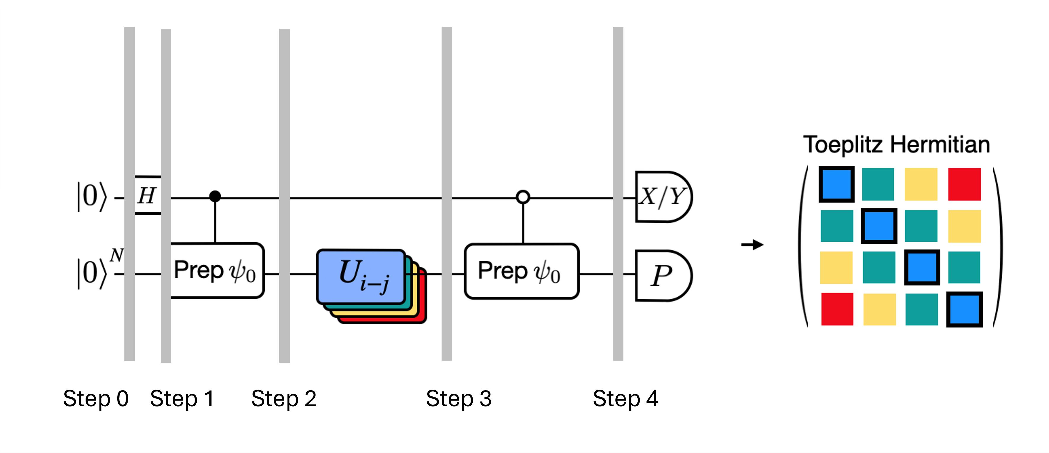

Efficient Hadamard test
We can optimize the deep circuits for the Hadamard test that we have obtained by introducing some approximations and relying on some assumption about the model Hamiltonian. For example, consider the following circuit for the Hadamard test:
An image of a quantum circuit diagram with many layers indicating that the circuit must be evaluated for many different unitary operators in order to perform the modified, efficient Hadamard test.
Assume we can classically calculate E0E_0, the eigenvalue of ∣0⟩N|0\rangle^N under the Hamiltonian HH. This is satisfied when the Hamiltonian preserves the U(1) symmetry. Although this may seem like a strong assumption, there are many cases where it is safe to assume that there is a vacuum state (in this case it maps to the ∣0⟩N|0\rangle^N state) which is unaffected by the action of the Hamiltonian. This is true for example for chemistry Hamiltonians that describe stable molecule (where the number of electrons is conserved). Given that the gate Prep  ψ0\text{Prep} \; \psi_0, prepares the desired reference state ∣ψ0⟩=Prep  ψ0∣0⟩=e−iH0dtUψ0∣0⟩\ket{\psi_0} = \text{Prep} \; \psi_0 \ket{0} = e^{-i H 0 dt} U_{\psi_0} \ket{0}, for example, to prepare the HF state for chemistry Prep  ψ0\text{Prep} \; \psi_0 would be a product of single-qubit NOTs, so controlled-Prep  ψ0\text{Prep} \; \psi_0 is just a product of CNOTs. Then the circuit above implements the following state prior to measurement:
Step 0:∣Ψ⟩=∣0⟩∣0⟩NStep 1:∣Ψ⟩=12(∣0⟩∣0⟩N+∣1⟩∣0⟩N)Step 2:∣Ψ⟩=12(∣0⟩∣0⟩N+∣1⟩∣ψ0⟩)Step 3:∣Ψ⟩=12(eiϕ∣0⟩∣0⟩N+∣1⟩U∣ψ0⟩)Step 4:∣Ψ⟩=12(eiϕ∣0⟩∣ψ0⟩+∣1⟩U∣ψ0⟩)=12(∣+⟩(eiϕ∣ψ0⟩+U∣ψ0⟩)+∣−⟩(eiϕ∣ψ0⟩−U∣ψ0⟩))=12(∣+i⟩(eiϕ∣ψ0⟩−iU∣ψ0⟩)+∣−i⟩(eiϕ∣ψ0⟩+iU∣ψ0⟩))\begin{aligned} \text{Step 0:}\qquad|\Psi\rangle & = \ket{0} \ket{0}^{N}\\ \text{Step 1:}\qquad|\Psi\rangle & = \frac{1}{\sqrt{2}}\left(\ket{0}\ket{0}^N+ \ket{1} \ket{0}^N\right)\\ \text{Step 2:}\qquad|\Psi\rangle & = \frac{1}{\sqrt{2}}\left(|0\rangle|0\rangle^N+|1\rangle|\psi_0\rangle\right)\\ \text{Step 3:}\qquad|\Psi\rangle & = \frac{1}{\sqrt{2}}\left(e^{i\phi}\ket{0}\ket{0}^N+\ket{1} U\ket{\psi_0}\right)\\ \text{Step 4:}\qquad|\Psi\rangle & = \frac{1}{\sqrt{2}}\left(e^{i\phi}\ket{0} \ket{\psi_0}+\ket{1} U\ket{\psi_0}\right)\\ & = \frac{1}{2}\left(\ket{+}\left(e^{i\phi}\ket{\psi_0}+U\ket{\psi_0}\right)+\ket{-}\left(e^{i\phi}\ket{\psi_0}-U\ket{\psi_0}\right)\right)\\ & = \frac{1}{2}\left(\ket{+i}\left(e^{i\phi}\ket{\psi_0}-iU\ket{\psi_0}\right)+\ket{-i}\left(e^{i\phi}\ket{\psi_0}+iU\ket{\psi_0}\right)\right) \end{aligned}
where we have used the classical simulable phase shift U∣0⟩N=eiϕ∣0⟩N U\ket{0}^N = e^{i\phi}\ket{0}^N from step 2 to 3. Therefore the expectation values are
⟨X⊗P⟩=14((e−iϕ⟨ψ0∣+⟨ψ0∣U†)P(eiϕ∣ψ0⟩+U∣ψ0⟩)−(e−iϕ⟨ψ0∣−⟨ψ0∣U†)P(eiϕ∣ψ0⟩−U∣ψ0⟩))=Re[e−iϕ⟨ψ0∣PU∣ψ0⟩],\begin{aligned} \langle X\otimes P\rangle&=\frac{1}{4} \Big( \left(e^{-i\phi}\bra{\psi_0}+\bra{\psi_0}U^\dagger\right)P\left(e^{i\phi}\ket{\psi_0}+U\ket{\psi_0}\right) \\ &\qquad-\left(e^{-i\phi}\bra{\psi_0}-\bra{\psi_0}U^\dagger\right)P\left(e^{i\phi}\ket{\psi_0}-U\ket{\psi_0}\right) \Big)\\ &=\text{Re}\left[e^{-i\phi}\bra{\psi_0}PU\ket{\psi_0}\right], \end{aligned} ⟨Y⊗P⟩=14((e−iϕ⟨ψ0∣+i⟨ψ0∣U†)P(eiϕ0∣ψ0⟩−iU∣ψ0⟩)−(e−iϕ⟨ψ0∣−i⟨ψ0∣U†)P(eiϕ∣ψ0⟩+iU∣ψ0⟩))=Im[e−iϕ⟨ψ0∣PU∣ψ0⟩]. \begin{aligned} \langle Y\otimes P\rangle&=\frac{1}{4} \Big( \left(e^{-i\phi}\bra{\psi_0}+i\bra{\psi_0}U^\dagger\right)P\left(e^{i\phi_0}\ket{\psi_0}-iU\ket{\psi_0}\right) \\ &\qquad-\left(e^{-i\phi}\bra{\psi_0}-i\bra{\psi_0}U^\dagger\right)P\left(e^{i\phi}\ket{\psi_0}+iU\ket{\psi_0}\right) \Big)\\ &=\text{Im}\left[e^{-i\phi}\bra{\psi_0}PU\ket{\psi_0}\right]. \end{aligned}
Using these assumptions we were able to write the expectation values of operators of interest with fewer controlled operations. In fact, we only need to implement the controlled state preparation Prep  ψ0\text{Prep} \; \psi_0 and not controlled time evolutions. Reframing our calculation as above will allow us to greatly reduce the depth of the resulting circuits.
Note that as a bonus, since the Pauli operator now appears as a measurement at the end of the circuit rather than as a controlled gate in the middle, it can be measured alongside other commuting Pauli operators as in the decomposition H=∑α=1NGCPcαPαH=\sum_{\alpha = 1}^{N_\text{GCP}}c_\alpha P_\alpha given above.

To recap, we start with a reference state, then evolve it for different periods of time to generate the unitary Krylov subspace. We project our Hamiltonian onto that subspace. We also estimate the overlaps of the subspace vectors. Finally we solve the lower-dimensional, generalized eigenvalue problem classically.
A flow-chart overview of QKD: start with a reference state, evolve the state to approximate Krylov vectors, project into the Krylov subspace, diagonalize the projected subspace classically, and determine ground state properties.
Let’s compare what determines computational costs of using the Krylov technique classically and quantum mechanically. There are not perfect analogs between classical and quantum approaches for all steps. This table collects some scaling of different steps for consideration.
A table describing scaling of different processes classically and in the quantum approach to Krylov methods. Some quantum steps have no analog. The scalings are the same as those stated in text.
Recall that Hamiltonians generally have terms that cannot be simultaneously measured (because they do not commute with on another). We sort terms in the Hamiltonian into groups of commuting Pauli operators that can all be measured simultaneously, and we may require many such groups to account for all the terms that do not commute with one another. To build up H~\tilde{H} on a quantum computer requires separate measurements for each group of commuting Pauli strings in the Hamiltonian, and each of those requires many shots. We must do this for r2r^2 different matrix elements, corresponding to r2r^2 combinations of different time evolution factors. There are sometimes ways to reduce this, but in this rough treatment, the time required for this scales like Nshots×NGCP×r2N_\text{shots}\times N_\text{GCP} \times r^2. The elements of SS must be estimated, which scales like O(Nshots×r2)O(N_\text{shots}\times r^2). Finally, solving the generalized eigenvalue problem in the projected space, classically, takes O(r3)O(r^3).
We see that quantum Krylov diagonalization may be useful in cases where the number of commuting Pauli groups in the Hamiltonian is relatively small. These scaling dependencies suggest some applications where the Krylov method can be useful, and others where it likely will not be. Some Hamiltonians have high complexity when mapped to qubits, involving many non-commuting Pauli strings that cannot easily be partitioned into a few commuting groups. This is often true of quantum chemistry problems, for example. This complexity presents two primary challenges for near-term quantum computers:
  • The estimation of each element of H~\tilde{H} becomes computationally expensive due to the large number of terms.
  • The required Trotter circuits become prohibitively deep.
Both of the above points will be less problematic when quantum computers reach fault-tolerance, but they must be considered in the near term. Even systems with “simpler” mappings than those in quantum chemistry may experience the same impediments, if the Hamiltonians have too many non-commuting terms. The Krylov method is most useful where the Hamiltonian can be partitioned into relatively few commuting Pauli groups, and where HH is easy to implement in trotter circuits. Both of these conditions are satisfied, for example, for many lattice models of interest in physics. KQD is especially useful if very little is known about the ground state. This stems from its inherent convergence guarantees and its applicability in scenarios where alternative methods are untenable due to insufficient ground state knowledge.
While KQD is a powerful tool, the protocol's time-consuming aspects, particularly the estimation of each element of the projected Hamiltonian and the overlap of Krylov states, represent opportunities for improvement. An alternative approach involves leveraging Krylov methods in conjunction with sampling-based methods, which are the subject of the next lesson.
