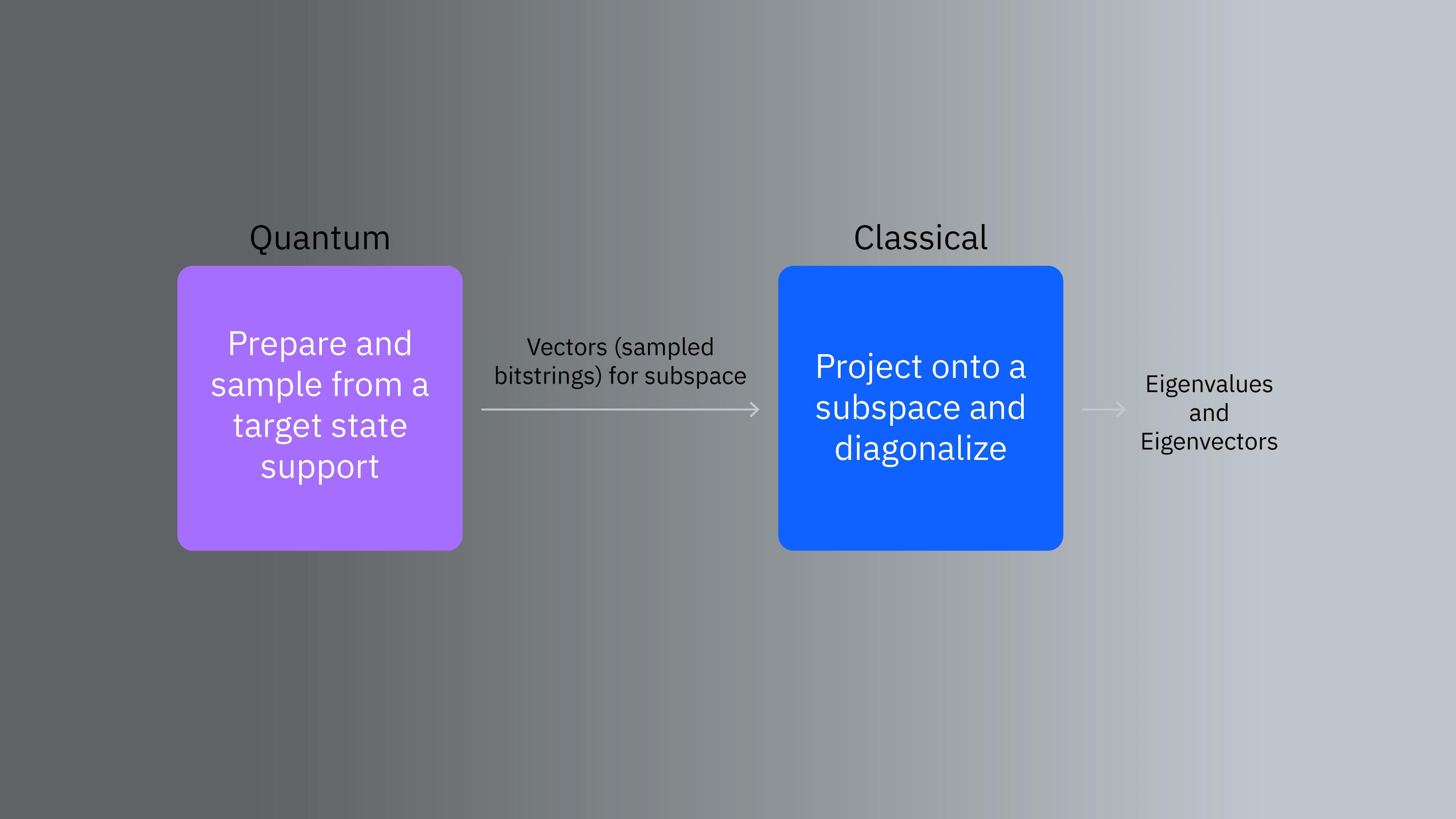

3. Role of quantum in SQD
Above analyses establish the importance of subspace spanning vectors, which must be in support of the target state. This raises an important question: How do we choose vectors with target state support for subspace construction?
This is where quantum computers come into play. The quantum-classical synergy works as follows in the SQD paradigm:
  1. Using a suitable quantum circuit, we try to prepare a state on a quantum computer that will generate basis states on which the target wave function (for example, ground state) has significant support. The sampled basis states (bitstrings) will span the subspace for Hamiltonian projection.
  2. A classical computer projects the Hamiltonian on to the subspace (spanned by samples/vectors from the quantum computer) and diagonalizes it to compute eigenvalues and eigenvectors using suitable numerical methods.
A diagram of quantum and classical components of SQD. In quantum, you prepare and sample from your target support, you classically project your matrix onto the sampled subspace and diagonalize your projected matrix.

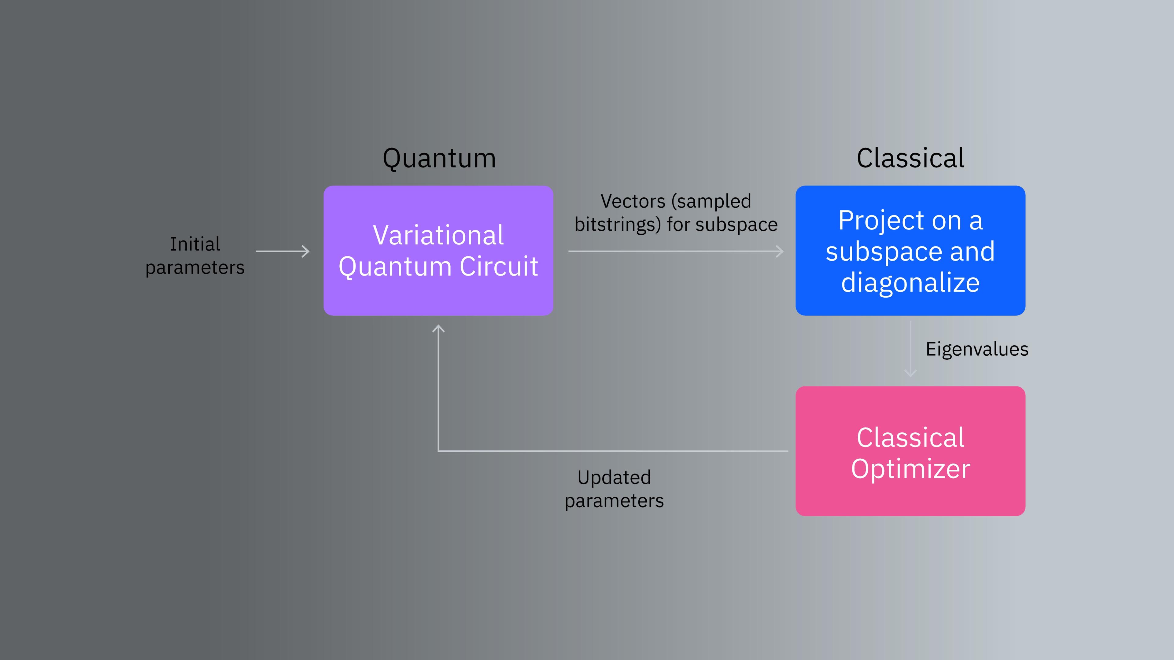

Besides the problem-specific approaches above, a generic approach for state preparation involves a variational ansatz, where we will iteratively update ansatz parameters using a classical optimizer.
A flow chart from a variational quantum circuit through quantum sampling over to classical computing in which the matrix is projected and diagonalized. Then the results are fed into a classical optimizer which selects new variational parameters, and we return to the variational quantum circuit.
Samples from pre-fault tolerant quantum computers can be noisy. SQD employs a self-consistent configuration recovery process to correct noisy samples [1]. We will discuss the configuration recovery process in more detail and apply it for correcting noisy samples iteratively to refine the ground state energy estimation for an chemistry problem in Lesson 4.

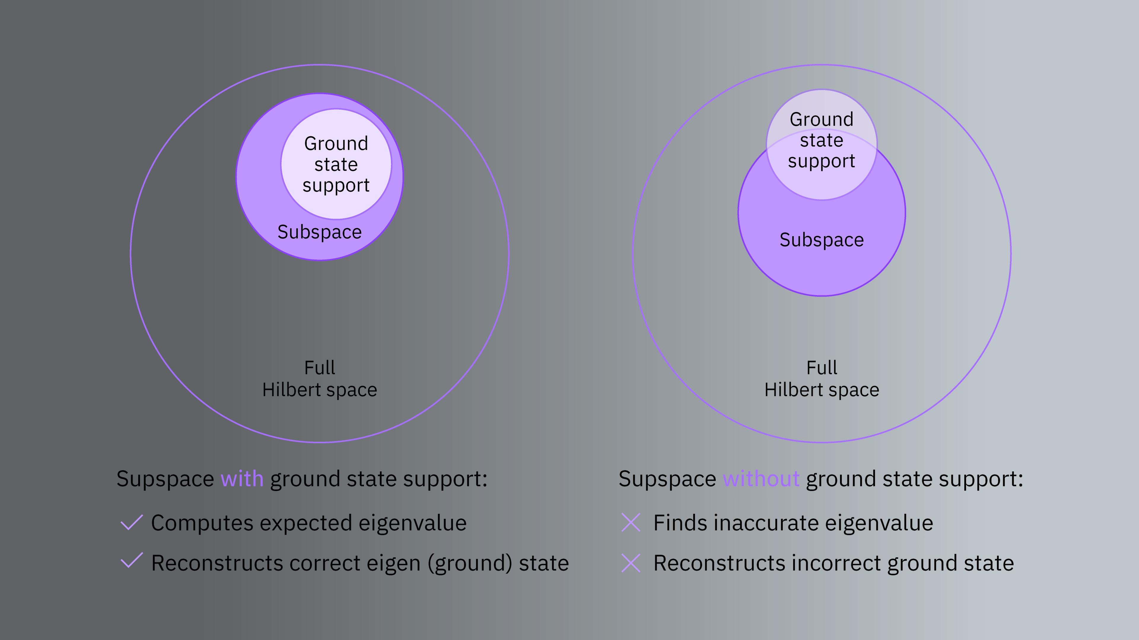

3.1 Notes on ground state support
Let us explain the concept of ground state support more. Ground state support can be defined as the set of basis states where ground state has non-zero amplitude (up to a cutoff threshold).
Suppose the exact ground state of a 33-qubit problem is
∣ψ⟩=12∣000⟩+12∣111⟩\vert \psi \rangle = \frac{1}{\sqrt{2}} \vert 000 \rangle + \frac{1}{\sqrt{2}} \vert 111 \rangle
If we sample the above state, we should get a set of computational basis states {∣000⟩\{\vert 000 \rangle, ∣111⟩}\vert 111 \rangle \} (other computational basis states have zero amplitude in the ground state, and therefore, ideally will not appear during sampling).
Ideally, the set of basis vectors for this states consists of {∣000⟩,∣111⟩}\{ \vert 000 \rangle, \vert 111 \rangle \} (in other words, the subspace of this state is spanned by these two basis vectors).
In practice, we do not need to prepare the exact ground state as sampling many other states can give us the same set of vectors. For example:
∣ψa⟩=0.8∣000⟩+0.6∣111⟩→Sampling{∣000⟩,∣111⟩}∣ψb⟩=12∣000⟩+32∣111⟩→Sampling{∣000⟩,∣111⟩}∣ψc⟩=12∣000⟩+12∣111⟩+12∣101⟩→Sampling{∣000⟩,∣101⟩,∣111⟩}\begin{align} \vert \psi_a \rangle = 0.8 \vert 000 \rangle + 0.6 \vert 111 \rangle &\xrightarrow{\text{Sampling}} \{ \vert 000 \rangle, \vert 111 \rangle \} \\ \vert \psi_b \rangle = \frac{1}{2} \vert 000 \rangle + \frac{\sqrt{3}}{2} \vert 111 \rangle &\xrightarrow{\text{Sampling}} \{ \vert 000 \rangle, \vert 111 \rangle \} \\ \vert \psi_c \rangle = \frac{1}{2} \vert 000 \rangle + \frac{1}{2} \vert 111 \rangle + \frac{1}{\sqrt{2}} \vert 101 \rangle &\xrightarrow{\text{Sampling}} \{ \vert 000 \rangle, \vert 101 \rangle, \vert 111 \rangle \} \end{align}
Preparing and sampling from any of the above states will generate vectors that have non-zero amplitude in the ground state, and all of them qualify as to have ground state support. Note that, sampling ∣ψc⟩\vert \psi_c \rangle includes one extra vector ∣101⟩\vert 101 \rangle which has 00 amplitude in the exact ground state. However, earlier we have shown that including such vectors in the subspace is not problematic as the projection and diagonalization operation sets the amplitude of unwanted vectors to 00, and we can get expected eigenvalue and reconstruct the correct eigenstate.
Diagrams of good and bad ansatz supports. A good ansatz has support that completely contains the ground state support. A poor ansatz contains only part or none of the ground state support.
Thus, preparing and sampling from the exact ground state is not necessary. In fact, doing so can be difficult as the exact ground state is not known a priori, and it is often beneficial to not prepare and sample from the exact ground state, especially if the wave function (state) is skewed with some basis states having very high probabilities. Consider the following wave function:
∣ψ⟩=0.7∣000⟩−0.7∣010⟩+0.1∣101⟩−0.01∣111⟩\vert \psi \rangle = 0.7 \vert 000 \rangle - 0.7 \vert 010 \rangle + 0.1 \vert 101 \rangle - 0.01 \vert 111 \rangle
This is a skewed wave function where basis states ∣000⟩\vert 000 \rangle and ∣010⟩\vert 010 \rangle have much larger amplitudes compared to ∣101⟩\vert 101 \rangle and ∣111⟩\vert 111 \rangle. When sampled, we will get ∣000⟩\vert 000 \rangle and ∣010⟩\vert 010 \rangle more frequently (sampling probability=∣amplitude∣2\text{sampling probability} = \vert \text{amplitude} \vert^{2} ≈49%\approx 49\% for ∣000⟩\vert 000 \rangle and ∣010⟩\vert 010 \rangle each, ≈1%\approx 1\% for ∣101⟩\vert 101 \rangle, and ≈0.01%\approx 0.01\% for ∣111⟩\vert 111 \rangle). With finite sampling budget (shots), it is highly likely that our sampled set only contains ∣000⟩\vert 000 \rangle and ∣010⟩\vert 010 \rangle. As shown earlier, if we span the subspace with such a set with missing vectors, we will not be able to find the true minimum eigenvalue. Therefore, it will be beneficial (and necessary) to sample from a state with ground state support.

The above example shows that when the wave function is broad, and we do not include basis states in the subspace, the eigenvalue computation becomes incorrect.
5. SQD vs. VQE
As noted earlier, SQD may need a variational quantum circuit and iterative parameter updates to prepare and sample from ground state support. As this iterative parameter update routine is similar to VQE, one can ask how these methods are different, and what are the advantages of SQD over VQE? In this section, we compare the methods and discuss advantages of SQD with a N2N_2 molecule described with minimal basis set (sto-3g) as an example.
VQE
SQD
Measurement overheadMany Pauli terms, many measurement circuits: The Hamiltonian for the molecule has 29512951 unique Pauli terms. As the Pauli terms can contain XX and YY terms, and typical quantum measurements are done in the ZZ-basis, we need measurement basis change to evaluate those terms. When optimized for measurements, the 29512951 terms can be grouped into 11871187 groups, where each group can be evaluated using a single circuit. Thus, we need at least 11871187 unique circuits to evaluate all Pauli terms. Many shots per circuit for tighter variance. Again, the evaluated expectation value of each Pauli term has a variance attached to them which depends inversely on the shots\sqrt{shots}. Therefore, to accurately estimate each term, we need to allocate many shots per circuit. For example, to achieve chemical accuracy (11 kcal/mol), typically we need shots in the order of 10510^5-10710^7 per circuit. Thus, VQE needs many measurement circuits and each circuit with certain number of shots. For practical cases, this measurement overhead can be restrictive.In SQD, we do not need different measurement circuits for each grouped Pauli terms. Typically, we measure a single circuit for a fixed number of shots. While we may set the number of shots to a large value depending on the problem, the overhead remains much smaller than VQE. Also, the energy estimations using diagonalization process are exact, meaning the computed eigenvalues are exact in that subspace and does not have a variance attached to them like VQE. (In case of Krylov basis state sampling (Lesson 5), we need to measure multiple circuits, but the number circuit remains much smaller than VQE).
Estimated energy boundIn VQE, energy estimations are not bounded and can be lower than true minimum values due to noise.The energy estimation process in SQD always produces upper bound to ground state energy and estimated energy will never be lower than the true ground state energy.
Noise toleranceVQE energy estimation is susceptible to noise from pre-fault-tolerant quantum computers.SQD has inherent tolerance to noise. Pre-fault-tolerant quantum computers can produce noisy samples. Even if we include those samples in the subspace, the subsequent diagonalization can suppress those samples by setting their amplitudes to zero. Also, we will discuss a method called configuration recovery in relation to SQD that improves SQD noise tolerance further.

  1. In SQD, a quantum computer generate samples and a classical computer projects a Hamiltonian onto a subspace spanned by the samples and diagonalizes it to compute eigenvalues and eigenvectors.
  2. The generated samples should be from the target (ground) state support.
  3. Depending on the problem, the quantum state preparation and sample generation flow can be iterative or non-iterative.
  4. SQD works best for sparse wave functions. A broad wave function will require a large subspace for accurate solutions, which makes classical projection and diagonalization operation costly.
  5. SQD has several advantages over VQE such as lower measurement overhead and upper bound to estimated ground state energy, which make it more scalable.
