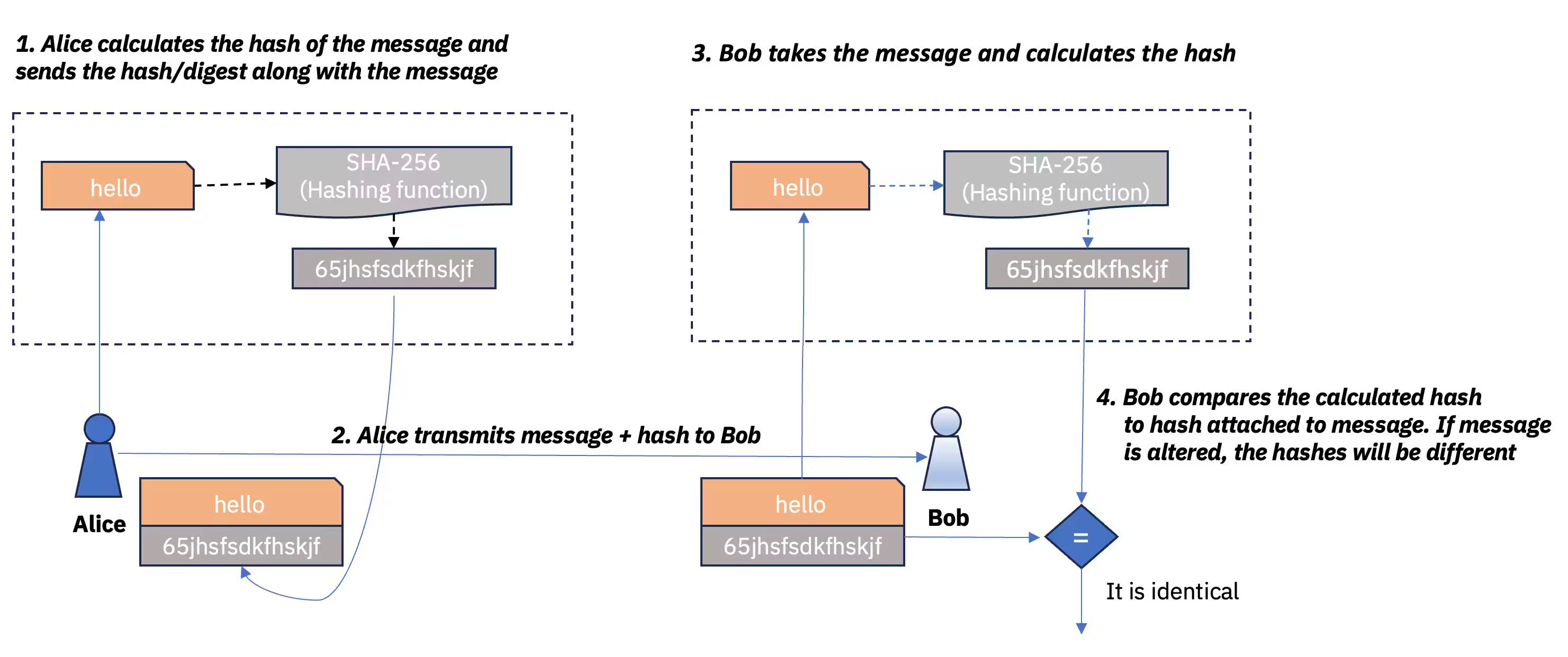

  • Data integrity checks: Hash functions can be used to create a Commonly used technique in cryptography to detect errors during data transmission involving adding a value(which is often derived from the data itself) to the data to create a checksum value. The recipient can then perform the same calculation to compare checksums to verify authenticity. for a set of data. Any modifications to the data, intentional or not, will result in a different checksum, alerting systems or users to the change. The checksum is also typically much more compact than the original data, which makes checksum comparisons very fast.
Fig 1: Secure hashing for data integrity checks
Figure 1. Secure hashing for data integrity
