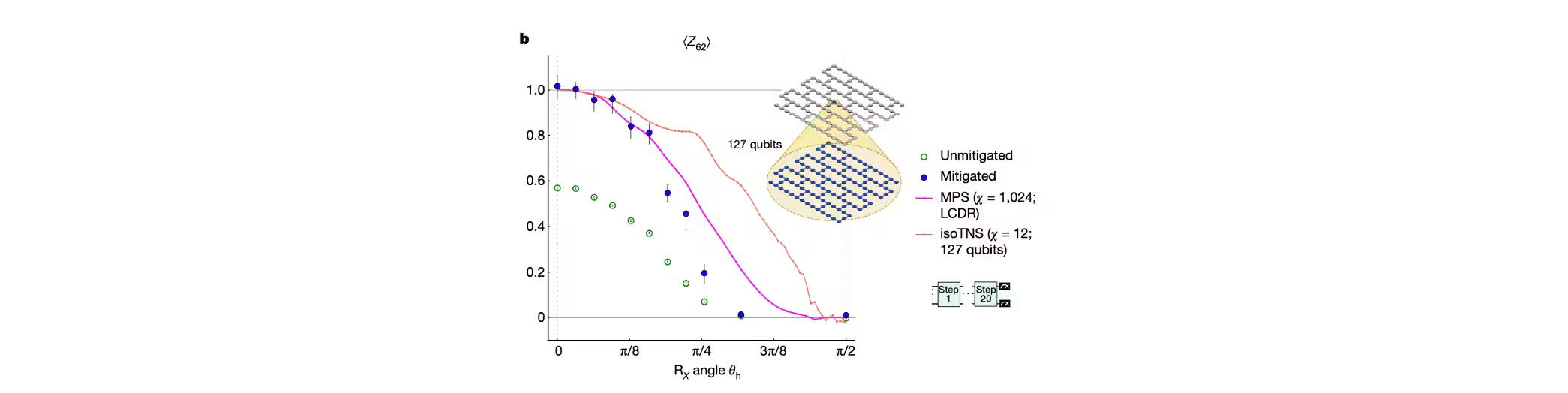

The novel contribution of the paper is that they built quantum circuits at a scale beyond statevector simulation, ran them on noisy quantum computers, and succeeded in extracting reliable results. That is, they demonstrated the utility of noisy quantum computers. In doing so, they applied zero-noise extrapolation (ZNE) with probabilistic error amplification (PEA) to mitigate errors from noisy devices.
From then on, we called such experiments and circuits "utility-scale".
1.1 Your goal
Your goal in this lesson is to build a utility-scale circuit and run it on an Eagle processor. It is beyond the scope of this notebook to extract reliable results, partly because PEA is an experimental feature of Qiskit at this time of writing and partly because applying ZNE with PEA will take a fair amount of time.
Concretely, you are asked to build and run the circuit corresponding to Figure 4b of the paper, and plot the "unmitigated" points of your own. As you see, it is a 127-qubit ×\times 60-layer (20 Trotter steps) circuit with the Z62\langle Z_{62} \rangle as an observable.
Sound like a big deal?   Don't worry. The last three lessons of this course provide stepping stones. To begin, we will demonstrate a smaller-scale experiment which is to build and run on a fake device a 27-qubit ×\times 6-layer (2 Trotter steps) circuit with the Z13\langle Z_{13} \rangle as an observable.

5. Solve the 127-qubit version of the problem
It is your goal to run the utility-scale experiment as mentioned at the beginning. You will create and execute a 127-qubit and 60-layer (20 Trotter steps) circuit with Z62\langle Z_{62} \rangle as an observable. We recommend you try to do this yourself, using the code for the 27-qubit version when appropriate. But the solution is provided here.
Solution:
5.1 Step 1: Map
# backend_map = service.backend("ibm_brisbane")
backend_map = service.least_busy(operational=True, simulator=False)
num_steps = 20
qc = get_utility_circuit(backend_map, num_steps)
obs = SparsePauliOp.from_sparse_list(
    [("Z", [62], 1)], num_qubits=backend_map.num_qubits
)  # Eagle
angles = [0, 0.1, 0.2, 0.3, 0.4, 0.5, 0.6, 0.7, 0.8, 1.0, np.pi / 2]

We provide the values for the "mitigated" points in Figure 4b of the utility paper. Plot these together with your results.
result_paper = [
    1.0171,
    1.0044,
    0.9563,
    0.9602,
    0.8394,
    0.8120,
    0.5466,
    0.4556,
    0.1953,
    0.0141,
    0.0117,
# REPLACE WITH YOUR OWN JOB ID
job = service.job(job_id)
plt.plot(angles, job.result()[0].data.evs, "o", label=f"{job.backend().name}")
plt.plot(angles, result_paper, "o", label="Utility Paper")
plt.xlabel("$\\mathrm{R_x}$ angle $\\theta_h$")
plt.title("$\\langle Z_{62} \\rangle$")
plt.legend()
plt.show()
Output:
Output of the previous code cell
Are your results similar to the "unmitigated" in Figure 4b?   They could be very different, depending on the device and its condition at the time of experiment. Do not worry about the results themselves. What we will check is whether you have done the coding correctly. If you have done so, congratulations, you have reached the starting line of the utility era.
As in the Utility paper, scientists across the globe have put forth tremendous ingenuity to extracting meaningful results even in the presence of noise. The end goal of this collective effort is quantum advantage: a state in which quantum computers can solve some problems of use in industry faster, with higher fidelity, or more cheaply than classical computers. This is not likely to be a single event, but rather an era in which classical reproduction of quantum results takes progressively longer, until at some point that quantum lead time becomes critically important. One thing is clear about quantum advantage: we get there only through the utility-scale experiments. If this course results in your joining the quest, which is full of challenge and fun, we would be more than happy.
