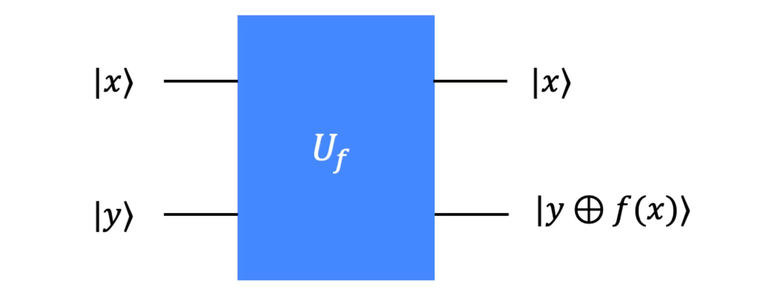

We'd like to find out which of these functions (1-4) our f(x)f(x) is. Classically, we would need to run the function twice — once for x=0x=0, once for x=1x=1. But let's see if we can do better with a quantum circuit. We can learn about the function with the following gate:
quantum_parallelism
Here, the UfU_f gate computes f(x)f(x), where xx is the state of qubit 0, and applies that to qubit 1. So, the resulting state, xyf(x)|x\rangle|y\oplus f(x)\rangle, simply becomes xf(x)|x\rangle|f(x)\rangle when y=0|y\rangle = |0\rangle. This contains all the information we need to know the function f(x)f(x): qubit 0 tells us what xx is, and qubit 1 tells us what f(x)f(x) is. So, if we initialize x=12(0+1)|x\rangle = \frac{1}{\sqrt{2}}(|0\rangle+|1\rangle), then the final state of both qubits will be: yx=12(f(0)0+f(1)1)|y\rangle|x\rangle = \frac{1}{\sqrt{2}}(|f(0)\rangle|0\rangle+|f(1)\rangle|1\rangle). But how do we access that information?

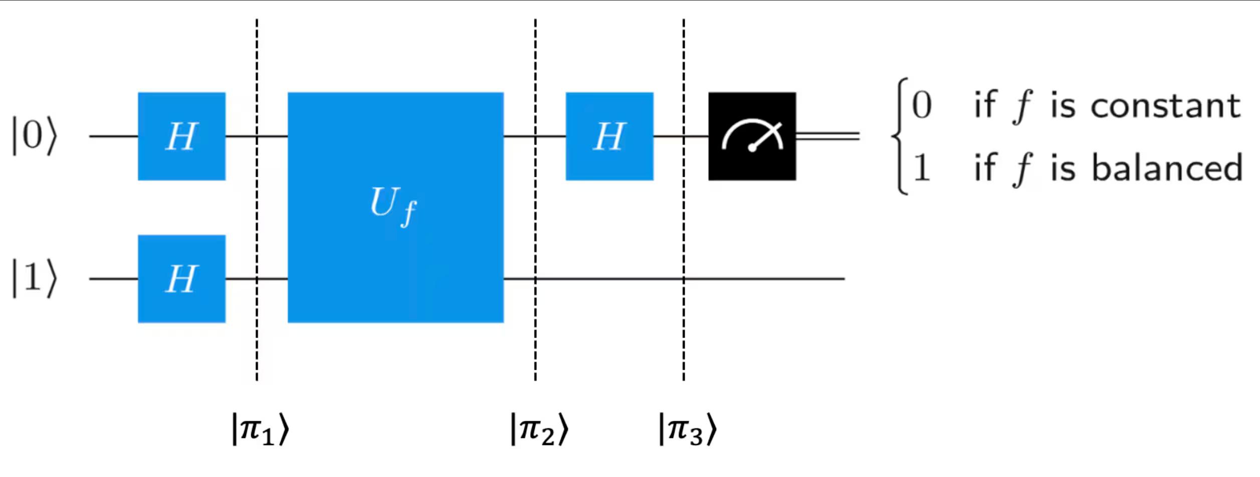

Here's a circuit diagram of Deutsch's algorithm:
Circuit diagram of Deutsch's algorithm
To understand how this algorithm works, let's look at the quantum states of the qubits at the three points noted on the diagram above. Try to work out the states for yourself before clicking to view the answers:
Check your understanding
What is the state π1|\pi_1\rangle?
  • Applying a Hadamard transforms the state 0|0\rangle to 12(0+1)\frac{1}{\sqrt{2}}(|0\rangle+|1\rangle) and the state 1|1\rangle to 12(01)\frac{1}{\sqrt{2}}(|0\rangle-|1\rangle). So, the full state becomes: π1=[012][0+12]|\pi_1\rangle = [\frac{|0\rangle-|1\rangle}{\sqrt{2}}][\frac{|0\rangle+|1\rangle}{\sqrt{2}}]
What is the state π2|\pi_2\rangle?
  • Before we apply UfU_f, remember what it does. It will change the state of qubit 1 based on the state of qubit 0. So, it makes sense to factor the state of qubit 0 out: π1=12(01)0+12(01)1|\pi_1\rangle = \frac{1}{2} (|0\rangle-|1\rangle)|0\rangle+\frac{1}{2}(|0\rangle-|1\rangle)|1\rangle. Then, if f(0)=f(1)f(0)=f(1), the two terms will transform in the same way and the relative sign between the two terms remains positive, but if f(0)f(1)f(0)\neq f(1), then that means the second term will pick up a minus sign relative to the first term, changing the state of qubit 0 from 12(0+1)\frac{1}{\sqrt{2}}(|0\rangle+|1\rangle) to 12(01)\frac{1}{\sqrt{2}}(|0\rangle-|1\rangle). So:
    π2={±[012][0+12]iff(0)=f(1)±[012][012]iff(0)f(1)|\pi_2\rangle = \begin{cases} \pm[\frac{|0\rangle-|1\rangle}{\sqrt{2}}][\frac{|0\rangle+|1\rangle}{\sqrt{2}}] & \text{if} & f(0) = f(1) \\ \pm[\frac{|0\rangle-|1\rangle}{\sqrt{2}}][\frac{|0\rangle-|1\rangle}{\sqrt{2}}] &\text{if} & f(0) \neq f(1) \\ \end{cases}
What is the state π3|\pi_3\rangle?
  • Now, the state of qubit 0 is either 12(0+1)\frac{1}{\sqrt{2}}(|0\rangle+|1\rangle) or 12(01)\frac{1}{\sqrt{2}}(|0\rangle-|1\rangle), depending on the function. Applying the Hadamard will yield either 0|0\rangle or 1|1\rangle, respectively.
    π3={±[012]0iff(0)=f(1)±[012]1iff(0)f(1)|\pi_3\rangle = \begin{cases} \pm[\frac{|0\rangle-|1\rangle}{\sqrt{2}}]|0\rangle & \text{if} & f(0) = f(1) \\ \pm[\frac{|0\rangle-|1\rangle}{\sqrt{2}}]|1\rangle &\text{if} & f(0) \neq f(1) \\ \end{cases}
Looking through your answers for the above questions, note that something a bit surprising happens. Although UfU_f does nothing explicitly to the state of qubit 0, because it changes qubit 1 based on the state of qubit 0, it can happen that this causes a phase shift in qubit 0. This is known as the "phase-kickback" phenomenon, and is discussed in more detail in Lesson 1: Quantum Query Algorithms of the Fundamentals of Quantum Algorithms course.
Now that we understand how this algorithm works, let's implement it with Qiskit.

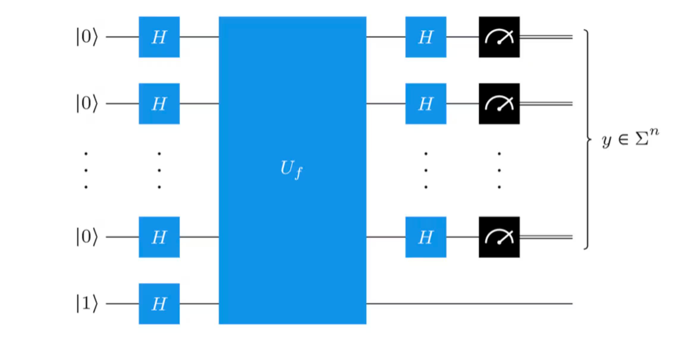

Deutsch's algorithm was an important first step in demonstrating how a quantum computer might be more efficient than a classical computer, but it was only a modest improvement: it required just one query, compared to two in the classical case. In 1992, Deutsch and his colleague, Richard Jozsa, extended the original two-qubit algorithm to more qubits. The problem remained the same: determine whether a function is balanced or constant. But this time, the function goes from nn bits to a single bit. Either the function returns 0 and 1 an equal number of times (it's balanced) or the function returns always 1 or always 0 (it's constant).
Here's a circuit diagram of the algorithm:
This algorithm works in the same way as Deutsch's algorithm: the phase-kickback allows one to read out the state of qubit 0 to determine whether the function is constant or balanced. It's a bit trickier to see than for the two-qubit Deutsch's algorithm case, since the states will include sums over the nn qubits, and so working out those states will be left as an optional exercise for you at the end of the module. The algorithm will return a bitstring of all 0's if the function is constant, and a bitstring containing at least one 1 if the function is balanced.
To see how the algorithm works in Qiskit, first, we need to generate our oracle: the random function that is guaranteed to be either constant or balanced. The code below will generate a balanced function 50% of the time, and a constant function 50% of the time. Don't worry if you don't entirely follow the code — it's complicated and not necessary for our understanding of the quantum algorithm.

The Bernstein - Vazirani problem
In 1997, Ethan Bernstein and Umesh Vazirani used the Deutsch-Jozsa algorithm to solve a more specific, restricted problem compared to the Deutsch-Jozsa problem. Rather than simply try to distinguish between two different classes of functions, as in the D-J case, Bernstein and Vazirani used the Deutsch-Jozsa algorithm to actually learn a string encoded in a function. Here's the problem:
The function f:{0,1}n{0,1}f:\{0,1\}^n \rightarrow \{0,1\} still takes an nn-bit string and outputs a single bit. But now, instead of promising that the function is balanced or constant, we're now promised that the function is the dot product between the input string xx and some secret nn-bit string ss, modulo 2. (This dot product modulo 2 is called the "binary dot product.") The problem is to figure out what the secret, nn-bit string is.
Written another way, we're given a black-box function f:0,1n0,1f: {0,1}^n \rightarrow {0,1} that satisfies f(x)=sxf(x) = s \cdot x for some string ss, and we want to learn the string ss.
Let's take a look at how the D-J algorithm solves this problem:
  1. First, a Hadamard gate is applied to the nn input qubits, and a NOT gate plus a Hadamard is applied to the output qubit, making the state:
Ψ=n+n1+n2...+0|\Psi\rangle = |-\rangle_{n} \otimes |+\rangle_{n-1} \otimes |+\rangle_{n-2} \otimes ... \otimes |+\rangle_0
The state of qubits 1 through nn can be written more simply as a sum over all 2n2^n the nn-qubit basis states 00...00,00...01,000...11,...,111...11|00...00\rangle, |00...01\rangle, |000...11\rangle, ..., |111...11\rangle. We call the set of these basis states Σn\Sigma^n. (See Fundamentals of Quantum Algorithms for more details.)
Ψ=12nxΣnx|\Psi\rangle = |-\rangle \otimes \frac{1}{\sqrt{2^n}}\sum\limits_{x \in \Sigma^n}{|x\rangle}
  1. Next, the UfU_f gate is applied to the qubits. This gate will take the first n qubits as input (which are now in an equal superposition of all possible n-bit strings) and applies the function f(x)=sxf(x)=s \cdot x to the output qubit, so that this qubit is now in the state: f(x) |- \oplus f(x)\rangle. Thanks to the phase kickback mechanism, the state of this qubit remains unchanged, but some of the terms in the input qubit state pick up a minus sign:
Ψ=12nxΣn(1)f(x)x|\Psi\rangle = |-\rangle \otimes \frac{1}{\sqrt{2^n}}\sum\limits_{x \in \Sigma^n}{(-1)^{f(x)}|x\rangle}
  1. Now, the next set of Hadamards are applied to qubits 0 through n1n-1. Keeping track of the minus signs in this case can be tricky. It's helpful to know that applying a layer of Hadamards to nn qubits in a standard basis state x|x\rangle can be written as:
Hnx=12nyΣn(1)xyyH^{\otimes n} |x\rangle = \frac{1}{\sqrt{2^n}}\sum\limits_{y \in \Sigma^n}{(-1)^{x \cdot y}|y\rangle}
So the state becomes:
Ψ=12nxΣnyΣn(1)(sx)+(xy)y|\Psi\rangle = |-\rangle \otimes \frac{1}{2^n}\sum\limits_{x \in \Sigma^n}\sum\limits_{y \in \Sigma^n}{(-1)^{(s \cdot x) + (x \cdot y)}|y\rangle}
  1. Next step is to measure the first nn bits. But what will we measure? It turns out that the state above simplifies to: Ψ=s|\Psi\rangle = |-\rangle \otimes |s\rangle, but that's far from obvious. If you'd like to follow through the math, see John Watrous' Fundamentals of Quantum Algorithms course. The point is, though, that the phase kickback mechanism leads to the input qubits being in the state s|s\rangle. So, to find out what the secret string ss was, you simply need to measure the qubits!
