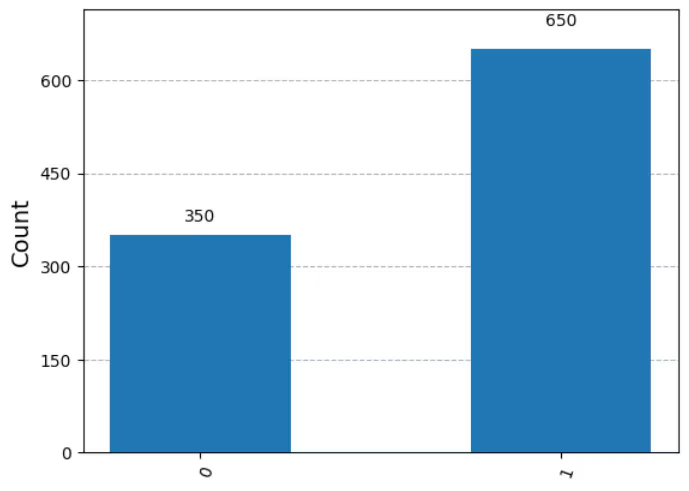

Introduction and background
Quantum teleportation is a technique in quantum physics that allows the transfer of quantum information from one location to another without physically moving particles. Unlike the sci-fi concept of teleportation, this process doesn't involve transporting matter. Instead, it relies on the principle of quantum entanglement, where two particles become linked regardless of distance. Through a series of precise measurements and classical communication, the quantum state of one particle can be recreated in another particle at a distant location, effectively "teleporting" the quantum information. In this module, we'll see how this works mathematically, and then we will implement quantum teleportation on a real quantum computer. The introduction here will be brief; for more background on quantum information, and more explanation about teleportation, we recommend John Watrous's course on the Basics of quantum information, and in particular the section on Teleportation.
Classical bits can be in states 0 or 1. Quantum bits (qubits) can be in quantum states denoted ∣0⟩|0\rangle and ∣1⟩|1\rangle and also linear combinations of these states, called "superpositions", such as ∣ψ⟩=α0∣0⟩+α1∣1⟩|\psi\rangle = \alpha_0|0\rangle +\alpha_1|1\rangle, with α0,α1∈C\alpha_0,\alpha_1 \in \mathbb{C}, and ∣α0∣2+∣α1∣2=1|\alpha_0|^2+|\alpha_1|^2 = 1. Although the states can exist in this superposition, a measurement of the state will "collapse" it into either the ∣0⟩|0\rangle or ∣1⟩|1\rangle states. The parameters aa and bb are related to the probability of each measurement outcome according to
P0=∣α0∣2P_0 = |\alpha_0|^2 P1=∣α1∣2P_1 = |\alpha_1|^2
Hence the constraint that ∣α0∣2+∣α1∣2=1|\alpha_0|^2+|\alpha_1|^2 = 1.
