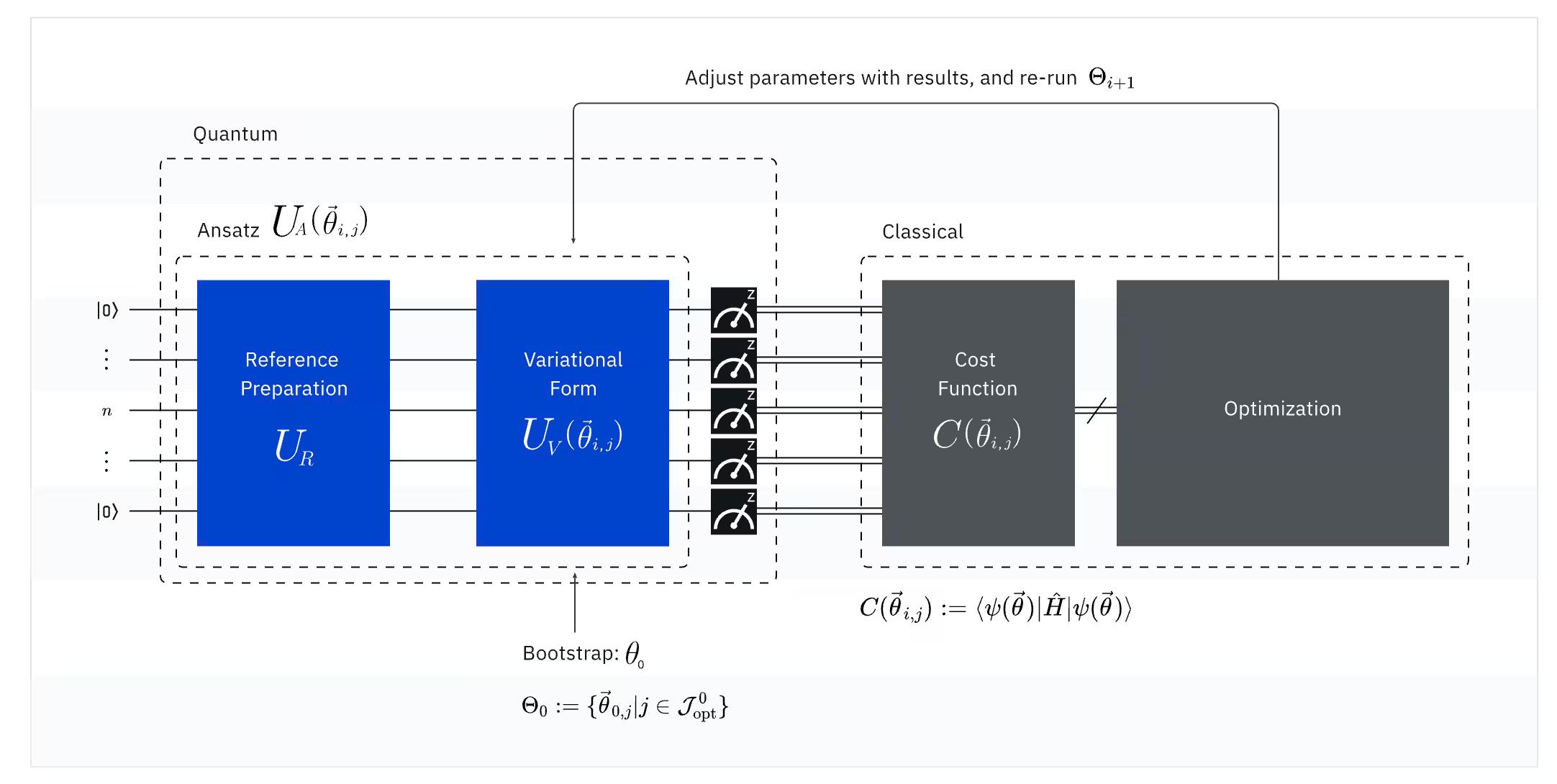

Now let's go back to VQE.
VQE combines the power of quantum computers with classical computers, fundamentally using variational principles to get the ground state energy of the system. To understand VQE, first break it down into three parts:
VQE workflow
(Quantum) Observable: The molecular Hamiltonian (energy of a molecule)
In VQE, the molecular/atomic Hamiltonian is an observable, meaning we can measure its value through an experiment. Our goal is to find the lowest possible energy (the ground state energy) of the molecule. To do this, we use a trial quantum state, generated by a parameterized quantum circuit (ansatz). We measure the observable and optimize the quantum state until we reach the lowest possible energy.
The basis set used for the molecular Hamiltonian determines the number of qubits required and directly affects the accuracy of VQE. Choosing the right basis set is critical for balancing efficiency and precision. To simplify calculations without changing the basis set, we can use strategies like imposing symmetry and active space reduction. Many molecules have symmetrical shapes (like a butterfly or snowflake), meaning some parts behave the same way. Instead of calculating everything separately, we can focus only on unique parts, saving quantum resources, thus leveraging symmetry. In active space reduction, we consider only the important orbitals, as not all electrons significantly impact molecular energy. Electrons close to the nucleus remain mostly unchanged, while others influence bonding. By applying these methods, we can make VQE more efficient while maintaining accuracy.
Once we obtain a molecular Hamiltonian using the proper basis set and strategies above, we need to transform this Hamiltonian into one suitable for quantum computers. Mapping problems to Pauli operators can be quite complicated. This is especially true in quantum chemistry, which works with indistinguishable particles (electrons), since qubits are distinguishable. We will not go into the details of the mappings here, but we refer you to the following resources. A general discussion of mapping a problem to quantum operators can be found in Quantum computing in practice. A more detailed discussion on mapping chemistry problems into quantum operators can be found in Quantum chemistry with VQE.
For this module, we will provide you with the appropriate (one-qubit) Hamiltonians for HH and H2H_2 so we can focus on using the quantum computer. These one-qubit Hamiltonians are prepared by using the STO-6G basis set and the Jordan-Wigner mapping, which is the most straightforward mapping with the simplest physical interpretation, because it maps the occupation of one spin-orbital to the occupation of one qubit. Also, we used a qubit reduction technique by using a symmetry of the Hamiltonian, which uses the patterns in how spin occupations behave to reduce the number of qubits. For the H2H_2 molecule, we assume the distance between the two hydrogen atoms is 0.735 A˚\mathring A.
(Quantum) Ansatz: The trial wave function (How to build a trivial quantum state with a quantum circuit)
For VQE, the ansatz (plural: ansätze) consists of two key components. The first is initial state preparation, which sets up the qubit's state by applying quantum gates with no variational parameter. The second component is the parameterized quantum circuit, a special quantum circuit with adjustable parameters, similar to dials on a radio. These parameters will be used for the last part — the classical optimizer — to help us reach the best possible ground state.
In the variational principle section, we learned that the quality of the trial state affects the quality of the results of the variational algorithm. This means that choosing a good ansatz is important in VQE. Once again, this is a rich and complex topic. We will not cover the different types of ansatz or their origins here. If you're interested in learning more about parameterized quantum circuits and ansatz, you can explore the Ansatz and variational form lesson from the Variational algorithm design course, which provides detailed explanations and examples of ansätze.
Since we are going to use a one-qubit Hamiltonian in this module, we need a one-qubit parameterized quantum circuit as an ansatz. We will see three types of one-qubit ansätze in the following section. We will compare them and discuss key considerations in selecting an ansatz.
(Classical) Optimizer: fine-tuning the quantum circuit
Once the quantum computer measures the energy of the observable from the ansatz, the parameters of the ansatz and the energy value are sent to the classical optimizer for tuning. This optimization process is performed on a classical computer, typically using general-purpose scientific packages like SciPy.
The classical optimizer treats the measured energy as a cost function. In optimization problems, a cost function (also sometimes called an objective function) is a mathematical function that measures how "good" a particular solution is. The goal of the optimizer is to find the set of parameters that minimizes this cost function. In the context of finding the ground state energy of a molecule, the energy itself serves as the cost function – we want to find the parameters for our quantum circuit (our "solution") that yield the lowest possible energy. The classical optimizer uses this measured energy value (the cost) and determines the next set of optimized parameters for the quantum ansatz. These updated parameters are then sent back to the quantum circuit, and the process is repeated. With each iteration, the classical optimizer adjusts the parameters to try and reduce the energy (minimize the cost function) until a predefined convergence criterion is met, ideally ensuring that the lowest possible energy (corresponding to the ground state of the molecule for that bond distance and basis set) is found.
There are many optimization strategies provided by scientific packages like SciPy. You can find more in the Optimization loops lesson of the Variational algorithm design course. Here we will use COBYLA (Constrained Optimization BY Linear Approximations), an optimization algorithm suitable for complicated energy landscapes. In particular, COBYLA does not attempt to calculate a gradient of the function being studied; this is called a gradient-free optimizer. Imagine you are trying to find the highest peak in a mountain range with your eyes closed. Since you can’t see the whole landscape, you take small steps in different directions, while checking if you’re going up or down. COBYLA works in a similar way — it moves through the parameter space, testing different values, gradually improving the result until it finds the best one.
