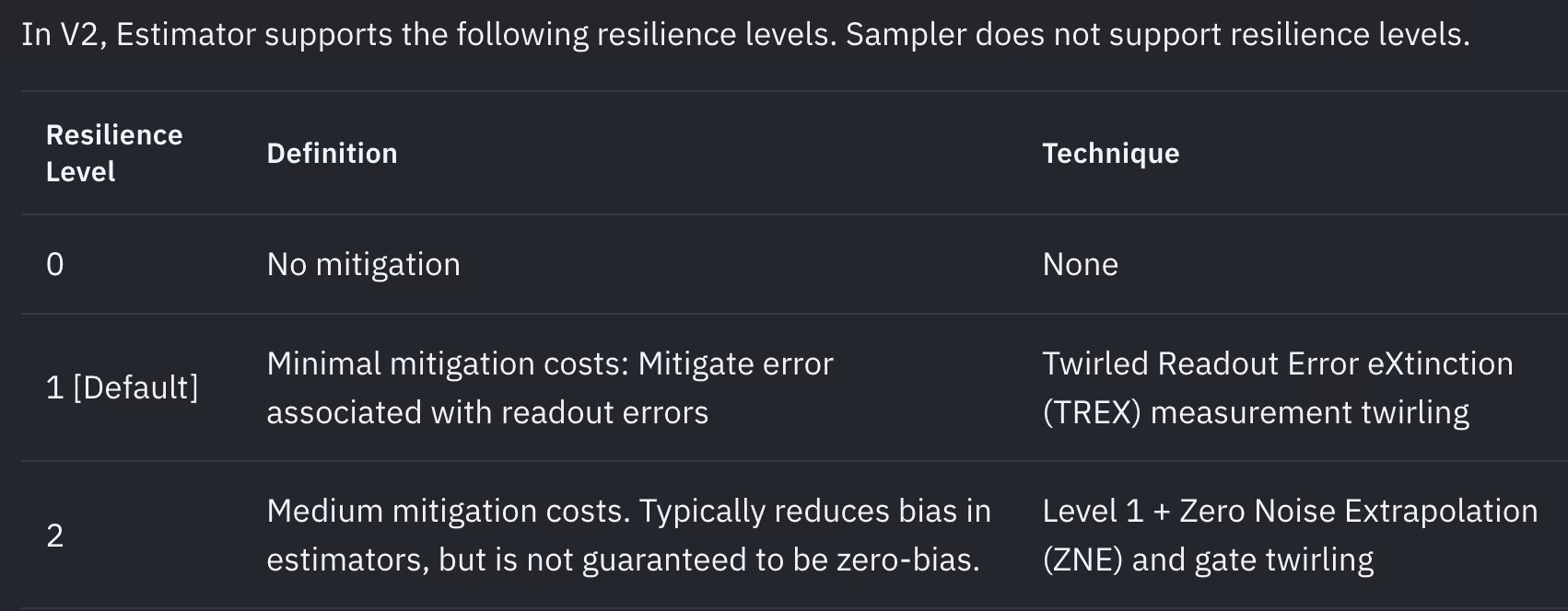

3.3 Execute using Estimator (with different resilience levels)
Setting the resilienece level (estimator.options.resilience_level) is the easiest way to apply error mitigation when using Qiskit Estimator. Estimator supports the following resilience levels (as of 2024/06/28). See more details in the Configure error mitigation guide.

labels = ["0 (No mitigation)", "1 (TREX)", "2 (ZNE + Gate twirling)"]

4. (Optional) Customize error mitigation options
We can customize the application of error mitigation techniques via options as shown below.
# TREX
estimator.options.twirling.enable_measure = True
estimator.options.twirling.num_randomizations = "auto"
estimator.options.twirling.shots_per_randomization = "auto"
# Gate twirling
estimator.options.twirling.enable_gates = True
# ZNE
estimator.options.resilience.zne_mitigation = True
estimator.options.resilience.zne.noise_factors = [1, 3, 5]
estimator.options.resilience.zne.extrapolator = ("exponential", "linear")
# Dynamical decoupling
estimator.options.dynamical_decoupling.enable = True  # Default: False
estimator.options.dynamical_decoupling.sequence_type = "XX"
# Other options
estimator.options.default_shots = 10_000
See the following guides and API reference for the details of error mitigation options.
