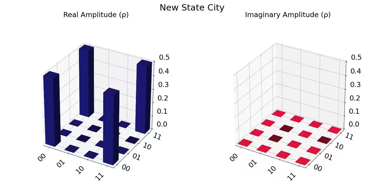

# You can choose different colors for the real and imaginary parts of the density matrix.
from qiskit.quantum_info import DensityMatrix
from qiskit.visualization import plot_state_city
qc = QuantumCircuit(2)
qc.h(0)
qc.cx(0, 1)
state = DensityMatrix(qc)
plot_state_city(state, color=['midnightblue', 'crimson'], title="New State City")

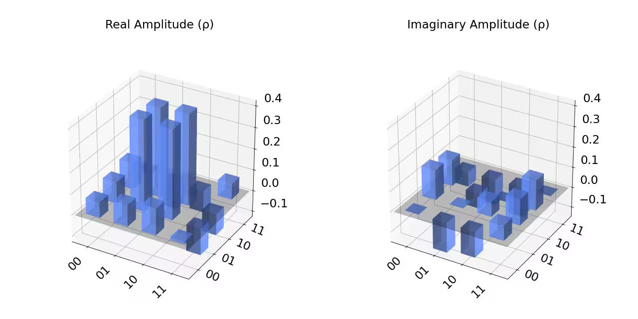

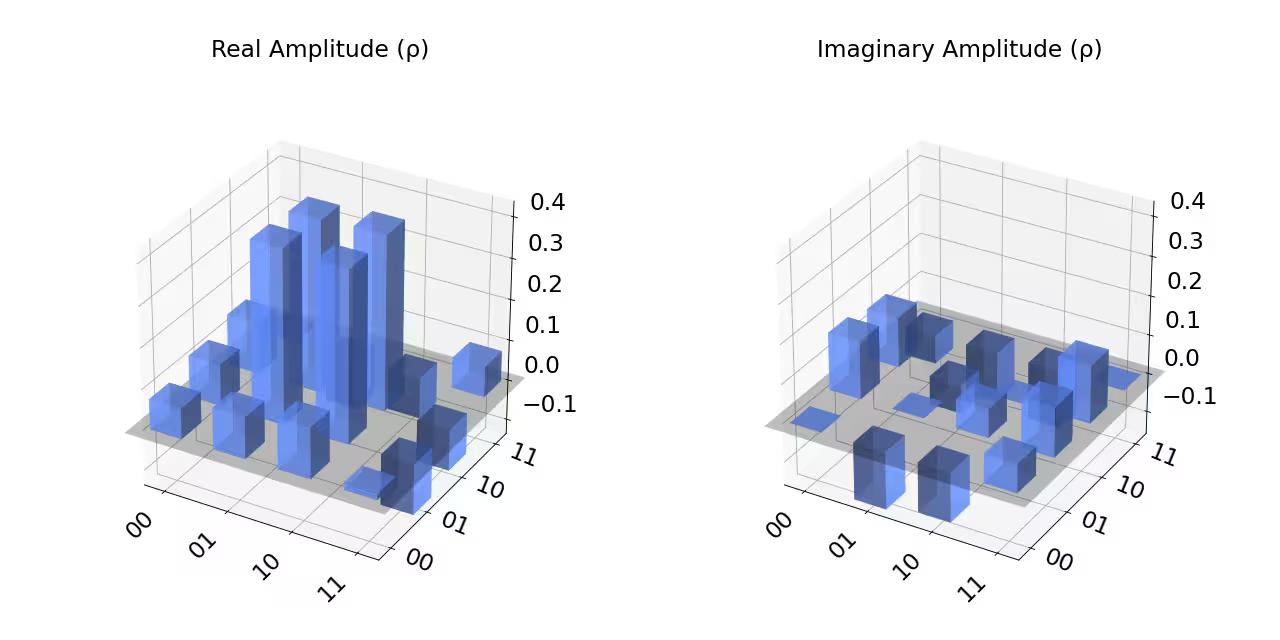

# You can make the bars more transparent to better see the ones that are behind
# if they overlap.
import numpy as np
from qiskit.quantum_info import Statevector
qc.h(0)
qc.cx(0, 1)
qc.h([0, 1])
qc.cz(0,1)
qc.ry(np.pi/3, 0)
qc.rx(np.pi/5, 1)
state = Statevector(qc)
plot_state_city(state, alpha=0.6)
