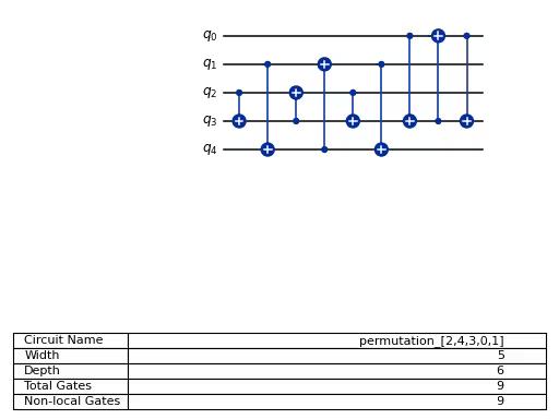

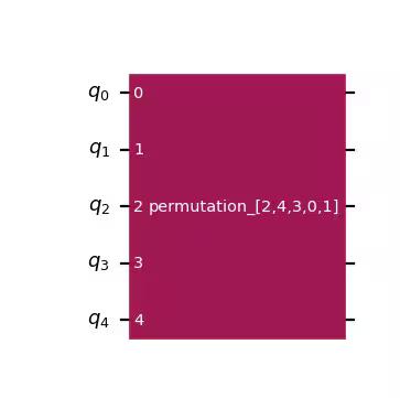

../_images/qiskit-circuit-library-Permutation-1.png
Expanded Circuit:
../_images/qiskit-circuit-library-Permutation-2.png
