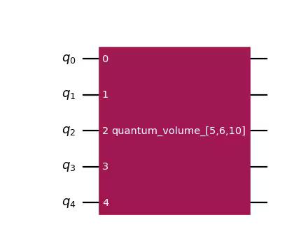

Reference Circuit:
../_images/qiskit-circuit-library-QuantumVolume-1.png

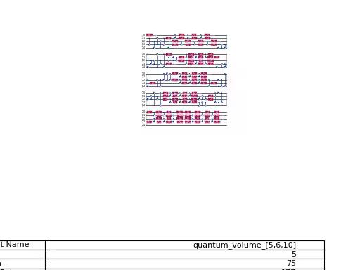

Expanded Circuit:
../_images/qiskit-circuit-library-QuantumVolume-2.png
References:
[1] A. Cross et al. Validating quantum computers using randomized model circuits, Phys. Rev. A 100, 032328 (2019). [arXiv:1811.12926]

  • flatten (bool) – If False (the default), construct a circuit that contains a single instruction, which in turn has the actual volume structure. If True, construct the volume structure directly.
