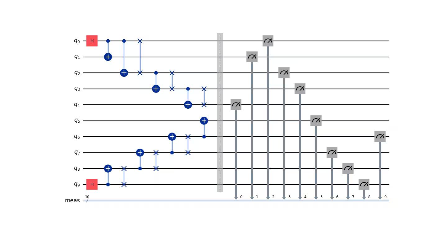

Run star to linear pre-routing
This pass is a logical optimization pass that rewrites any solely 2q gate star connectivity subcircuit as a linear connectivity equivalent with swaps.
For example:
from qiskit.transpiler.passes import StarPreRouting
qc = QuantumCircuit(10)
qc.h(0)
qc.cx(0, range(1, 5))
qc.h(9)
qc.cx(9, range(8, 4, -1))
qc.measure_all()
StarPreRouting()(qc).draw("mpl")
../_images/qiskit-transpiler-passes-StarPreRouting-1.png
This pass was inspired by a similar pass described in Section IV of: C. Campbell et al., “Superstaq: Deep Optimization of Quantum Programs,” 2023 IEEE International Conference on Quantum Computing and Engineering (QCE), Bellevue, WA, USA, 2023, pp. 1020-1032, doi: 10.1109/QCE57702.2023.00116.
