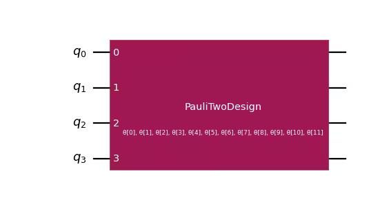

from qiskit.circuit.library import PauliTwoDesign
circuit = PauliTwoDesign(4, reps=2, seed=5, insert_barriers=True)
circuit.draw('mpl')
../_images/qiskit-circuit-library-PauliTwoDesign-1.png
