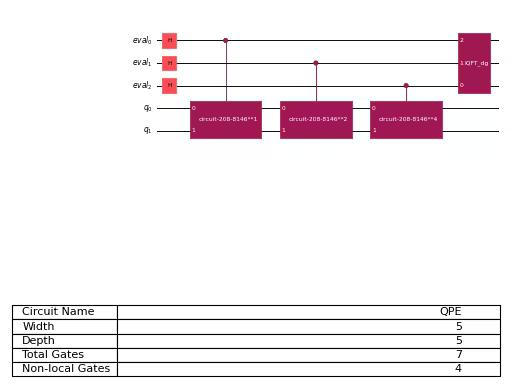

  • num_evaluation_qubits (int) – The number of evaluation qubits.
  • unitary (QuantumCircuit) – The unitary operation UU which will be repeated and controlled.
  • iqft (QuantumCircuit | None) – A inverse Quantum Fourier Transform, per default the inverse of QFT is used. Note that the QFT should not include the usual swaps!
  • name (str) – The name of the circuit.
Note
The inverse QFT should not include a swap of the qubit order.
Reference Circuit:
../_images/qiskit-circuit-library-PhaseEstimation-1.png
