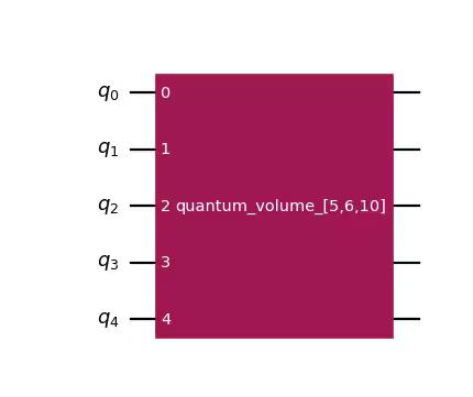

Reference Circuit:
../_images/qiskit-circuit-library-QuantumVolume-1.png

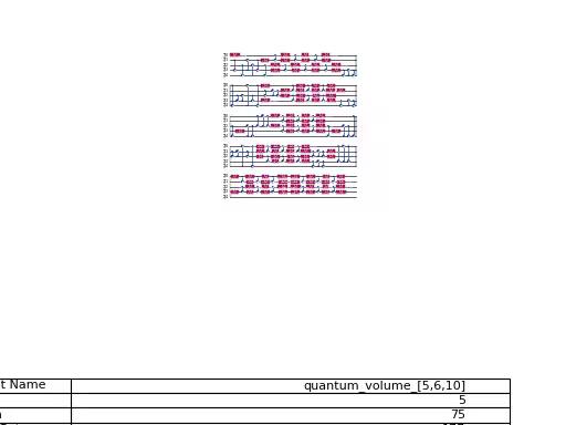

Expanded Circuit:
../_images/qiskit-circuit-library-QuantumVolume-2.png
