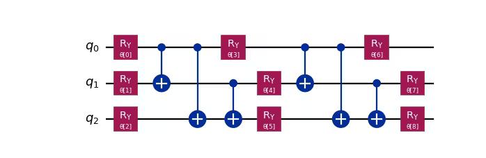

from qiskit.circuit.library import real_amplitudes
ansatz = real_amplitudes(3, reps=2)  # create the circuit on 3 qubits
ansatz.draw("mpl")
Circuit diagram output by the previous code.

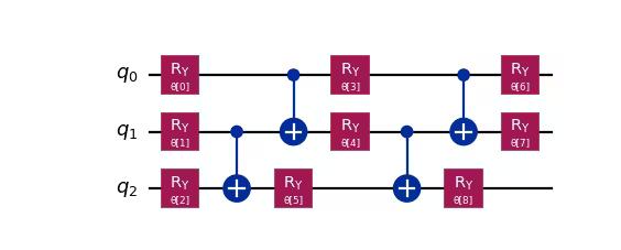

ansatz = real_amplitudes(3, entanglement="full", reps=2)  # it is the same unitary as above
ansatz.draw("mpl")

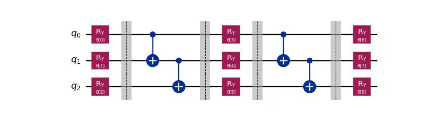

ansatz = real_amplitudes(3, entanglement="linear", reps=2, insert_barriers=True)
ansatz.draw("mpl")
