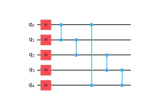

Reference Circuit:
from qiskit.circuit.library import GraphStateGate
import rustworkx as rx
G = rx.generators.cycle_graph(5)
circuit = QuantumCircuit(5)
circuit.append(GraphStateGate(rx.adjacency_matrix(G)), [0, 1, 2, 3, 4])
circuit.decompose().draw('mpl')
Circuit diagram output by the previous code.
