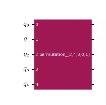

  • pattern (list[int] | np.ndarray | None) – permutation pattern, describing which qubits occupy the positions 0, 1, 2, etc. after applying the permutation, that is pattern[k] = m when the permutation maps qubit m to position k. As an example, the pattern [2, 4, 3, 0, 1] means that qubit 2 goes to position 0, qubit 4 goes to the position 1, etc. The pattern can also be None, in which case a random permutation over num_qubits is created.
  • seed (int | None) – random seed in case a random permutation is requested.
Raises
CircuitError – if permutation pattern is malformed.
Reference Circuit:
Diagram illustrating the previously described circuit.

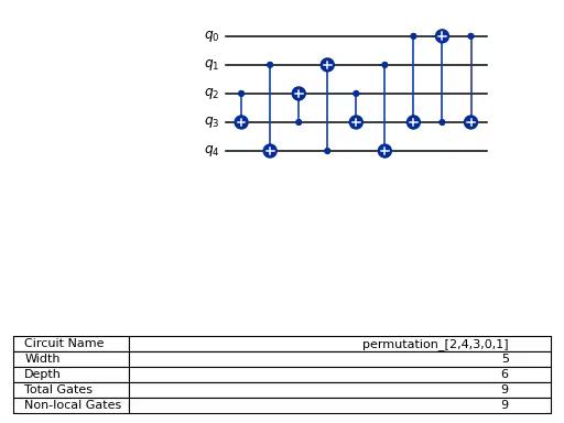

Expanded Circuit:
