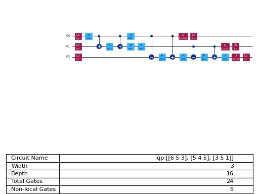

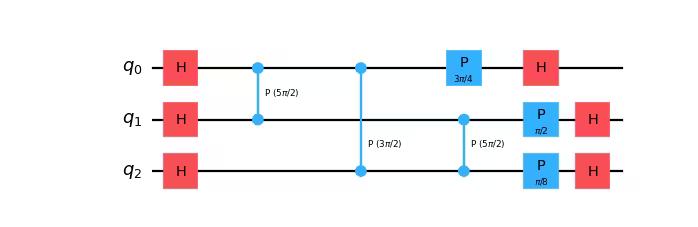

Reference Circuit:
Diagram illustrating the previously described circuit.
Expanded Circuit:
