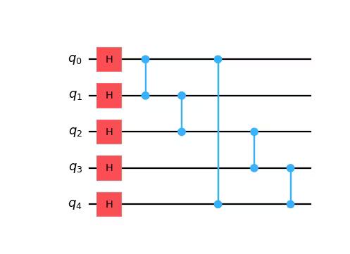

A gate representing a graph state.
Given a graph G = (V, E), with the set of vertices V and the set of edges E, the corresponding graph state is defined as
G=(a,b)ECZ(a,b)+V|G\rangle = \prod_{(a,b) \in E} CZ_{(a,b)} {|+\rangle}^{\otimes V}
Such a state can be prepared by first preparing all qubits in the ++ state, then applying a CZCZ gate for each corresponding graph edge.
Graph state preparation circuits are Clifford circuits, and thus easy to simulate classically. However, by adding a layer of measurements in a product basis at the end, there is evidence that the circuit becomes hard to simulate [2].
Reference Circuit:
from qiskit.circuit.library import GraphStateGate
import rustworkx as rx
G = rx.generators.cycle_graph(5)
circuit = QuantumCircuit(5)
circuit.append(GraphStateGate(rx.adjacency_matrix(G)), [0, 1, 2, 3, 4])
circuit.decompose().draw('mpl')
Circuit diagram output by the previous code.
