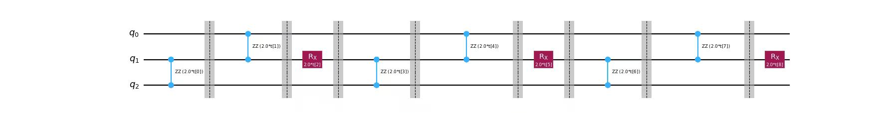

ops = [Pauli("ZZI"), Pauli("IZZ"), Pauli("IXI")]
ansatz = evolved_operator_ansatz(ops, reps=3, insert_barriers=True)
ansatz.draw("mpl")
Circuit diagram output by the previous code.
