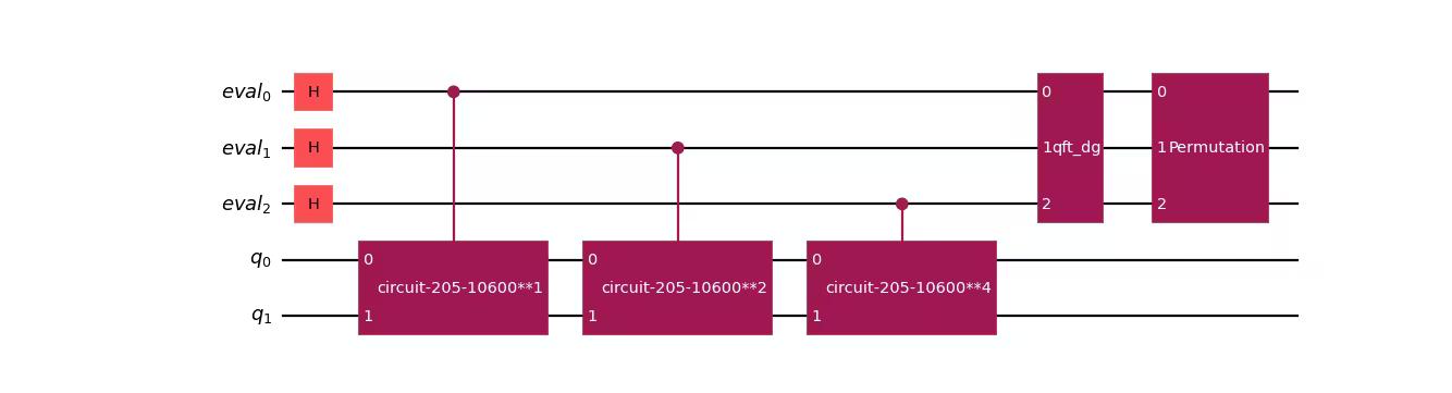

Reference Circuit:
from qiskit.circuit.library import phase_estimation
unitary = QuantumCircuit(2)
unitary.x(0)
unitary.y(1)
circuit = phase_estimation(3, unitary)
circuit.draw('mpl')
Circuit diagram output by the previous code.
