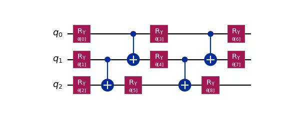

from qiskit.circuit.library import real_amplitudes
ansatz = real_amplitudes(3, reps=2)  # create the circuit on 3 qubits
ansatz.draw("mpl")

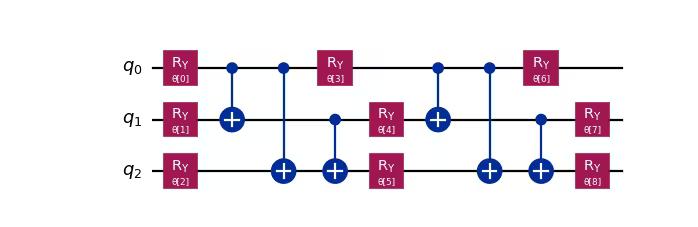

ansatz = real_amplitudes(3, entanglement="full", reps=2)  # it is the same unitary as above
ansatz.draw("mpl")

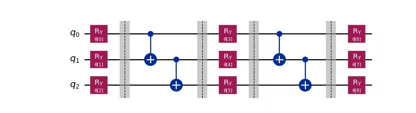

ansatz = real_amplitudes(3, entanglement="linear", reps=2, insert_barriers=True)
ansatz.draw("mpl")

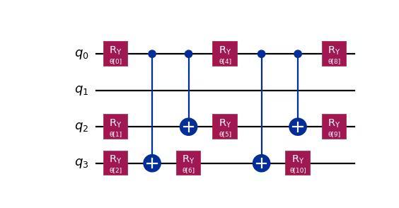

ansatz = real_amplitudes(4, reps=2, entanglement=[[0,3], [0,2]], skip_unentangled_qubits=True)
ansatz.draw("mpl")
