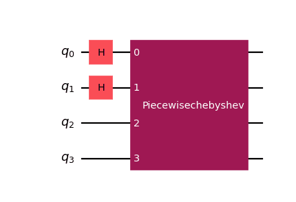

Piecewise Chebyshev approximation to an input function.
For a given function f(x)f(x) and degree dd, this class implements a piecewise polynomial Chebyshev approximation on nn qubits to f(x)f(x) on the given intervals. All the polynomials in the approximation are of degree dd.
The values of the parameters are calculated according to [1] and see [2] for a more detailed explanation of the circuit construction and how it acts on the qubits.
Examples
import numpy as np
from qiskit.circuit.library.arithmetic import PiecewiseChebyshevGate
f_x, num_state_qubits, degree, breakpoints = lambda x: np.arcsin(1 / x), 2, 2, [2, 4]
pw_approximation = PiecewiseChebyshevGate(f_x, num_state_qubits, degree, breakpoints)
qc = QuantumCircuit(pw_approximation.num_qubits)
qc.h(list(range(num_state_qubits)))
qc.append(pw_approximation, qc.qubits)
qc.draw(output="mpl")
Example of generating a circuit with the piecewise Chebyshev gate.
